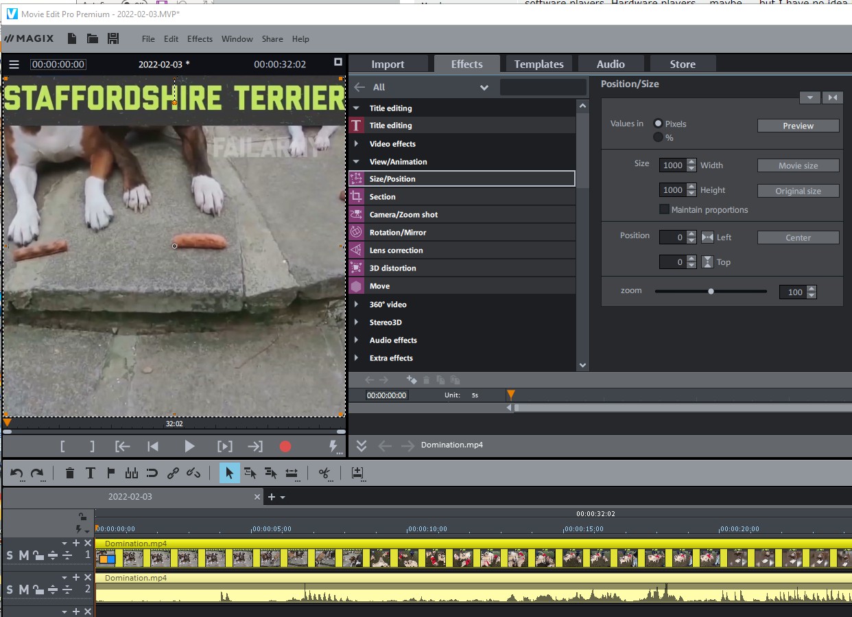

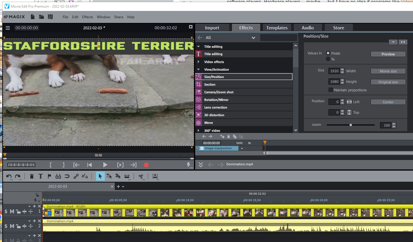

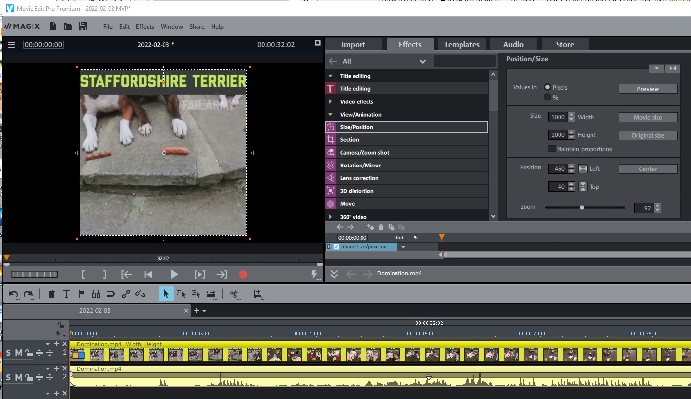

    Actually, a video edit program that can also custom change the AR of the input file in the output render would be just great - but not sure if that's possible in affordable home software.
    Movie Edit Pro will do this. You can set any custom resolution for the movie settings and stretch/squash any video to the "proper" AR, then export to MP4.
    1920x1080 Movie:
    [Attachment 63163 - Click to enlarge]
    Video stretched:
    [Attachment 63164 - Click to enlarge]
    1000x1000 movie:
    [Attachment 63165 - Click to enlarge]
    There is a trial and helpful forum.
