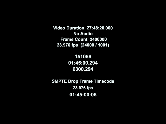

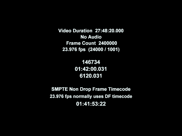

    [Attachment 62786 - Click to enlarge]
    [Attachment 62787 - Click to enlarge]
    PS If you happen to be an Avisynth user, the screenshots above came from this little script. A link to the Position function is in my signature.

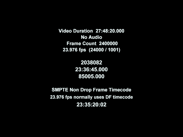

    [Attachment 62790 - Click to enlarge]
    Forcing a frame rate for Handbrake shouldn't change anything. If the video happened to be 30fps and you told it to output 60fps, it'd simply duplicate every frame to double the frame rate, but if something happens at a particular time in the video that won't change. Changing the frame rate in Handbrake will cause it to add and/or drop frames as required to output the specified frame rate but the video duration won't be any different so your times still won't match and you'll just have a video with a different number of frames than before.
