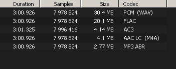

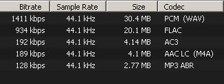

    A quick example of the same CD audio track encoded at different bitrates and their corresponding file sizes.
    The first two are both 16 bit, while the others are in a lossy format and therefore have no bit depth.
    [Attachment 62750 - Click to enlarge]

  16. Three minutes.
    The AC3 version has a slightly longer duration than the others as the AC3 encoder doesn't support gapless playback. Lossy encoders generally add a little silence to the beginning and the end of the audio and the gapless information tells a decoder to skip it. I assume it's referred to as gapless playback as it means you can encode tracks individually that normally run into each other on an album without any silence in between. When you play the encoded tracks, the player can still play them one after the other as a continuous track because it knows to skip the added silence.
    So the AAC and MP3 versions show the same number of samples as the original audio, whereas for the AC3 version some extra silent samples are included.

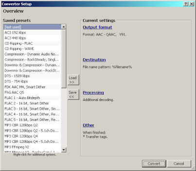

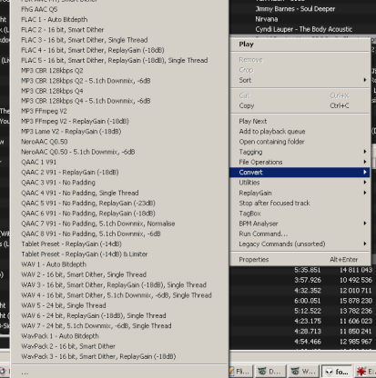

    [Attachment 62754 - Click to enlarge]
    At the bottom of the converter presets list you'll see three dots. Clicking on the three dots takes you into the converter setup. There you can click on Output Format to choose an encoder configuration, or create your own, and under processing you'll see the DSPs that can be used when re-encoding.
    Anyway, play around if you want to, and post back if you need any help.

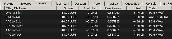

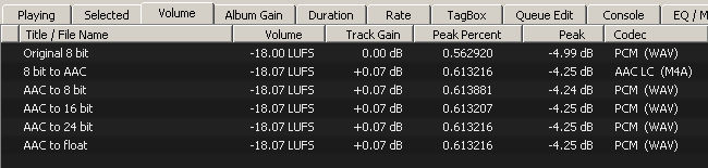

  28. Originally Posted by Cornucopia View Post
    While the app may get to "choose" the bit depth, its original bitdepth is still an intrinsic limiting factor. IOW, you cannot get back more real detail, dynamic range than what you put in.
    Apps normally decode to 32 bit float because of it's precision, and because it can handle values above 0dB. The peaks might ultimately be clipped during any final conversion to a fixed bitdepth, but that aside, Apps tend to give you an opportunely to simply adjust the volume while re-encoding, or run the audio through DSPs, all of which should be done in float or at the highest bitdepth possible.
    And lossy encoding changes the audio, so from that perspective the lossy version is a new source. Decoding it to a higher bitdepth will have less quantisation errors than decoding it to a lower one, so it reproduces the lossy version more accurately even if it doesn't add back detail or dynamic range as such.
    Here's an 8 bit wave file converted to AAC, then the AAC version converted to wave files at different bitdepths. According to a ReplayGain scan, it took decoding the AAC version to 24 bit to represent the new AAC peak exactly. No dithering was used.
    Sample peak
    [Attachment 62764 - Click to enlarge]
    True peak (4 x oversampling)
    [Attachment 62765 - Click to enlarge]
