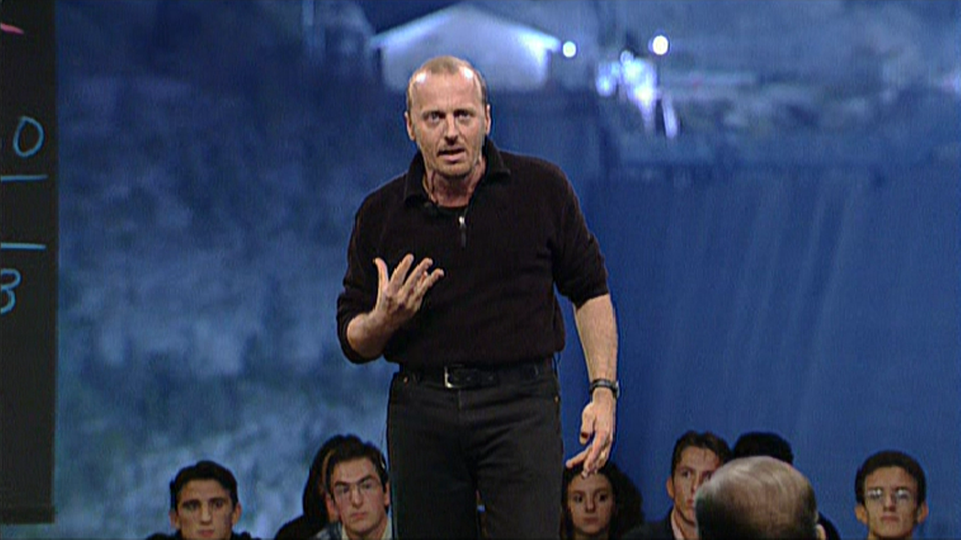

    sure, here is:
    https://www.dropbox.com/sh/epvle2iip8am9yi/AACx-Vbe1ayYsNTv8A3VydVja?dl=0
    Jan 2016
    No, a picture grab from the video with the original resolution, You took snap shots of the program. Still cropping horizontally is totally wrong, You only need to crop vertically and resize accordigly to the new AR which I could calculate if you provided an original frame not the software window.
    Play the DVD in VLC or MPC-HC and go to menu and take a snapshot and post it here using the forum attachment tool, not a third party file host.

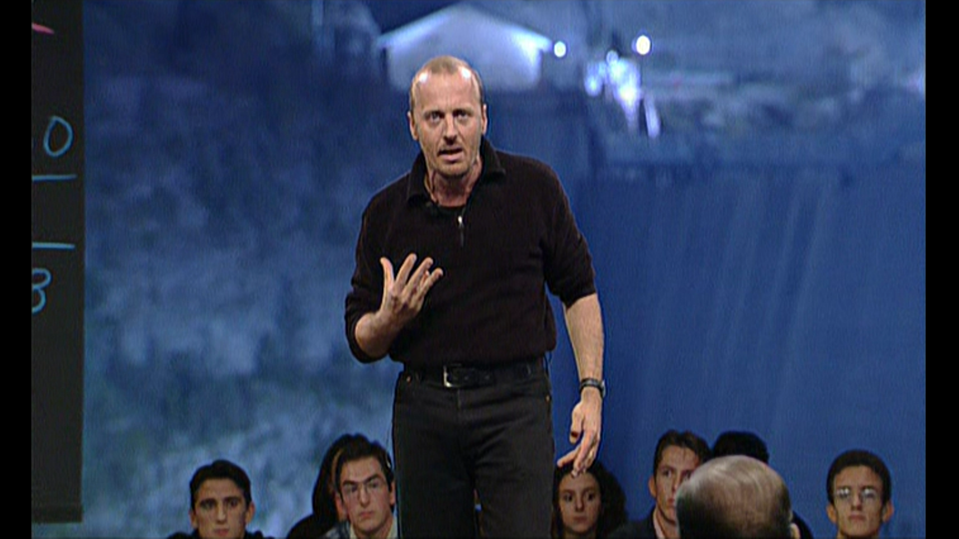

    the folder I've linked contains:
    - avsPmod ss - in order to show the crop line and the resultant res of 704x426
    - a DVD ss taken from MPC-HC whose res is 768x576
    - the same DVD ss manually cropped in order to show the expected resolution - 752x426
    - a ss from the encode file using SAR 16:15 - with a res of 750x426
    - added just now another avsPmod ss uncropped with 720x576 res

    Okay your active video area is roughly 706x426 assuming it is consistent through out the video, But the frame looks like it is squeezed horizontally a little bit judging by the human heads. But lets assume it is not for now, so your frame in a 16:9 aspect ratio will have black pillars added on both sides of approximatly 52 pixels each, then resize to 1920x1080 to get a legal resolution, If your frame is indeed squeezed then resizing without adding black pillars will get you a perfect 16:9 frame:
Name:	1920-1080 Resize.png
Name:	Resize 2 1920-1080.png

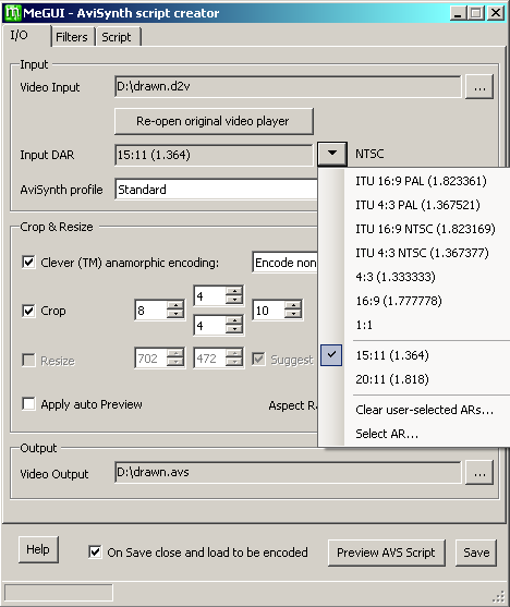

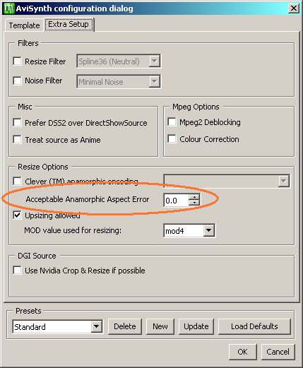

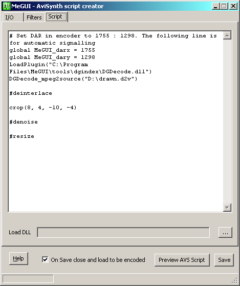

  18. maudit,
    Have you used MeGUI's anamorphic encoding? There's a few different choices. Most don't resize, so the SAR won't change (aside from the aspect error option I described below). One or two will adjust the cropping to ensure a certain mod.
    One anamorphic option can resize, so you can crop just what you need to, resize to the nearest Mod4 or Mod16 dimensions if required, and MeGUI will adjust the SAR to compensate.
    When anamorphic encoding is enabled, MeGUI adds the DAR to the top of the script (you can see it using the AVS Script Creator). Naturally the DAR will change if you crop. MeGUI then calculates the new SAR (if necessary) based on the DAR in the script and the cropped resolution. It'll add the SAR to the command line for you, as long as "Force SAR" is set to "default" in the encoder configuration. Once you save the script, you can open it again in the preview. The DAR is shown at the bottom, and checking "preview DAR" will resize the preview to square pixel dimensions. Changing the DAR at the bottom of the preview over-rides the DAR in the script, so that's something to be aware of.
    MeGUI still uses the old ITU DARs, or an exact 4:3 or 16:9 DAR. I'd recommend creating two custom DARs to use instead of the ITU DARs. 15:11 and 20:11, and I'd also recommend always using 15:11 for 4:3 DVDs. 16:9 DVDs are generally 16:9, unless they're old, in which case they might be 20:11. That applies to both PAL and NTSC.
    By default, MeGUI can fudge the DAR a little. It allows for an exact 4:3 or 16:9 output DAR when the cropping is very close to 4:3 or 16:9. You can disable the DAR fudging in the AVS Profile configuration.
    If you don't resize (only crop), setting 4:3 for the Input DAR for a PAL DVD will result in a 16:11 SAR. Setting 15:11 for the Input DAR will give you the 12:11 SAR jagabo mentioned earlier.
    [Attachment 62665 - Click to enlarge]
    [Attachment 62666 - Click to enlarge]
    [Attachment 62667 - Click to enlarge]

  20. Originally Posted by maudit View Post
    hi hello_hello, thanks for answering.
    I've read your message and even if I didn't fully understand it, I tried many times, with several different options combinations,
    but I always get a SAR which differs a lot from the almost correct 16:15 ratio, such as 128:71, 1412:781 or 5648:3195 that produce an oblong video.
    Those numbers are correct, but they're the display aspect ratio, not the sample aspect ratio. And MeGUI doesn't display the video with the correct DAR in the preview when using anamorphic encoding. It just uses the video dimensions, so don't worry about that. The preview with the correct DAR comes later....
    Without any cropping, for anamorphic encoding MeGUI should add 4:3 or 15:11 to the top of the script, depending on which you choose as the Input DAR, then as you crop the numbers change because cropping changes the display aspect ratio. It doesn't change the sample aspect ratio (resizing changes that).
    The display aspect ratio is the aspect ratio of the picture, the sample aspect ratio is the shape of the individual pixels. If you know the display aspect ratio you can calculate the sample aspect ratio using the video dimensions, or you can calculate the display aspect ratio from the sample aspect ratio (sorry if I'm stating the obvious).

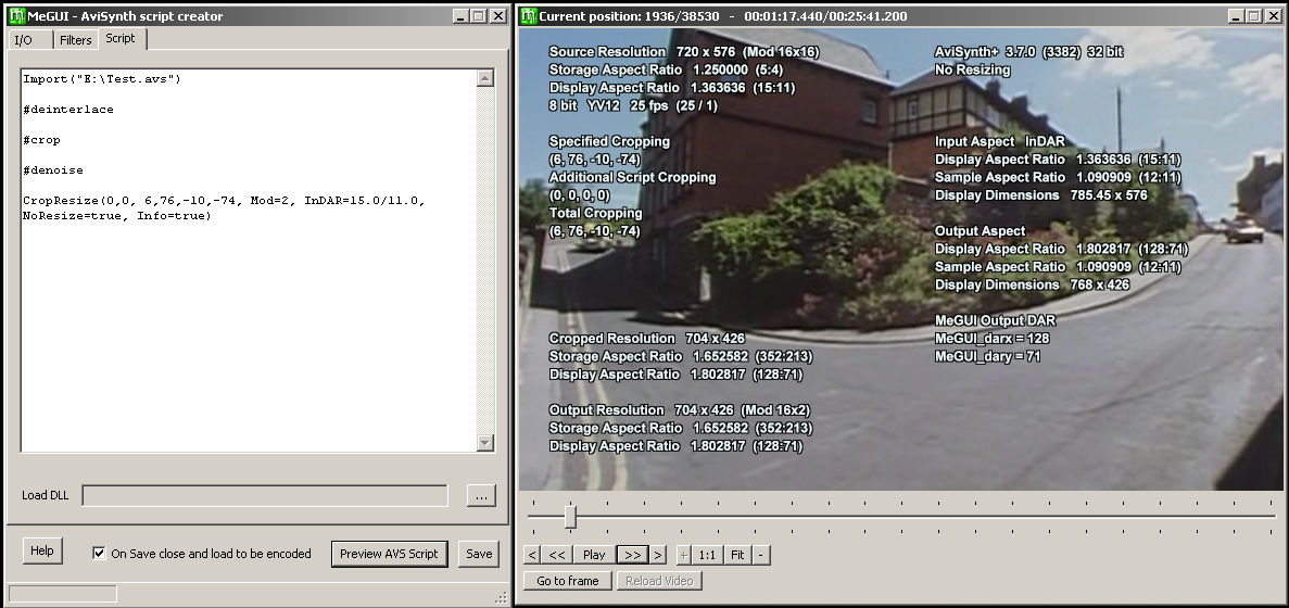

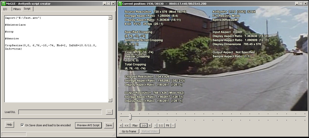

    It might be easier to show you using the CropResize function in my signature as it can use MeGUI's DAR from the script for it's input DAR, then show you the fun stuff.
    For this screenshot I've applied your cropping to a 720x576 video with the Script Creator's Input DAR set to 4:3.
    Top left you can see the video dimensions after MeGUI's cropping are 704x426.
    On the right under Input Aspect you'll see the DAR is the same as the one at the top of the script. The function uses the formula above to calculate the SAR, and as you can see on the next line down it's 16:15 (based on MeGUI's new DAR and the cropped 704x426 dimensions).
    And 704 x 16/15 = 750.93 which is the width shown for the display dimensions.
    [Attachment 62699 - Click to enlarge]

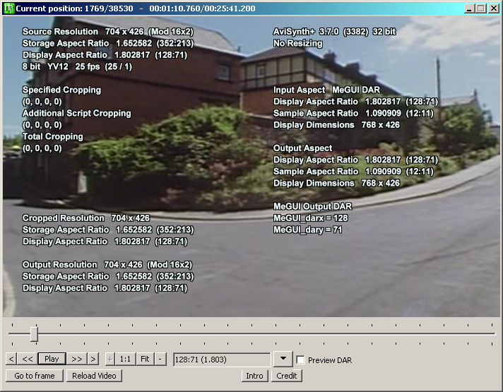

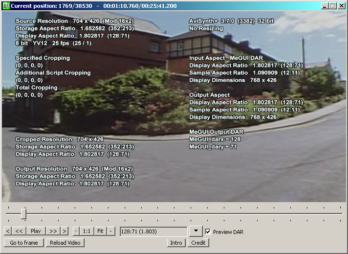

    If you enable the anamorphic option that resizes, and resize in any way, it will usually change the SAR (which is not shown in the script), as only cropping will change the DAR at the top of the script.
    So.... MeGUI normally does what my function did. It uses the dimensions after cropping/resizing and the new DAR to calculate the SAR for you (all based on the Input DAR you selected in the script creator as the starting point).
    After you save the script and load it into the video section, the preview will show you the same DAR at the bottom.
    [Attachment 62701 - Click to enlarge]
    Checking "Preview DAR" will cause it to resize the preview to the aspect ratio you'll get on playback (if you change the DAR at the bottom of the preview MeGUI will use it instead, so you'll have to re-load the script to get the original DAR again).
    [Attachment 62702 - Click to enlarge]

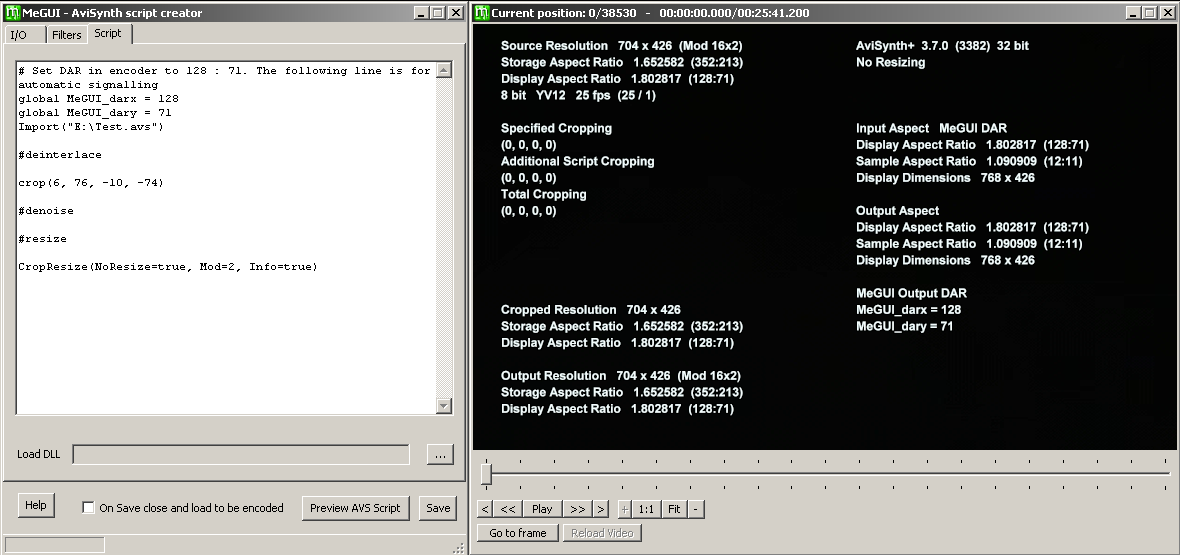

  22. I didn't consider any deinterlacing as I came into the thread late and haven't seen the source video, so I just assumed it was either progressive or being de-interlaced in the script first. If it's not being de-interlaced the cropped height should be mod4.
    <shameless plug>
    I generally use MeGUI or AVSPmod to determine the cropping, then once I've worked out the cropping required I disable it and get CropResize to do the work. For an anamorphic output, CropResize will always create MeGUI's global DAR variables so MeGUI will still calculate the SAR for encoding, even if it's anamorphic encoding isn't enabled.
    Even if you don't go that far though, NoResize=true gives you the same anamorphic output, but temporarily removing it and refreshing the preview resizes to square pixel dimensions, so you can see what an anamorphic output will look like on playback. I never use Mod=2 myself, but as maudit was cropping to a mod2 height, I did.
    [Attachment 62706 - Click to enlarge]
    Resized
    [Attachment 62707 - Click to enlarge]
    </shameless plug>
