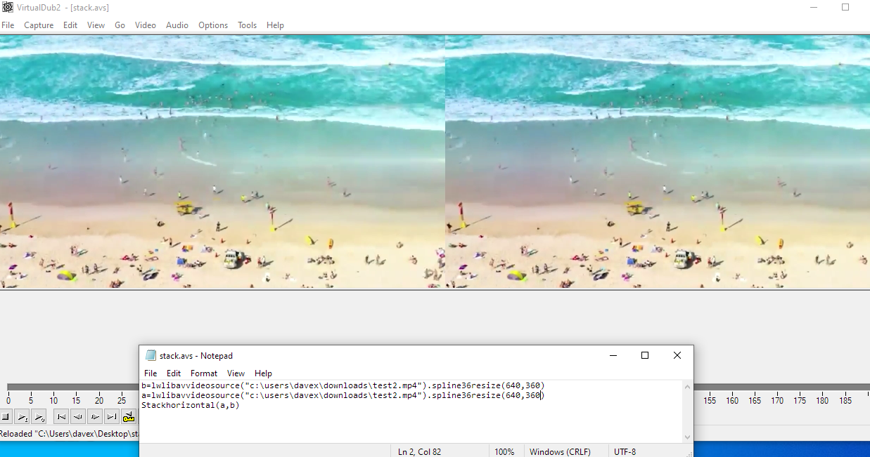

    You can open both in avisynth script then use stackhorizontal() to put them side by side.
    Open the script in Virtualdub2 or AvsPmod

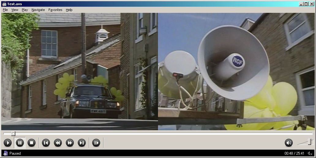

  3. Try copying this, pasting it into notepad and saving it with an avs extension. Open it in MPC-HC or SMPlayer, or VirtualDub2 (not sure about VLC), and if you see colorbars you'll know Avisynth is working. If it works with one of those programs then you can look at the AvsPmod problem. You should use Avisynth+.
    ColorBars()
    Once you have Avisynth working someone will help with opening videos if need be, but make sure it's working first. You need to use 32 bit Avisynth+ with 32 bit programs and 64 bit Avisynth+ with 64 bit programs. I'm pretty sure it's fine to install both versions of Avisynth+ at the same time.
    An example script. It might be easier to have both videos displaying in a single script. You'd adjust the Trim values as required to sync them up. LWLibavVideoSource is a source filter for opening videos. It requires this plugin. http://avisynth.nl/index.php/LSMASHSource
    A = LWLibavVideoSource("E:\Video 1.mkv").Trim(0, 0)
    B = LWLibavVideoSource("E:\Video 2.mkv").Trim(2, 0)
    StackHorizontal(A, B)
    [Attachment 62313 - Click to enlarge]

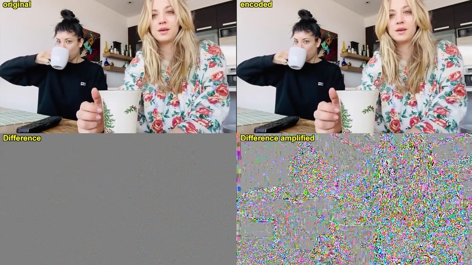

    My personal preference when I want to compare quality on one video to another that has been recoded with different parameters is stacked and subtracted as well as amplified. Not sure where i copied this from but I think someone here posted it.
    v1=directshowsource("C:\Users\Bud\Desktop\20sec.mp 4").ConvertToYV12().lanczosresize(480,270)
    v2=directshowsource("C:\Users\Bud\Desktop\news20se c.mp4").ConvertToYV12().lanczosresize(480,270)
    sub = v1.subtract(v2)
    substrong = sub.levels (122,1,132,0,255)
    StackVertical (StackHorizontal (v1.subtitle ("original"),v2.subtitle("encoded")), StackHorizontal(sub.subtitle("Difference"),substro ng.subtitle("Difference amplified")))
    Resizing doesn't appear alter the output:
    [Attachment 62315 - Click to enlarge]

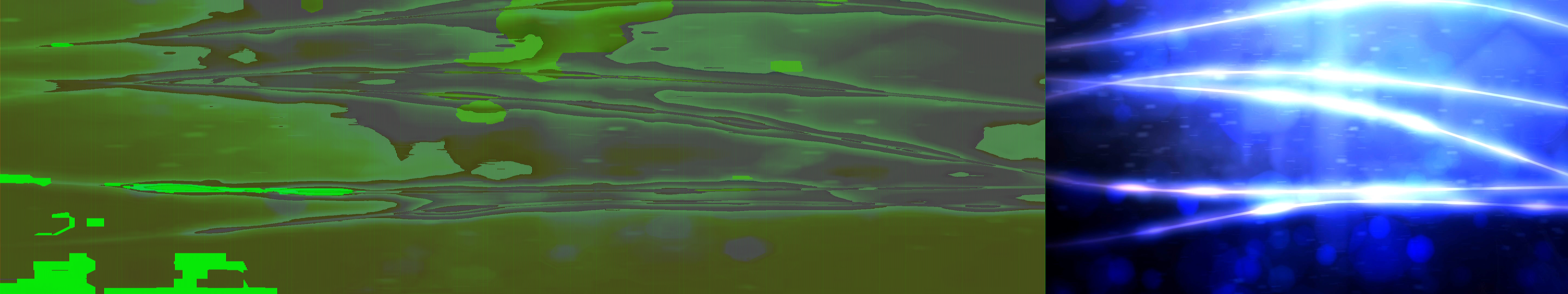

    Thx both, I installed AviSynt+ and it works now, tried the ColorBars() and the side by side code. However I'd like to have the videos on top of each other, and switching from one to another to see the differences easely. How can I do that ?
    Also, it seems to read HEVC pretty badly, it's full of green noise (and the one is bigger than the other video)
    [Attachment 62317 - Click to enlarge]
    It looks like the program isn't handling high bit color. What program were you using to view the script? I highly recommend VirtualDub2 for viewing AVS scripts. Also, what source filter were you using? Post your script.

    That's probably a bit depth problem. The first file name says it's 10 bit, and it's likely the second file is 8 bit. Try adding .ConvertBits(8) to the end of the first line:
    A = LWLibavVideoSource("10bits x265 file.mkv").Trim(0, 0).ConvertBits(8)
    B = LWLibavVideoSource("264 file.mkv").Trim(2, 0)
    Better?

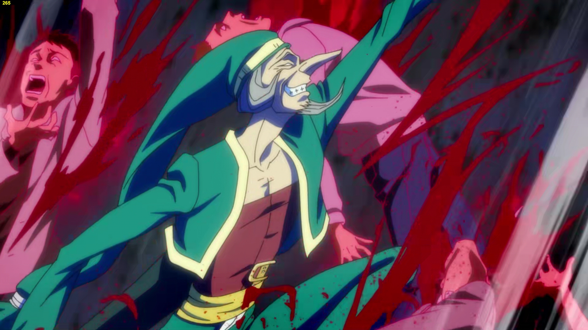

    I got another question, is it normal if the video doesn't look the same on VLC and on VirtualDub ? (minimal difference but it matters if I want to compare versions)
    Look for yourself (Screens taken from VirtualDub and VLC's own screen capture feature, PrintScreen gave a bigger difference in color somehow): both are the 265 one
    from VirtualDub
    [Attachment 62326 - Click to enlarge]
    From VLC
    [Attachment 62327 - Click to enlarge]
    Yes, it's quite common to see small differences. In this case the video has to be converted from 10 bit to 8 bit for display (I'm assuming you're running an 8 bit display). Different programs may do that slightly differently (rounding, truncating, dithering). In addition the video is 4:2:0 chroma subsampled, meaning it has a 1920x1080 luma channel but the chroma channels are 960x540. Different programs may use different methods of scaling/positioning the chroma back up to 1920x1080 (nearest neighbor, bilinear, bicubic, etc.).
    Then you have the difference between rec.601 and rec.709 colors. They will deliver slightly different colors, most noticeable in reds and greens.
    https://forum.videohelp.com/threads/329866-incorrect-collor-display-in-video-playback#post2045830
    Generally, SD uses rec.601, HD rec.709. But any resolution can be either spec. The video can be flagged with the color matrix (MediaInfo will usually show it if it's there). Some players/editors assume one, or the other for all videos. Some will use rec.601 for SD, rec.709 for HD. Some players will follow the flags, some not.
    Then there's full range vs. limited range, rec.2020, HDR, etc.
    And one of your sample images was a lossless PNG file, the other a lossy JPG file. The JPEG compression will cause some differences.
    VirtualDub2 usually uses a rec.601 matrix for the color convesions. If you want to be sure you're seeing the correct colors use ConvertToRGB() at the end of your script, specifying matrix="rec601", or matrix="rec709". So for a rec.709 video:
    A = LWLibavVideoSource("10bits x265.mkv", format="YUV420P8")
    B = LWLibavVideoSource("x264.mkv", format="YUV420P8")
    Interleave(A.Subtitle("A"),B.Subtitle("B"))
    ConvertToRGB(matrix="rec709")
    If one of your videos has rec.709 colors and the other has rec.601 colors:
    A = LWLibavVideoSource("10bits x265.mkv", format="YUV420P8").ConvertToRGB(matrix="rec709")
    B = LWLibavVideoSource("x264.mkv", format="YUV420P8").ConvertToRGB(matrix="rec601")
    With AviSynth performing the conversion to RGB you have explicit and consistent control of the parameters.
