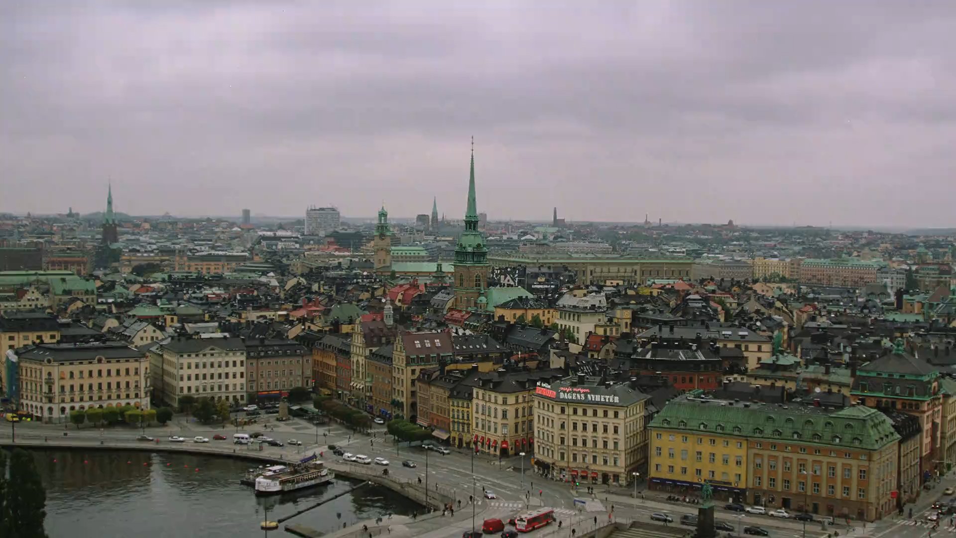

    Here's some screenshots from an old thread comparing x264's ABR and 2 pass encoding for a short, complex video. The same average bitrate was used each time. It illustrates what can happen when ABR has to guess. The first scene was quite complex, so ABR gave the first frame a whole lot of bits, then had drop the quality so it wouldn't exceed the specified average bitrate, and by frame 50 the whole thing had turned to crap.
    ABR
    [Attachment 31117 - Click to enlarge]

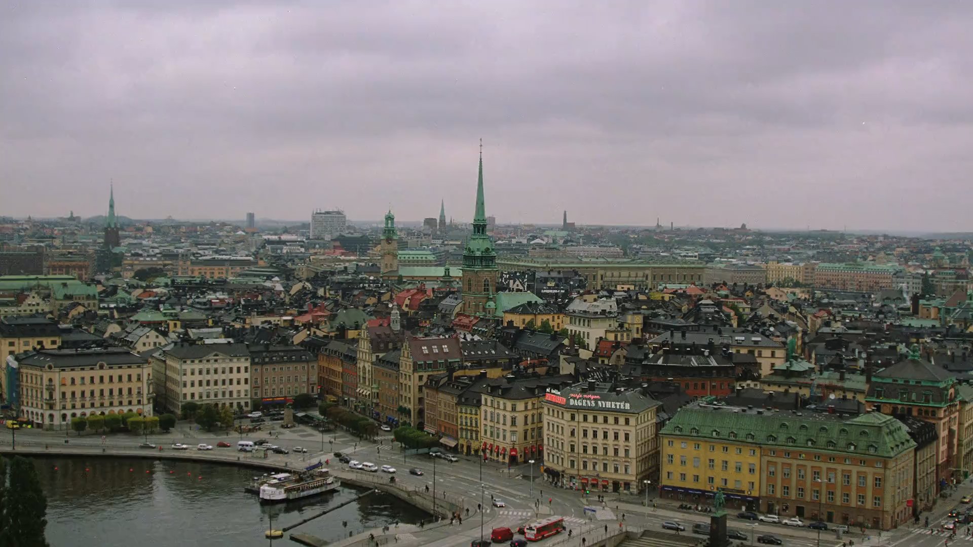

    2 pass had the benefit of a first pass.
    [Attachment 31118 - Click to enlarge]

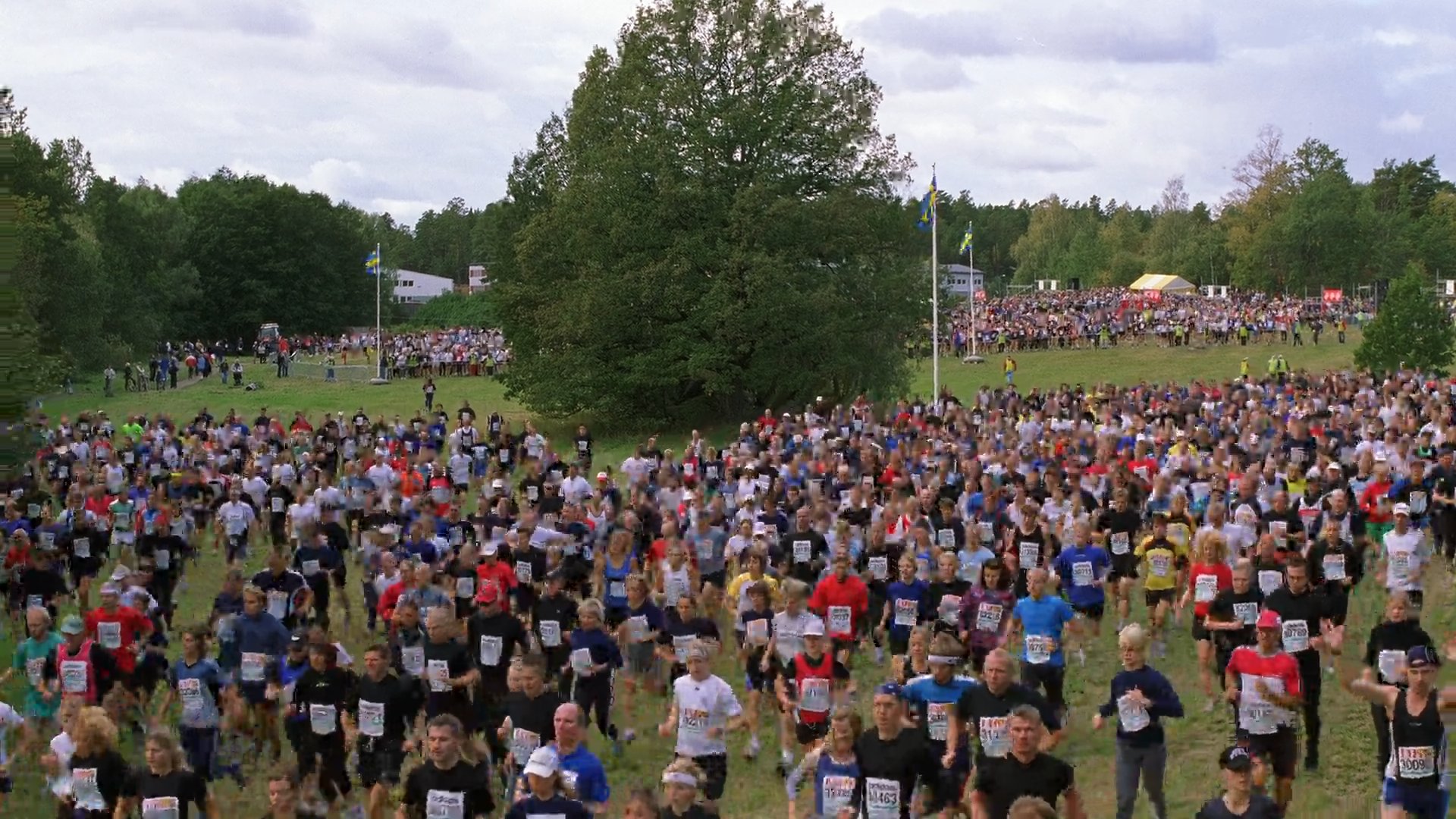

    By frame 2000, where the picture was easier to encode, ABR was using the bits it saved, which would have been better spent earlier, so the ABR quality was a little higher.
    ABR
    [Attachment 31125 - Click to enlarge]

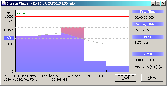

    How ABR distributed the bits over the 2500 frames encoded (shown as the bitrate for groups of frames).
    [Attachment 31174 - Click to enlarge]

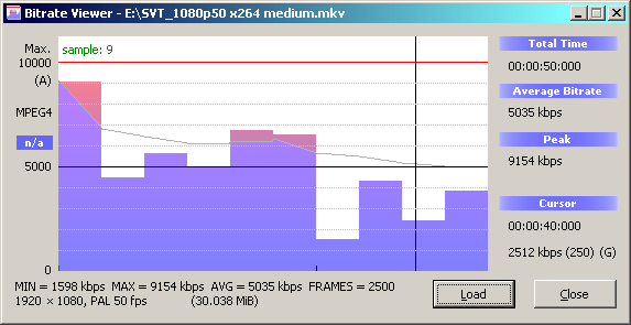

    How 2 pass spent them.
    [Attachment 31176 - Click to enlarge]

    Which app he used to see bitrate chart??
  9. Originally Posted by kirito View Post
    You can see it in the Title Bar -- Bitrate Viewer. AKA, MPEG File Bitrate Viewer.
