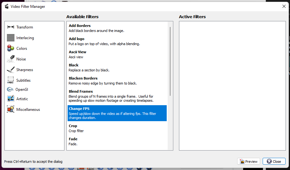

  4. Keep it at 18 fps? The problem is - it isn't at 18 fps. It's at 24 - and plays too fast. How do I get a file that is at 18fps?
    Aug 2004
    PA USA
    Use Avidemux, change the video from "Copy" to say (pick your format) I use Mpeg4 AVC (x264), then click on "Filters" and Change FPS to 18 this will change the duration i.e. slowing it down.
    [Attachment 62063 - Click to enlarge]

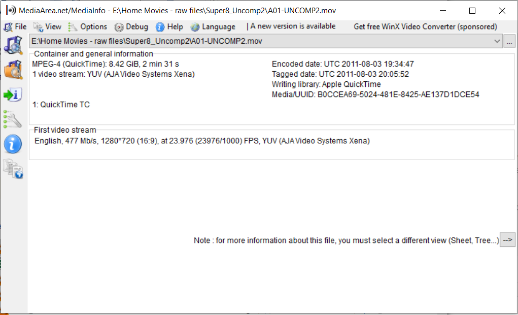

  7. Here's mediainfo on one of the uncompressed files
    [Attachment 62064 - Click to enlarge]
    Trying to use avidemux, the video doesn't play right - pretty screen of random colors.

  10. I can't find anything identified as "fourcc"
    General
    Complete name : E:\Home Movies - raw files\Super8_Uncomp2\A01-UNCOMP2.mov
    Format : MPEG-4
    Format profile : QuickTime
    Codec ID : qt 2005.03 (qt )
    File size : 8.42 GiB
    Duration : 2 min 31 s
    Overall bit rate : 477 Mb/s
    Encoded date : UTC 2011-08-03 19:34:47
    Tagged date : UTC 2011-08-03 20:05:52
    Writing library : Apple QuickTime
    Media/UUID : B0CCEA69-5024-481E-8425-AE137D1DCE54
    Video
    Format : YUV
    Codec ID : v210
    Codec ID/Hint : AJA Video Systems Xena
    Bit rate mode : Constant
    Bit rate : 477 Mb/s
    Width : 1 280 pixels
    Clean aperture width : 1 248 pixels
    Height : 720 pixels
    Clean aperture height : 702 pixels
    Display aspect ratio : 16:9
    Clean aperture display aspect ratio : 16:9
    Frame rate mode : Constant
    Frame rate : 23.976 (23976/1000) FPS
    Color space : YUV
    Chroma subsampling : 4:2:2
    Bit depth : 10 bits
    Compression mode : Lossless
    Bits/(Pixel*Frame) : 21.600
    Stream size : 8.42 GiB (100%)
    Language : English
    Tagged date : UTC 2011-08-03 20:05:51
    Color primaries : BT.709
    Transfer characteristics : BT.709
    Matrix coefficients : BT.709
    Other
    Type : Time code
    Format : QuickTime TC
    Time code of first frame : 01:00:00:00
    Time code, striped : Yes
    Language : English
    Encoded date : UTC 2011-08-03 20:05:51
  11. AMCDX fails to open the files "No supported video stream found"
