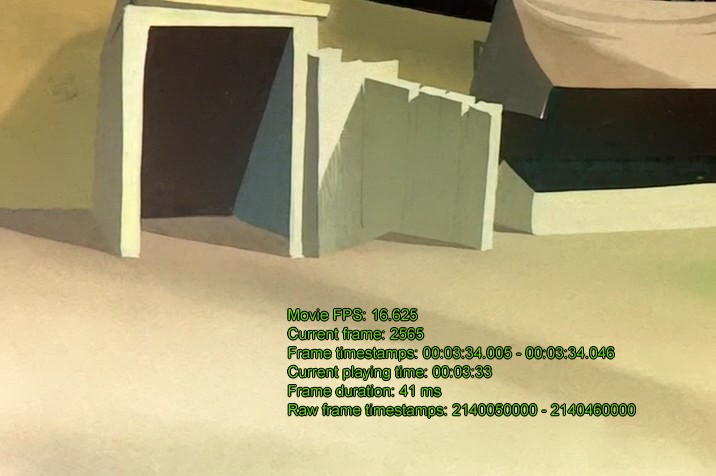

  6. I don't know how ffprobe does it exactly, but if it's anything like ffdshow, it counts at a constant frame rate even for variable frame rate video. The timebase seems to determine the frame rate at which it counts (in a way I'm yet to fully understand). For VFR, when the frame rate is higher than the rate at which it's counting, sometimes more than one frame has the same frame number. When it's lower, frame numbers are sometimes skipped.
    MKVToolNix has an option to cut based on timestamps, which I think is effectively the same as cutting after a particular duration, except the former only cuts once. The video in the screenshot below is variable frame rate. When I asked MKVToolNic to cut on frame number 2565, it cut about 300 frames early, but when I asked it to cut at 03:34.000, it cut where I wanted it to (I'd already determined the next frame would be a keyframe). The tool you're using for cutting doesn't have a similar option?
    [Attachment 61954 - Click to enlarge]
