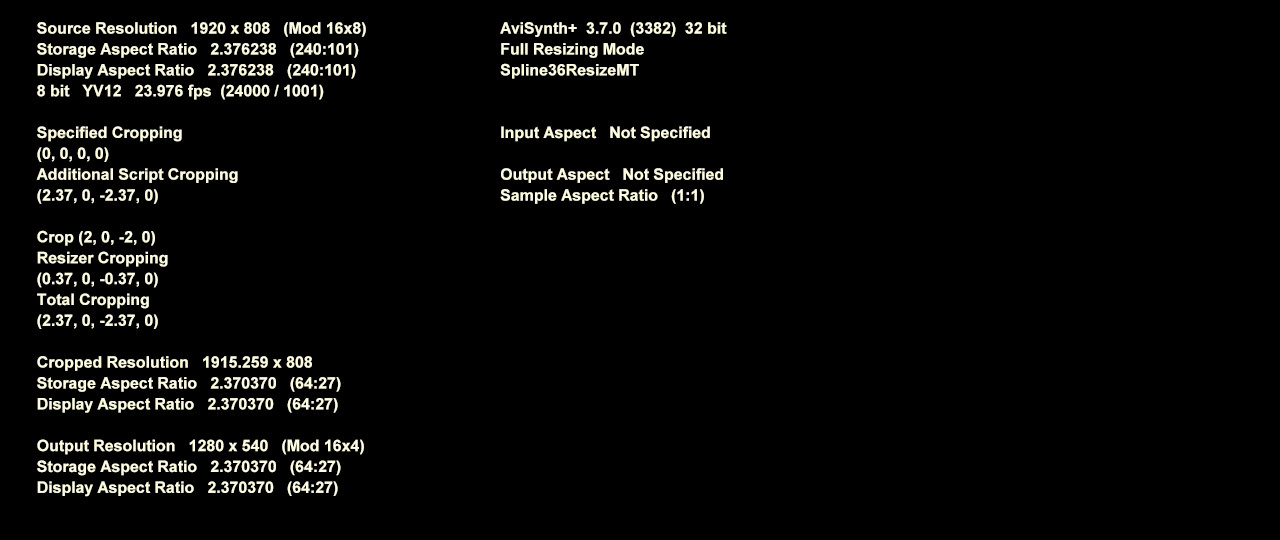

    Then you could just calculate the appropriate dimensions and use the resizer you prefer.
    My script will do much the same thing, except it will crop a little to prevent aspect error when the new dimensions don't match the original aspect ratio exactly. Often it crops less than a whole pixel to prevent aspect error.
    As a made-up example, if you had a 1920x808 source and wanted to resize to 720p, the exact dimensions for resizing would be 1280x538.66. It's not much different but often that'd be resized to 1280x540 instead with a little aspect error. 1920/808 = 2.376 and 1280/540 = 2.37
    The alternative would be to crop a couple of pixels each side before downscaling so there's less distortion. 1916/808 = 2.371
    Left to it's own devices, that's what CropResize does, only it crops the exact amount required. The main motivation for creating the function was so I'd never have to calculate that sort of thing again myself when resizing.
    For a 1920x808 source, CropResize(1280) would output this.
    [Attachment 61894 - Click to enlarge]

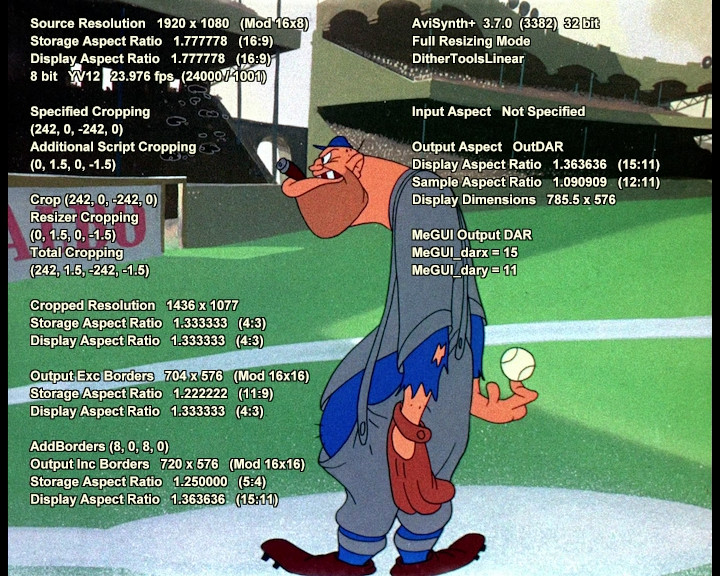

    Edit: I was bored, so I made a thing. Are there other essentials the function should include? I'll go through the full argument list sometime.
    function DitherToolsLinear(clip Source, int Width, int Height, \
    float "src_left", float "src_top", float "src_width", float "src_height", \
    string "Kernel", string "CurveS", string "CurveD", bool "LSBIn", bool "LSBOut")  {
    Kernel = default(Kernel, "Spline16")
    CurveS = default(CurveS, "709")
    CurveD = default(CurveD, CurveS)
    LSBIn = default(LSBIn, false)
    LSBOut = default(LSBOut, false)
    Input = !LSBIn ? Source.Dither_convert_8_to_16() : Source
    Resized = Input\
    .Dither_y_gamma_to_linear(curve=CurveS)\
    .Dither_resize16(Width, Height, src_left, src_top, src_width, src_height, kernel=Kernel)\
    .Dither_y_linear_to_gamma(curve=CurveD)
    Output = !LSBOut ? Resized.DitherPost() : Resized
    return Output  }
    [Attachment 61895 - Click to enlarge]
    CropResize(720,576, 242,0,-242,0, OutDAR=15.0/11.0, Resizer="DitherToolsLinear", Borders=true, Info=true)
    It should work fine with Avisynth 2.6.
    I forgot to convert the colors so they've changed a little..
    [Attachment 61917 - Click to enlarge]

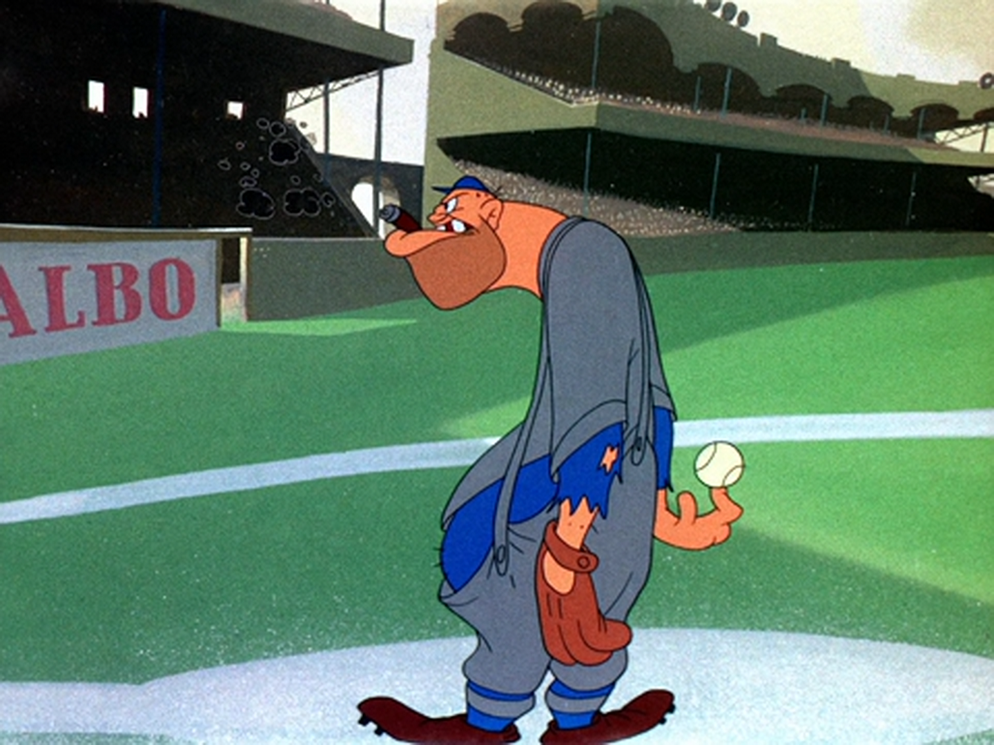

  20. I was bored again so I thought I'd amuse myself with a quick comparison.
    That was before I realised FMTConv should come with a warning that trying to use it might make you suicidal.
    I couldn't work out how to do linear light resizing with FMTConv without a conversion to RGB and back. I don't think it can.
    The screenshots are from the same frame I used in my previous post. The source is quite noisy. I downscaled as much as I could without the picture turning to total mush, then resized it back to 1080p with Spline36Resize. I was mainly looking for differences in the white smoke rings and small specs of white amongst the grey in the top left corner. Each resizing method used Spline36 for downscaling as it's the default for each.
    Spline36 in non-linear light obviously loses the most brightness in those small white areas.
    Despite DitherTools resizing in linear YUV and FMTConv converting to RGB and back, they look visually the same to me.
    ResampleHQ retained a tad more brightness for some reason.
    PNGs this time.
    Original
    [Attachment 61901 - Click to enlarge]

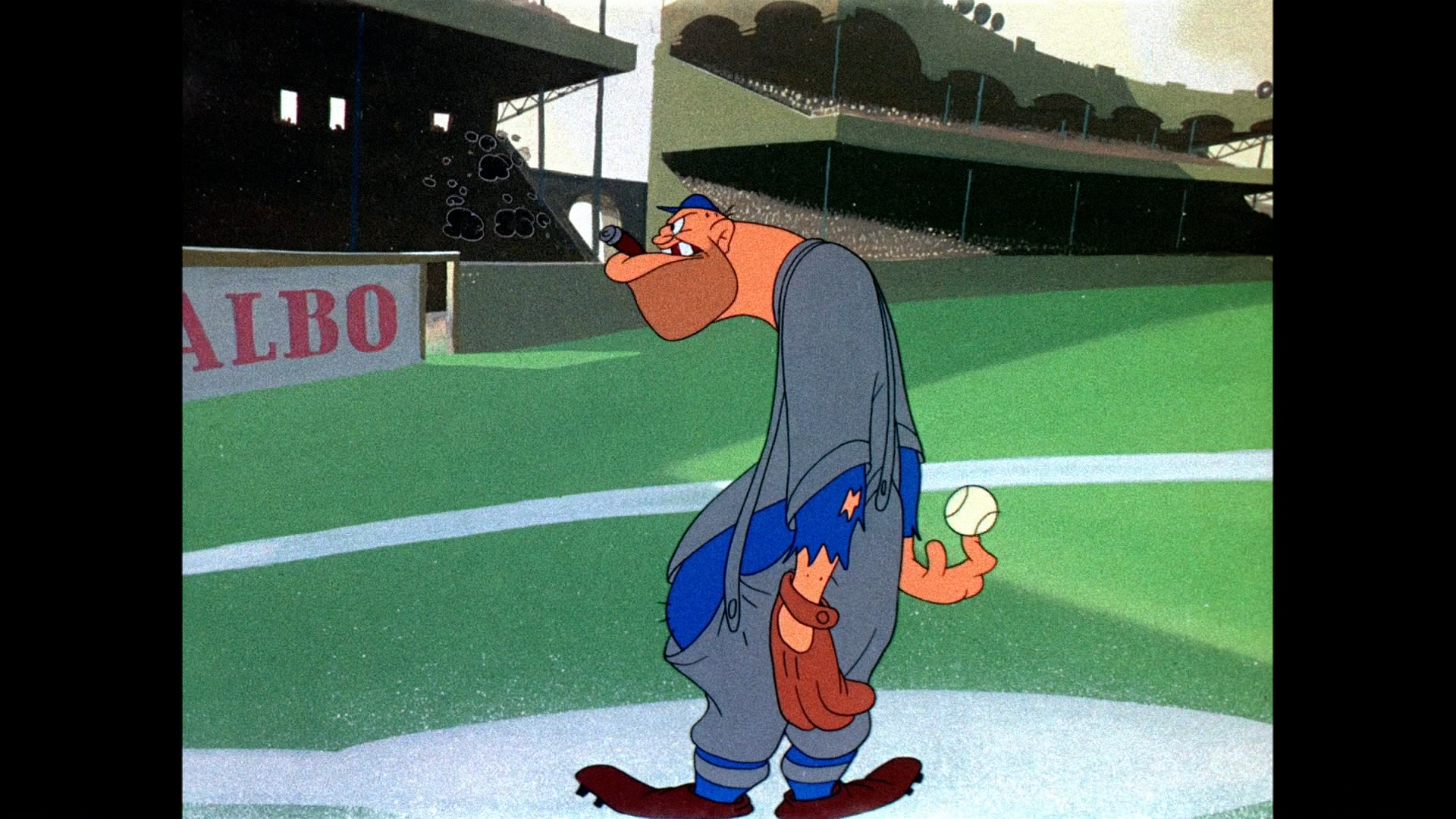

    Spline36Resize
    CropResize(480,360, 242,0,-242,0, Resizer="Spline36")
    Spline36Resize(1440,1080)
    [Attachment 61902 - Click to enlarge]

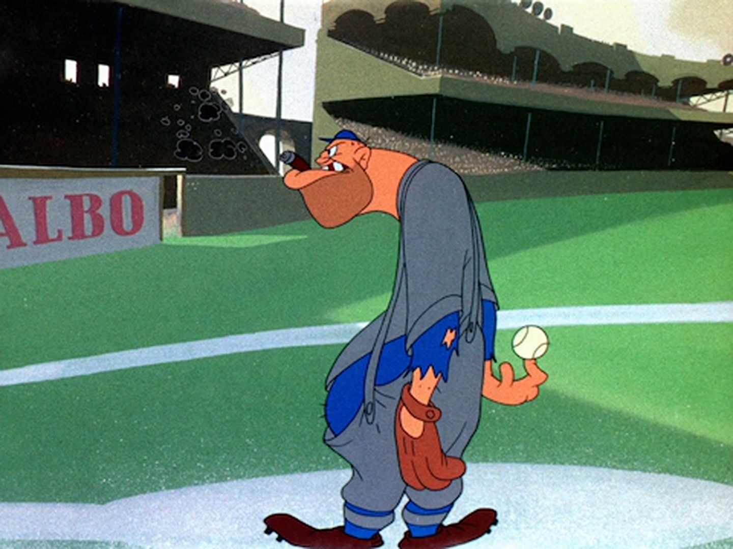

    DitherTools
    CropResize(480,360, 242,0,-242,0, Resizer="DitherToolsLinear")
    [Attachment 61903 - Click to enlarge]

  22. You must be more sensitive to the dark halos than I am. I had to really look to see what you were referring to.
    sigmoid=true seems to reduce the effect of resizing in linear light. At least for this example. While playing around though, I noticed something else. The updated version of DitherToolsLinear is below if you're interested in using it. It has Spline36 as the default, but obviously you can change that.
    For sigmoid=true the jaggedness or aliasing, however you'd describe it, is reduced in the dark lines, but for the rec.709 curve it also reduces the effect of linear light downscaling. I don't really understand when you're supposed to use 1886 rather than 709, but in this particular instance, the 1886 curve with sigmoid=true seems to be the best of both worlds. How does it look to you?
    I'm having a hard time spotting much difference in aliasing at the downscaled resolution, but it does seem to effect the upscaling. For each one, I've included a screenshot before upscaling.
    CropResize(480,360, 242,0,-242,0, Resizer="DitherToolsLinear", RStr="SigmoidS=false")
    [Attachment 61936 - Click to enlarge]
    [Attachment 61937 - Click to enlarge]
    CropResize(480,360, 242,0,-242,0, Resizer="DitherToolsLinear", RStr="SigmoidS=true")
    [Attachment 61938 - Click to enlarge]
    [Attachment 61939 - Click to enlarge]
    CropResize(480,360, 242,0,-242,0, Resizer="DitherToolsLinear", RStr=""" SigmoidS=false, CurveS="1886" """)
    [Attachment 61940 - Click to enlarge]
    [Attachment 61941 - Click to enlarge]
    CropResize(480,360, 242,0,-242,0, Resizer="DitherToolsLinear", RStr=""" SigmoidS=true, CurveS="1886" """)
    [Attachment 61942 - Click to enlarge]
    [Attachment 61943 - Click to enlarge]
