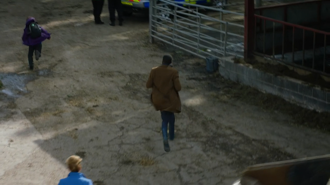

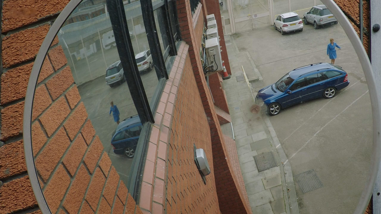

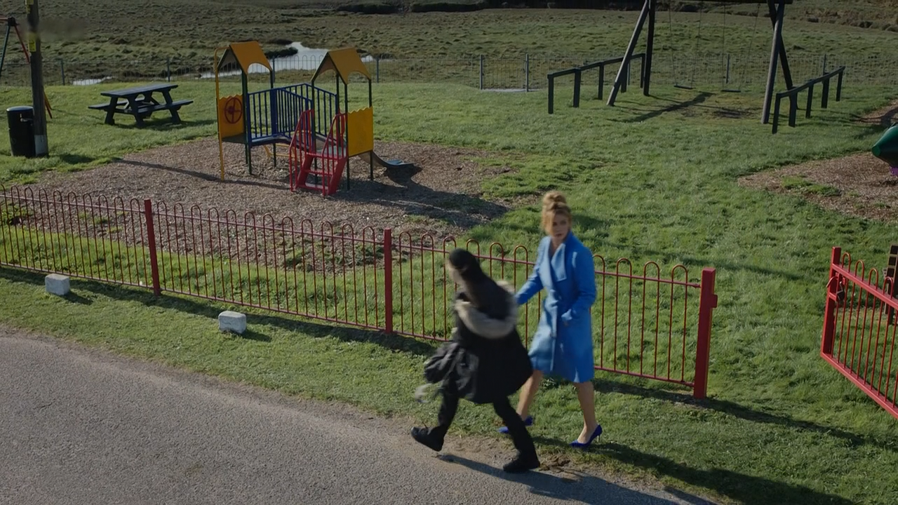

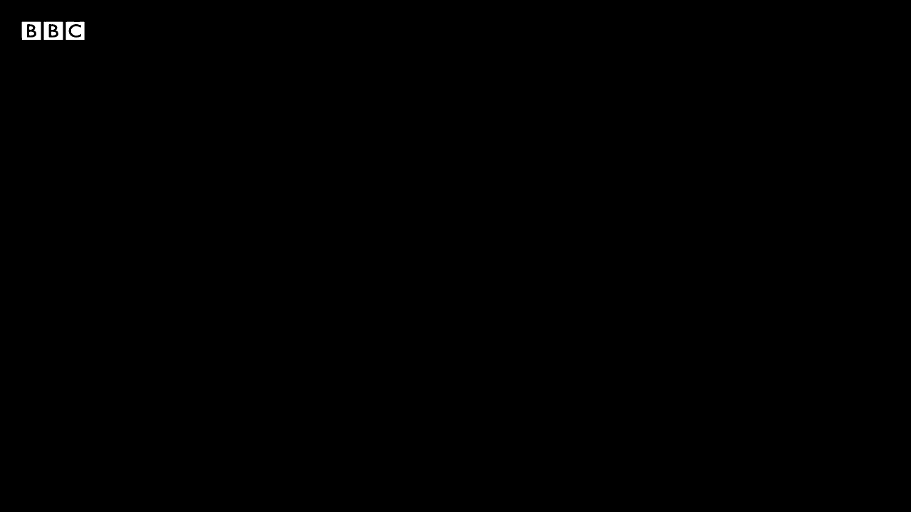

If AviUtl has a decent plugin for removing logos that's probably the way to go. Transparent logos are generally easy to remove. Opaque logos are a bit more challenging but often they can also removed with reasonable results. There's a few Avisynth plugins for that sort of thing, although there's initially something of a learning curve when you start using Avisynth. A few days ago I could have uploaded some before and after screenshots, but I've deleted the original files. I can show you mask I created for the logo removal plugin though, and a few screenshots where if you look closely you can see where it was.
Of course you'd want to remove all those duplicate frames first anyway. Delogoing can be a bit slow so there's no point delogoing 60 frames every second when you only need to do 25.
[Attachment 61734 - Click to enlarge]
[Attachment 61735 - Click to enlarge]
[Attachment 61736 - Click to enlarge]
