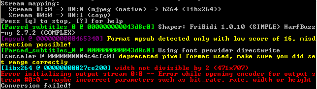

  8. I could not get Hybrid to work , so I tried ffmpeg and got this:

  10. Make sure the witdh and height of your image is evenly dividable by 2 (learn how to add borders to archive it in ffmpeg), not evenly dividable by 2 content can't be converted to YV12.
    -> if you want to understand what is happening and why you might want to start reading up what color sampling is.
