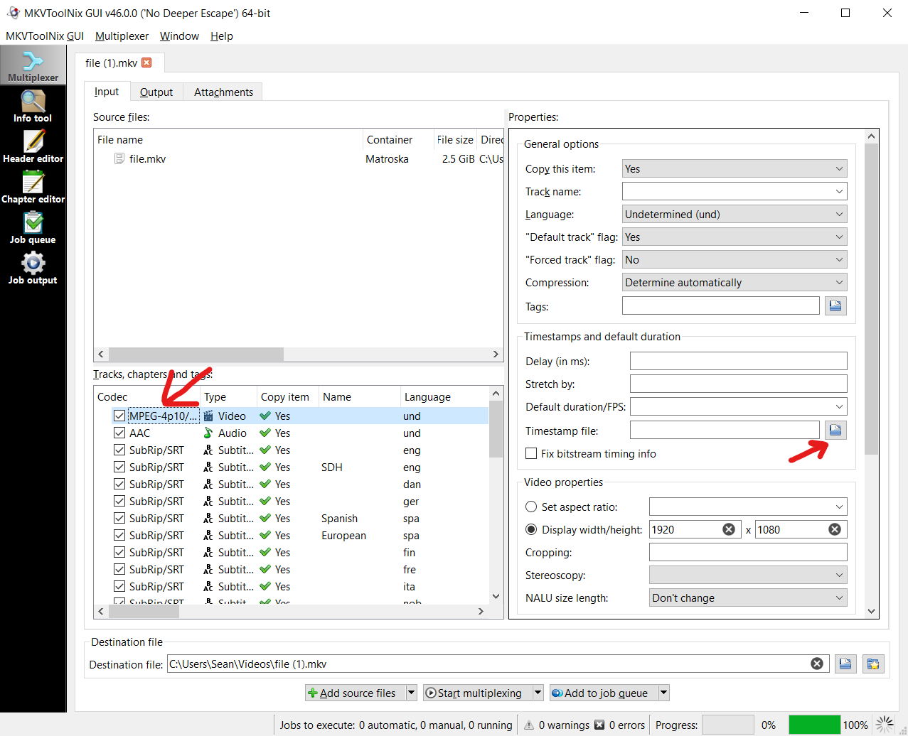

    For MKV files, you need MKVToolNix. There are two ways of doing this - to do it from the GUI, you need to create a text file with this inside it
    # timestamp format v1
    assume 23.976
    Put whatever frame rate is desired after the word "assume" (29.97, 59.94 30, 60, etc.) Name it whatever you want, open up your MKV in the GUI, then select the video stream, and add your text file under "Timestamp File" on the right hand side (see an explanation screenshot here.)
    Alternatively, you can do this from the command line without needing to create a text file, using this code:
    "C:\Program Files\MKVToolNix\mkvmerge.exe" --output "C:\file_fixed.mkv" --language 0:eng --default-track 0:yes --display-dimensions 0:1920x1080 --default-duration 0:24000/1001p --language 1:eng --default-track 1:yes (C:\original_file.mkv) --track-order 0:0,0:1
