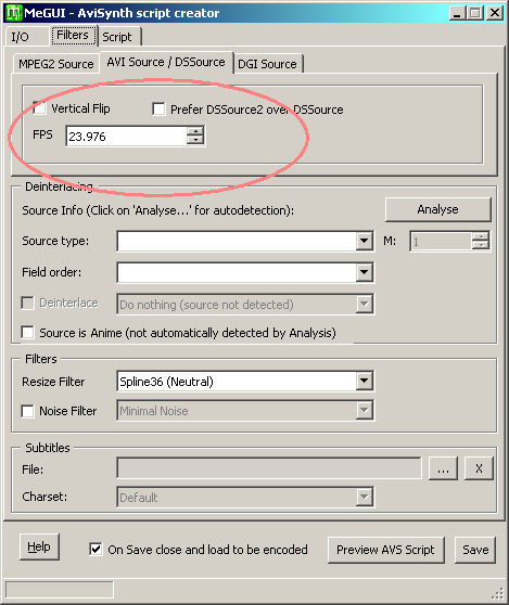

  19. VHGNM,
    It'd help if you explained how you're trying to change the frame rate with MeGUI. Paste a copy of the script it creates and/or attach MeGUI's log file to a post so we can see what it's doing.
    The only native method I'm aware of that MeGUI has for converting the frame rate relies on you opening a video with AviSource or DirectShowSource (both of which are disabled by default) and setting the new frame rate in the script creator GUI.
    When opening a video with DirectShowSource it converts the frame rate by adding/dropping frames. It's really only intended for converting a variable frame rate source to a constant frame rate. All that'll happen if you use it to increase the frame rate for a normal constant frame rate source, is it'll pointlessly add a bunch of duplicate frames but the video won't look any different.
    When opening a video with AviSource, the same option uses (from memory) Avisynth's AssumeFPS() to change the frame rate, so all it really does it speed the video up or slow it down.
    The frame rate option below will be greyed out unless either AviSource or DirectShowSource is the source filter MeGUI is using to open the video.
    [Attachment 59637 - Click to enlarge]
    The only other way MeGUI can change the frame rate is when applying IVTC or de-interlacing, but the frame rate isn't something you can specify. Bob de-interlacing a 25fps source will output 50fps and for a 29.97fps source the output will be 59.94fps.
    If you're trying to use MeGUI to convert the frame rate some other way, please explain what you're doing, because I'm not aware of MeGUI being able to change the frame rate in it's GUI, aside from the methods I described. For any other type of frame rate conversion (using an Avisynth function or plugin), you'd have to add it to the script manually.
