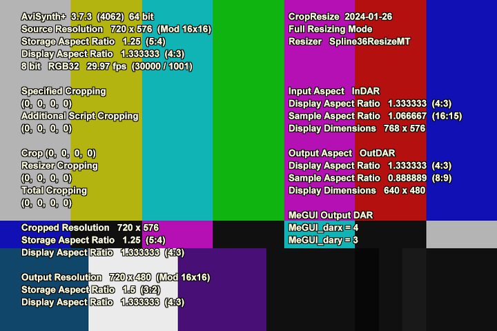

    By the way, if you use Avisynth, try following the CropResize link in my signature.
    It can resize to/from anamorphic dimensions and add borders along the way if need be, and all you need to do is specify the correct input aspect ratio (for an anamorphic source), and the desired output aspect ratio if you want an anamorphic output, and Info=true will display the input/output dimensions, display aspect ratio and sample/pixel aspect ratio. There's example screenshots in the second post.

    ColorBars() # resolution 640x480
    [Attachment 76549 - Click to enlarge]
    Spline36Resize(720, 576) # put the 4:3 color bars into a 5:4 PAL hole.
    [Attachment 76550 - Click to enlarge]
    CropResize(720,480, InDAR=4.0/3.0, OutDAR=4.0/3.0, Info=true) # put the PAL 4:3 color bars into a 3:2 NTSC hole.
    [Attachment 76551 - Click to enlarge]
    That's pretty easy because all you need to do is resize the 4:3 image to PAL dimensions, then resize it to NTSC dimensions. However if the image isn't exactly 4:3 and therefore it needs to be cropped to 4:3, or it needs to have borders added to make it 4:3...
    Once it's 4:3 though, all you need to do is resize it to 720x576.
