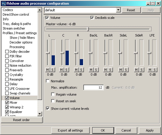

[aac @ 056dd740] Using a PCE to encode channel layout "5.1(side)"
I checked the AAC audio with ffdshow and foobar2000. They display the channels in different orders, but both show the channels containing audio are where they should be.
Both versions of MediaInfo I used to check the audio appear to be getting it wrong though.
Channel layout : L R C Cb Lb Rb
Channel positions: Front: L C R, Side: C, Back: L R
Edit: There does seem to be something odd about the way the ffmpeg encoded AAC stores the channel layout, now I've delved into it some more with MediaInfo in debug mode, but I'm not sure if it'd generally cause problems other than MediaInfo getting the layout wrong. I'll play around some more later and post back if I discover anything interesting.
[Attachment 59240 - Click to enlarge]
[Attachment 59241 - Click to enlarge]Last edited by hello_hello; 3rd Jun 2021 at 06:00.
