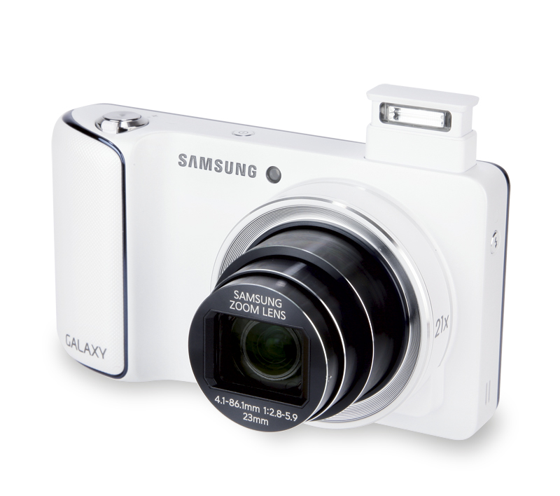

    Re: 8mm telecine. Back to basics for me.
    Have you checked the frame rate to see if the camera did create 25fps video, or if the video frame rate was of a more variable nature?
    I ask, because I'm fairly sure my Samsung smart phone adjusts the frame rate according to it's surroundings. I have a Plasma TV, and if I point the camera at the TV while it's refreshing at 60Hz, I can see the rolling shutter/strobing effect at first, but the camera quickly syncs itself to the TV and it goes away. When the TV's refreshing at 50Hz the same thing happens, and I think the frame rate changes to 25 or 50fps.
    I don't have any video handy that was shot near my TV while it refreshed at 50Hz, so that's just what I recall happened years ago when I tested it. Maybe it has something to do with the strobing vanishing from your tests. How many times does the projector flash the projection light for each frame? Is three times a standard thing?
    Does anyone know how cameras go about syncing themselves to a flashing light source, assuming I'm remembering correctly and that's what they do? They'd have to do the same when used under florescent lights., wouldn't they? Florescent lights flash in time with the power cycle, don't they? I can't remember.
    I have a Plasma TV,
    The camera is not a Samsung smart phone, it is a Samsung camera, so who knows....
    I also have a plasma tv, fabulous things, I should point the Samsung at the tv and see what I get.
    Thanks for taking the time to type...

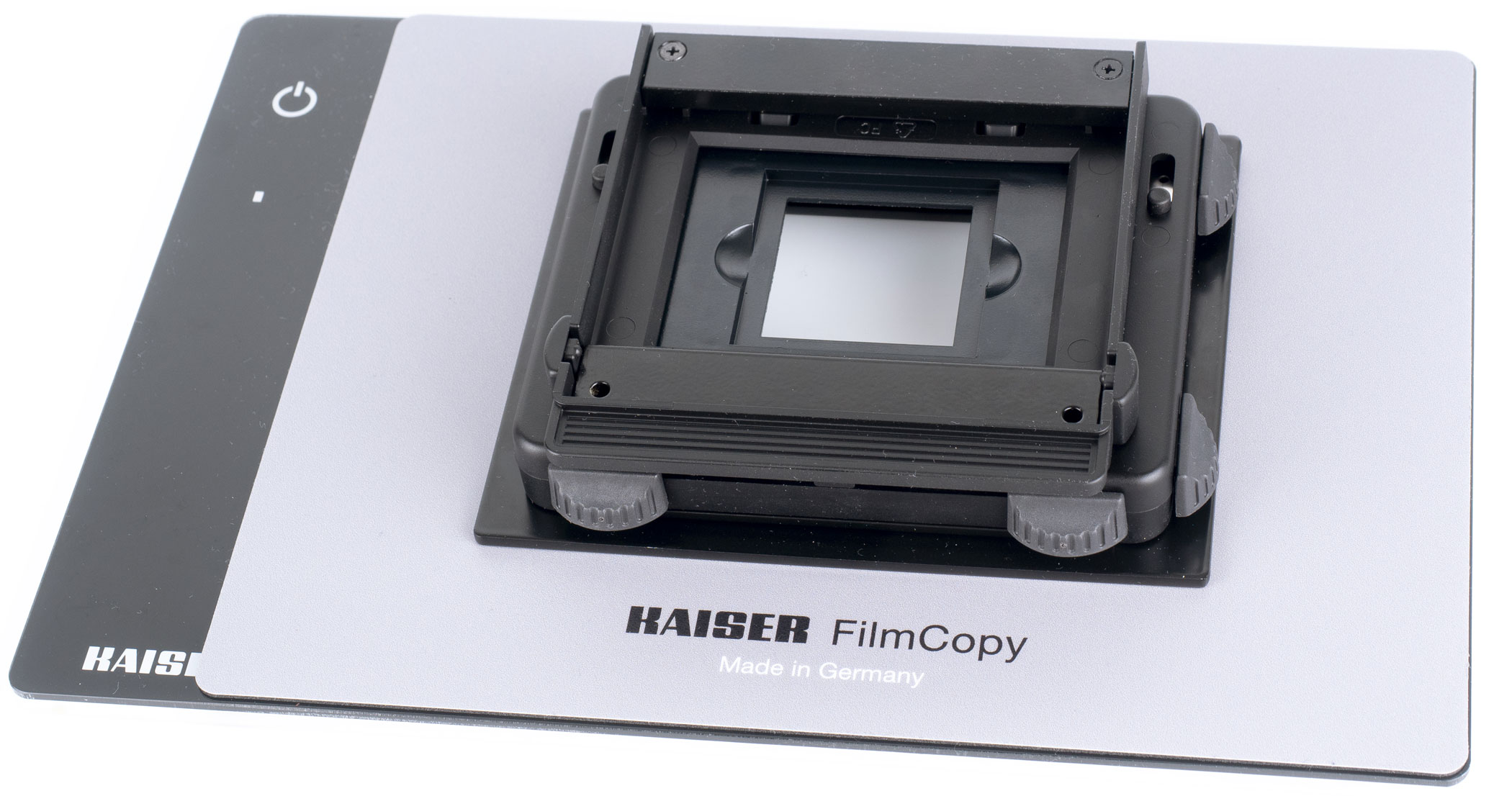

    When you say 'telecine box' do you mean the film was projected in to it and a video camera caught a right-angled image via a mirror ?
    Many moons ago I 'dabbled' in transferring 8mm film and I acquired a 'Kaiser' from a company in London - Lee's Cameras. Forget the cost but it was not cheap.
    I still own it (in original box with accessories) but am unlikely to ever use it again. Feeling kinda generous right now so if you want it it's your for the P+P. PM if you are tempted.
    Yes, that's the thing.
    Oh yes indeed. thank you.
    Thank You, very generous. I will attempt to send you a pm. I really do regret giving my telecine box to the charity shop.
    I thought I knew better having a Wolverine scanner.
    I don't profit from my scanning work for Royal Navy lads, I do it because I am ex RN too, I don't profit from my YT channel, non monetized, so, thank you.
    That said, I just googled Kaiser and all I saw was a device for still images from 35mm film.
    Perhaps I have the wrong device.

    This one.
    https://www.widescreen-centre.co.uk/kaiser-copy-box-for-video-transfer.html
    Check out that friggin' price !!!!!!!
