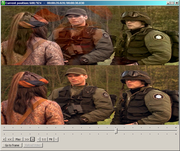

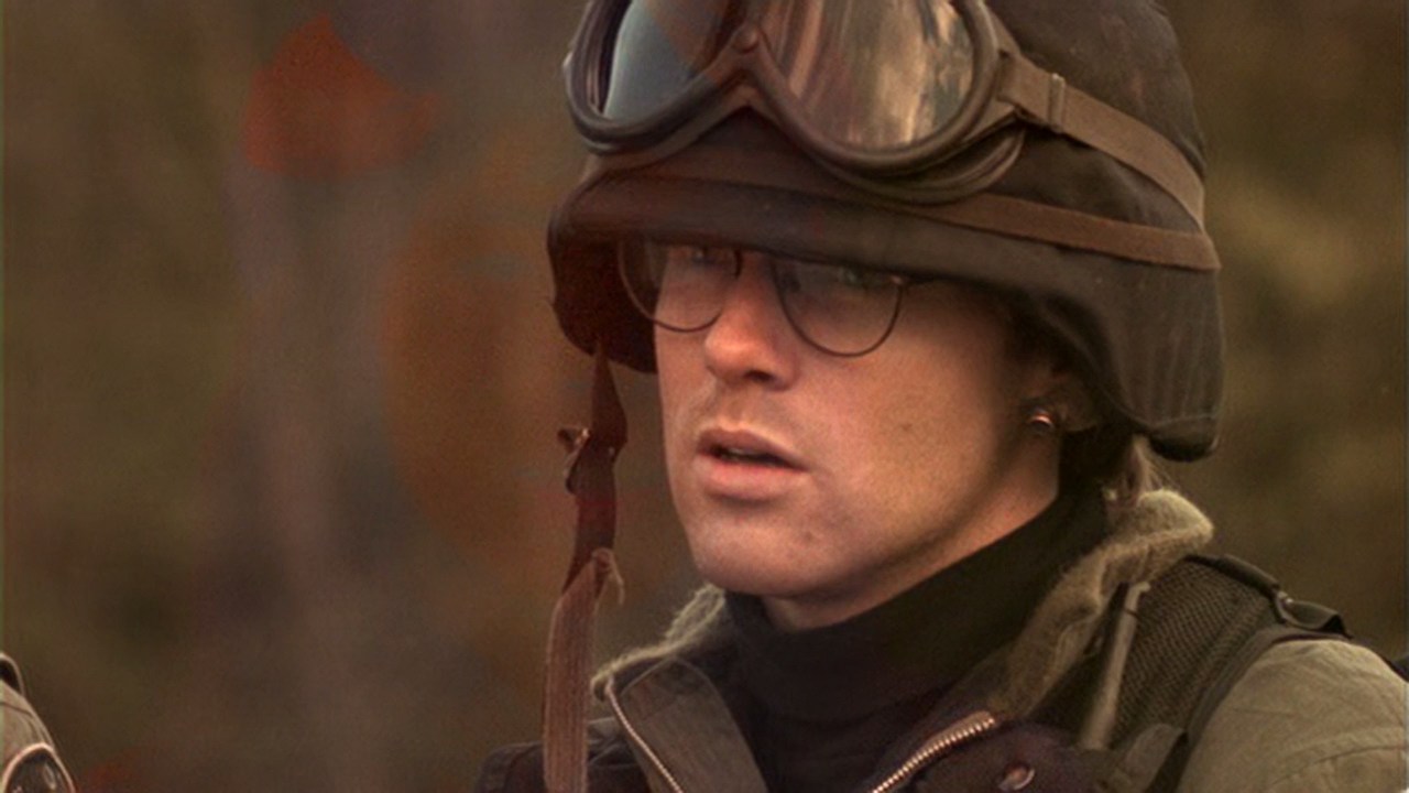

Still remain some artefacts after inverse telecine default and srestore ( hybrid ) , is something i can do to improve this ?
[Attachment 58110 - Click to enlarge]

Try
Code:TFM().TDecimate() QTGMC(InputType=3) #cleaning up
Then don't use Hybrid. Create a simple script manually and encode it in Virtualdub2
SRestore is for removing blending, when field blending is used to convert the frame rate, usually between NTSC and PAL. There's no need for it in this case.
TFM is leaving behind some combing (mostly around scene changes), but changing a couple of it's defaults fixes most of it, and if you're very fussy, any fine combing that remains can be cleaned up with the Vinverse plugin.
http://avisynth.nl/index.php/Vinverse
I'm not familiar enough with Hybrid to tell you how to change those things in a script, although I'd be surprised if it didn't include Vinverse.

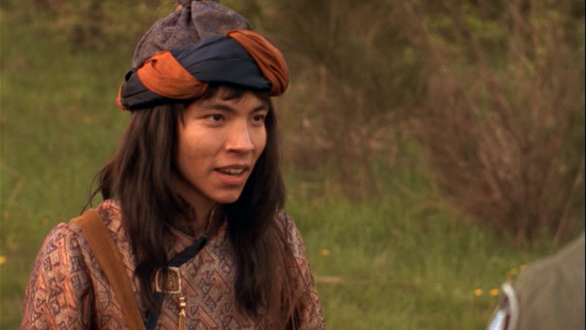

I'd also include some sort of noise removal, and even though it's a de-interlacer, QTGMC is quite good at cleaning up DVD video if you use it in progressive mode. There's two samples below. One without QTGMC denoising and one with it. I'm pretty sure Hybrid includes QTGMC, but once again I don't know how to change Hybrid's options. I also cropped and resized the samples using the CropResize script in my signature.
mpeg2source("D:\01x04 Emancipationtester (1)muxer.d2v")
TFM(Metric=1, MI=40)
TDecimate()
Vinverse()
QTGMC(InputType=1, EzDenoise=1.5) # only added for sample 2
CropResize(832,468, 4,0,-4,0, InDAR=16.0/9.0)Last edited by hello_hello; 2nd Apr 2021 at 04:17.
Avisynth functions Resize8 Mod - Audio Speed/Meter/Wave - FixBlend.zip - Position.zip
Avisynth/VapourSynth functions CropResize - FrostyBorders - CPreview (Cropping Preview) -
Thank you Hello_Hello sample 2 is what i looking for , now i have to see how translate this in hybrid ... i'm not very familiar with scrips...

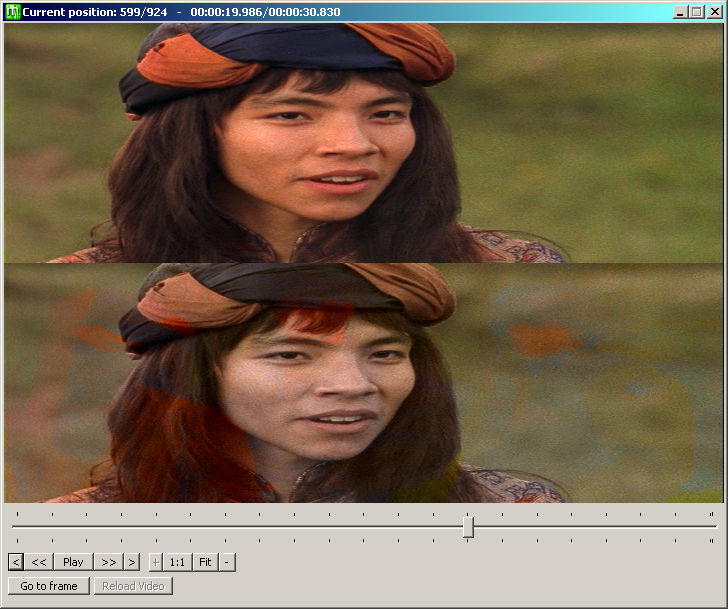

I am very close to sample2 but i have a kind of colour ghosting...
[Attachment 58138 - Click to enlarge] -
I noticed that and it's the chroma from one frame/field bleeding into another, for want of a better description. I don't know what causes it but I've seen it before. I don't think there's an automated way to fix it but someone else may know better. It only happens on some scene changes, and TFM/TDecimate is probably removing some of the bad frames as part of the IVTC process, but it's built into the actual fields.
If you compare the two screenshots below you can see the chroma from adjacent fields is somehow bleeding into each other (the bottom field in screenshot #1 and the top field in screenshot #2). The screenshots are from your sample, no filtering applied. Just the script below.

[Attachment 58141 - Click to enlarge]
[Attachment 58142 - Click to enlarge]
I can have a play with TFM settings to see if there's a way to prevent it from using those fields when field matching, or make it less likely, but depending on where they are in the telecine pattern it mightn't be possible. I probably won't get a chance to play around until tomorrow now, but I'll report back when I have, or maybe someone else will come along with a clever idea in the mean-time.Last edited by hello_hello; 30th Mar 2021 at 15:16.

Looking through the sample I uploaded I can only see one frame with chroma bleeding. The IVTC process seems to have removed the others. It's gone from your sample though, so if SRestore is fixing it, then whatever works, but can you post the script you used for that? I'm just curious to see what it is, as I was expecting problems such as the wrong frame rate due to using SRestore (because it's easy to go wrong if you don't know how to use it correctly), but it seems okay. There's still some minor combing but it's not as bad as your original screenshot.
I saw 4 shot changes with chroma blending. Depending on which field TFM() starts with (field=0, or field=1) you may get one or not at those shot changes. Using TFM().SRestore(frate=23.976) instead of TFM().TDecimate() can help eliminate them. You can also use QTGMC().SRestore(frate=23.976). Another trick I sometimes use is:

I hadn't realised until now, but TFM has two chroma options. One to determine whether chroma is used for field marching (enabled by default), and the other to determine whether it's used for combing detection. Enabling the latter option fixed three of the bad frames, but made the fourth one worse. I don't know why. Maybe it's some sort of anomaly, or maybe not, but for the attached sample I dumped that frame manually as I couldn't find a way to get TIVTC to remove it automatically.

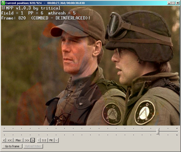

This works here:
Code:Telecide().TDecimate() #no color blending; skips/repeats frame instead QTGMC(InputType=3) #cleaning most of the residual combing

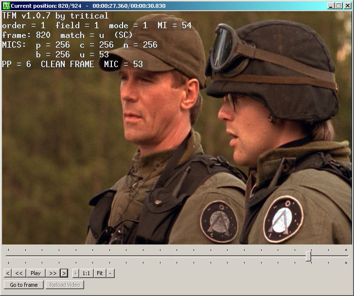

It never occurred to me to try a different field matcher, but based on that I went back to TFM again and discovered I was causing it to keep the fourth blended frame. I don't quite understand why increasing the combing sensitivity (reducing the MI or cthresh value) causes TFM to de-interlace a frame rather than use a different match, but it seems that's what was happening. For the first three problem frames, all that was needed was to enable chroma for combing detection, but for the fourth blended frame it seems the minimum MI value must be 54.
TFM(Metric=1, MI=53, chroma=true, display=true)
[Attachment 58150 - Click to enlarge]
TFM(Metric=1, MI=54, chroma=true, display=true)
[Attachment 58151 - Click to enlarge]
The metric used doesn't seem to make much difference in this case, although the metric from Telecide (Metric=1 for TFM) does seem to be better at detecting fine combing at times, so with these settings TFM should produce much the same result as Telecide.
TFM(Metric=1, MI=55, Chroma=true)
TDecimate()
Vinverse()
CropResize(832,468, 4,0,-4,0, InDAR=16.0/9.0)Last edited by hello_hello; 31st Mar 2021 at 11:44.

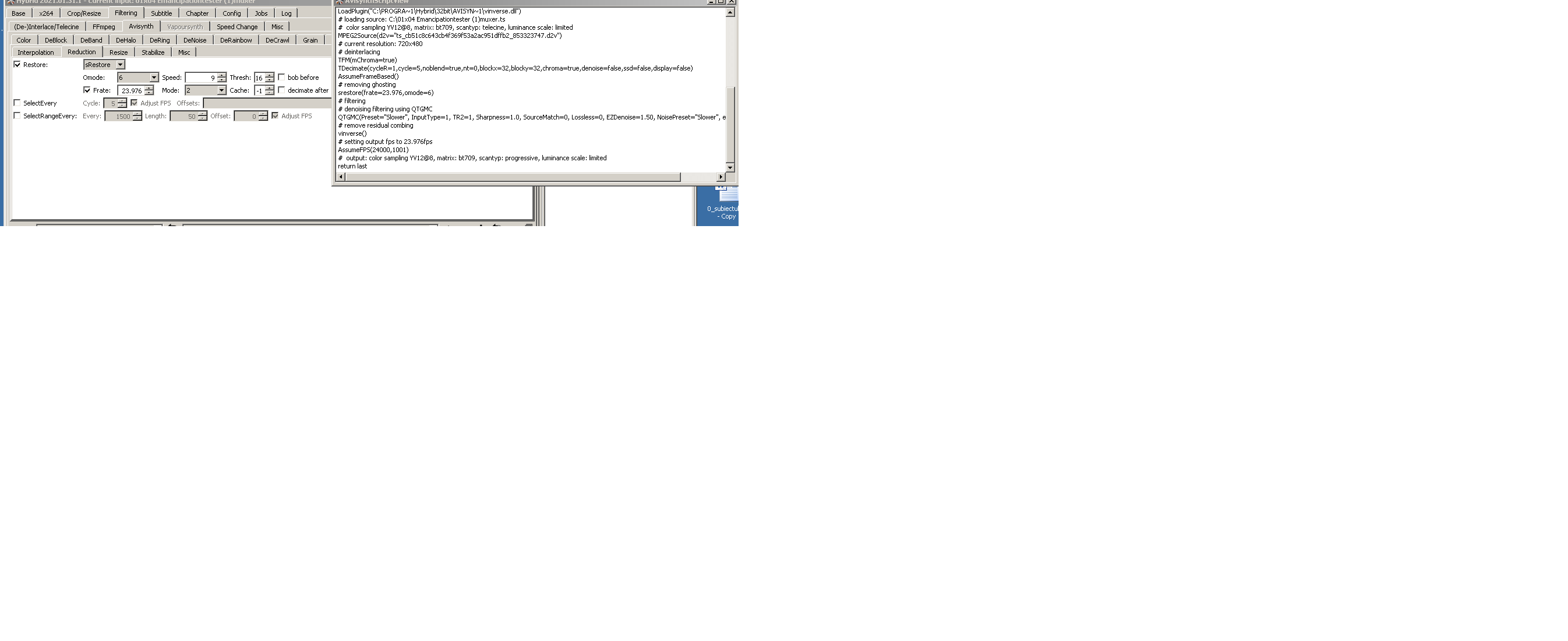

I try with telecide , decimate , vinverse, qtgmc and works , the ghosting is gone , but i have some artefacts ( same with first picture from first post ) with telecide default , where is m=1 and mi=55 in telecide settings , there is guide , gtresh , btresh , dtresh , ntresh , vtresh ... ?
[Attachment 58157 - Click to enlarge]Last edited by radusound; 31st Mar 2021 at 15:49.
I don't think there is a Metric argument for Telecide. You don't need it anyway as Metric=1 for TFM just tells TFM to use the same metric for combing detection as Telecide.
For TFM, MI is one of the arguments for adjusting the sensitivity of the combing detection. For Telecide, I think vthresh is the equivalent, but you may have to adjust it in combination with dthresh. I haven't used Telecide much so I'd simply be experimenting myself. I suspect though, if you set vthresh too low it might cause Telecide to keep some of the blended frames as setting MI too low does for TFM, so be careful there. Reducing vthresh should help Telecide detect more of the combing (as reducing MI does for TFM), but I suspect the result will be much the same. I also suspect the only reason Telecide does better with the blended fields by default is because chroma is enabled for combing detection by default, whereas for TFM it isn't. I haven't tried disabling chroma for Telecide to test that theory though.Last edited by hello_hello; 31st Mar 2021 at 15:52.
I try with vtresh=20(50 default) and seems to help a bit and dtresh=7(default). For dtresh i just don't know which value to try....
