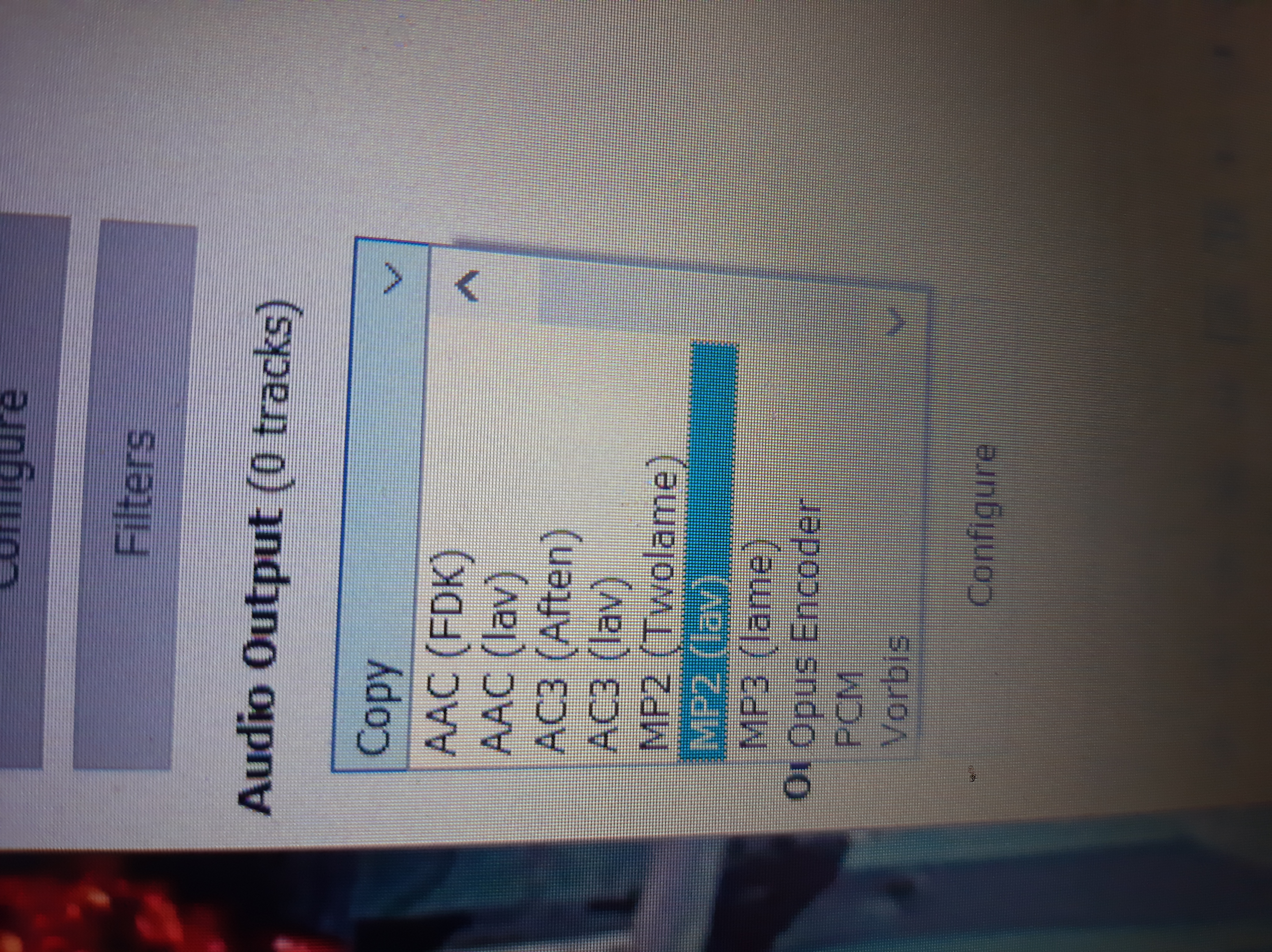

    F6Image
    [Attachment 57947 - Click to enlarge]
    LAC and ALAC are lossless audio compression formats, it doesn't get better than lossless.
    Also a picture to show you all the audio formats, ps: pcm doesn't work I already tried.
  16. Okay then use vorbis or aac, later is probably wider supported on hardware players.

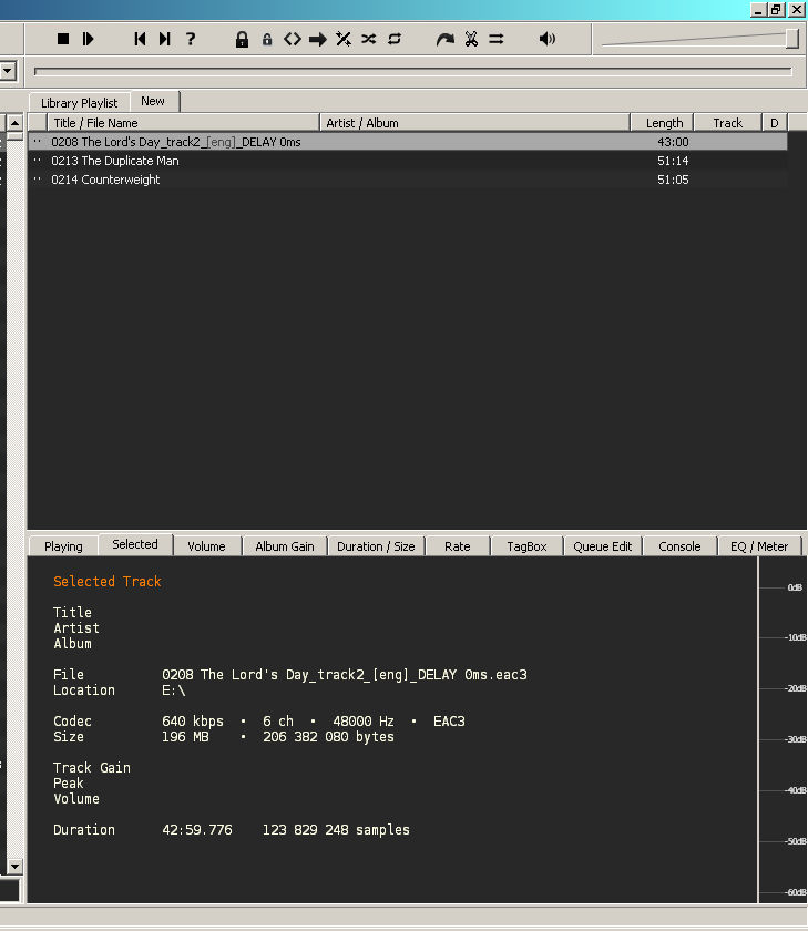

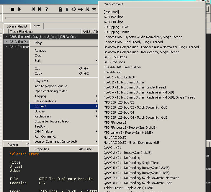

  27. Noob_1,
    Try this portable version of Foobar2000. Just unzip it somewhere. foobar2000 1.5.3 Portable.zip
    It comes with all the goodies most people need for re-encoding audio, except ffmpeg. There's a text file included with instructions on where to put ffmpeg and it also explains where to set a few file paths in fb2k's preferences, if necessary. It's been a fair while since I uploaded it but I don't think there's much to do to get it working and then you can convert almost anything to anything, and there's plenty of conversion presets to get you started. You can convert the audio in many container types (mp4, mkv etc) without having to extract it first, even if the file also includes video. If you do that though, you should check for any container audio delay yourself if necessary. There's also DSP presets for compressing & downmixing etc.
    My foobar2000 configuration looks like this running on XP (it's actually an audio player but it's also a pretty good converter). You have to mux the new audio with the video yourself, but that's easy for MKVs. MKVToolNix is very versatile. There's no need to import files one at a time either. Just load all the audio into a playlist and FB2K can convert as many simultaneously as you have CPU cores, or it can convert to multiple audio formats at the same time.
    [Attachment 58294 - Click to enlarge]
    [Attachment 58295 - Click to enlarge]
