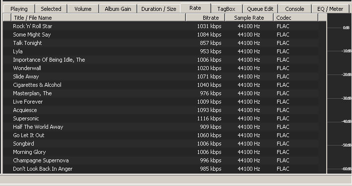

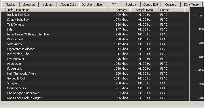

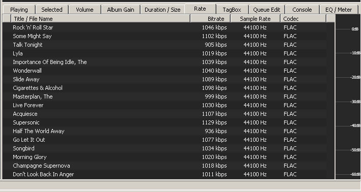

I assume it's because lossy codecs throw stuff away and therefore FLAC doesn't have to compress it.
Two CDs worth of bitrate.
FLAC to FLAC.
[Attachment 57329 - Click to enlarge]
FLAC to MP3 to FLAC.
[Attachment 57330 - Click to enlarge]
FLAC to AAC to FLAC.
[Attachment 57331 - Click to enlarge]Last edited by hello_hello; 12th Feb 2021 at 19:09.
