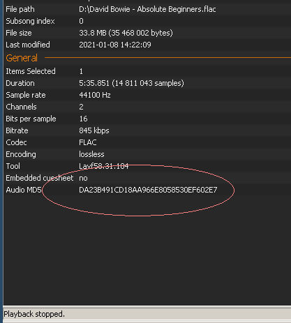

  6. As Zing explained, the compression setting for flac just effects the output file size, not the quality. In fact when the audio is encoded, there's a checksum calculation saved to the new file for Flac and WavePack (it's also lossless). If there's nothing touching the audio in the conversion chain (no DSPs or volume change etc) you can convert between flac and wavepack and flac and wave files and flac and flac all day long, and the checksum shouldn't change, even if you change the flac compression.
    If you happen to have the fb2k "Selection Properties" UI element included in the GUI somewhere, it can display the checksum.
    [Attachment 56679 - Click to enlarge]
    Anyway, I described the conversion from flac to flac while changing the volume as maybe not being "technically" lossless, because the audio won't be exactly the same due to the volume change, and the checksum will change too, but flac encodes the audio you send it losslessly, so I guess I was just being pedantic about how I described it.
