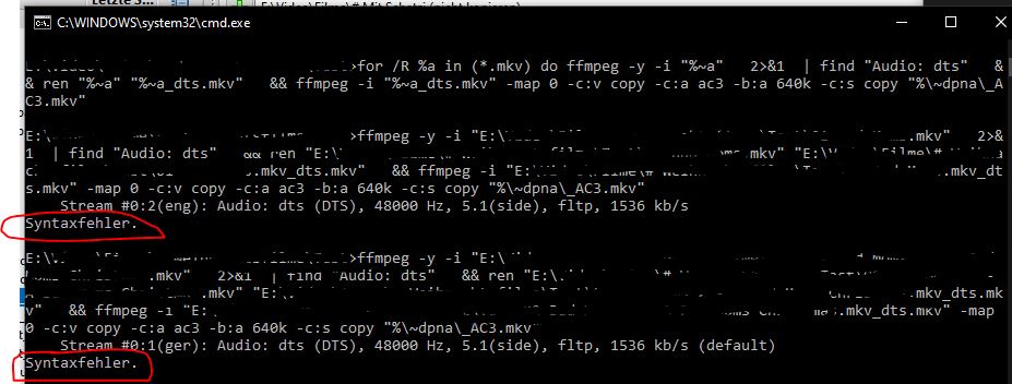

  10. This is the last error message.
    [Attachment 56385 - Click to enlarge]
    I try it with this
    for /R %%a in (*.mkv) do ffmpeg -y -i "%%~a" 2>&1 | find "Audio: dts" && ren "%%~dpna" "%%~na_dts.mkv" && ffmpeg -i "%%~a_dts.mkv" -map 0 -c:v copy -c:a ac3 -b:a 640k -c:s copy "%%\~dpna\_AC3.mkv"
    And then I get: The system cannot find the specified file.
  11. My edit and your post overlapped. Try again with my updated version.
  12. Thats the perfect code. Thanks for all.
