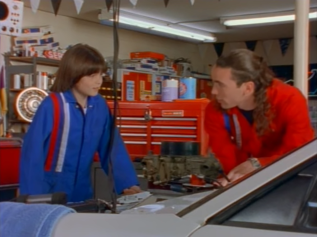

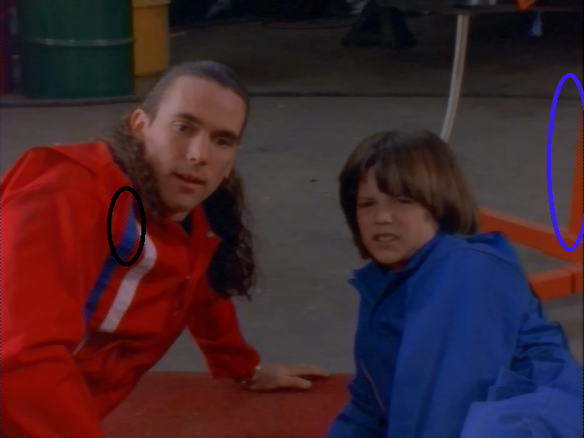

So finally I decided to check at least one rough time to see whether there is scene that should be run with pp=0 or manual IVTC and it works perfectly. Both of you really help me through. Hello_hello is right i have come across with another "problem" again. can you help me this Again but this time,its the jittery electrical lines.m2v Big thanks to you 2
Wow it actually does looks great. Now i understand how to use it. But I am confused about something. I realized that I can't do a proper encoding without even a single look at the video and the code looks like this
As you can see, they use different types on various part of the video. You didnt talk about using FPSDivisor with pp=0 function. If i were to add that line, where is the best place to add?Code:LoadPlugin("C:\Users\GL62M 7RDX.000\Downloads\MeGUI-2828-32\tools\dgindex\DGDecode.dll") DGDecode_mpeg2source("F:\Turbo\PR_TURBO_S5D3\VIDEO_TS\PR_TURBO_S5D3_VTS_08_1.d2v", info=3) m1=TFM(pp=5).TDecimate() m2=TFM(pp=0).TDecimate() ship=QTGMC().srestore(23.976) TFM() TDecimate() ReplaceFramesSimple(last, m1, Mappings="[3023 3120]") ReplaceFramesSimple(last, m2, Mappings="[1205 1302][1465 1563][5484 5641][10538 10573][10929 10959][11041 11116][11211 11240][11361 11416][11615 11655][11715 11758][12407 12467][12811 12879]") ReplaceFramesSimple(last, ship, Mappings="[12115 12406][12468 12810][12932 13002][13043 13115][13292 13349][13438 13498][13591 13654][13712 13751]") Deblock(quant=18, aOffset=0, bOffset=0) crop(8, 0, -6, 0) dfttest(sigma=12, tbsize=3) LSFMod(Strength=60) LanczosResize(640,480) op=crop(2, 0, 0, 0).LanczosResize(640,480) c1=crop(0, 2, 0, 0).LanczosResize(640,480) ReplaceFramesSimple(last, op, Mappings="[2450 2468]") ReplaceFramesSimple(last, c1, Mappings="[7060 7112]")

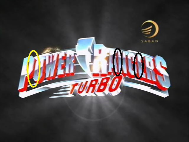

problem after problem. I dunno how to remove them.
[Attachment 56455 - Click to enlarge]
I tried using nnedi3(), Santiag() and DeHalo_alpha(rx=3.0, ry=3.0) but didnt fix the problem.
hexagonal edges around the logo.demuxed.m2v
[Attachment 56457 - Click to enlarge] -

Can you suggest specific one for this type of video?"hexagonal edges" Those are dot crawl artifacts. There are several dot crawl removers for AviSynth.
Thanks both of you for everything and Happy New Year (Stay Safe)
Try CheckMate. For example, CheckMate(thr=10, max=20, tthr2=0). And try increasing tthr2 (10? 20? more?) -- but too high will cause ghosting.

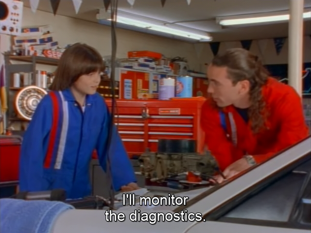

After running through the Checkmate and Maa, I encoded and found out this.
[Attachment 56581 - Click to enlarge]
this 1st pic is from encoded
[Attachment 56582 - Click to enlarge]
this 2nd one is from avspmod preview. I click save image as button from the preview.
the edges look clean. Did encoding wear off the detail? -
help post 33.
It looks to me like you encoded interlaced. After deinterlacing or IVTC your video is progressive. So encode progressive.

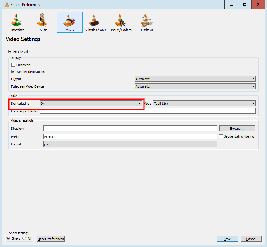

But I use that .avs file to encode, the above picture is how it looks in preview tab. I did run TFM() TDecimate() like Hello_hello say. -
Do you have deinterlaced force on? Set it to Auto.
[Attachment 56608 - Click to enlarge] -
Yeah... the movement's so fast it's possibly not easy to see the difference, but I dropped the ball there.

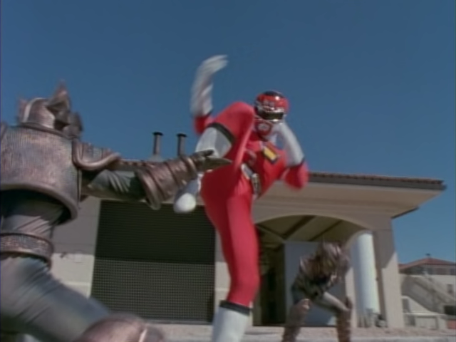

Ok nevermind about the post 56. Another problem pops up.
[Attachment 56978 - Click to enlarge]
I have already applied checkmate() and it doesnt change.
