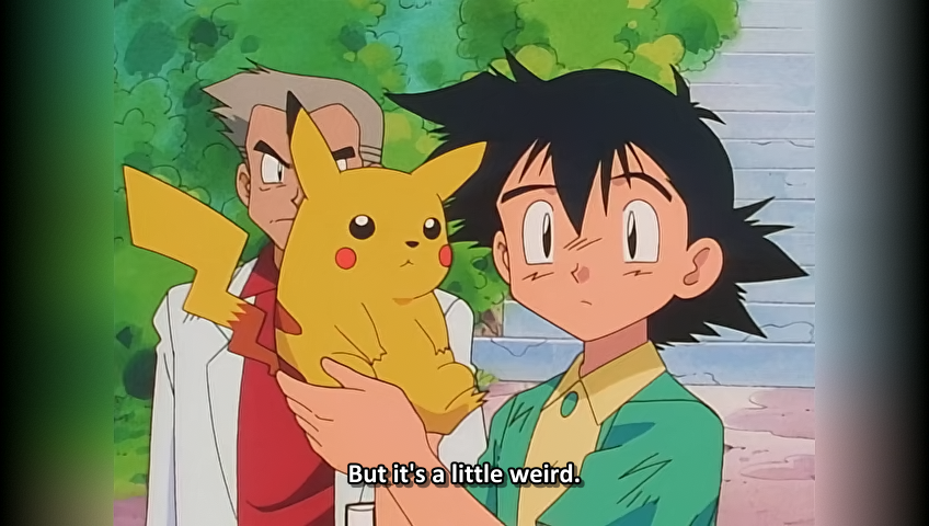

  6. I believe i did it right:
    src = potplayer_source()
    Crop(src, 8,0,-8,-0) # assuming ITU cap
    Overlay(FastBlur(8, iterations=3, dither=yes).Spline36Resize(src.width,src.height).ColorYUV(gain_y=-50).AddGrain(var=2.0), Spline36Resize(width*3/4, height), x=(width-(width*3/4))/2, y=0)
    float(src.width)/float(src.height) < 1.77 ? last : src
    Would donescaling, use Fastblur, and upscaling help with the blocking/posterization?
    And if so, would you happen to have an idea how to implement this in this script?
  7. Downscaling-blurring-upscaling is used to produce the fuzzy left/right edges. Is that where you are seeing blocking and posterization? If you have a blocky posterized source you need to deal with it before adding fuzzy borders. Maybe with deblock_qed and GradFun3. Using a less sharp resizer like BilinearResize for the second argument (the unfuzzed part of the image) may help too (sharp resizers like Spline36 enhance block edges).
  8. The sources are dvd remuxes of cartoons, i just want the smoothes blur and grain on the left and right side as possible.
    i think what i have now is already great, but i would like to know if Downscaling-blurring-upscaling would take it even further.
    or changing Spline36Resize for BicubicResize like butterw suggested would make a difference.

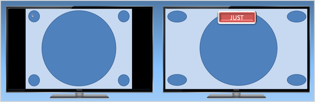

  17. The best aspect ratio is stretch video to fullscrImage
    [Attachment 71086 - Click to enlarge]een and shrink the sides . like this
    Can anyone make a just aspect ratio like the one on Panasonic tvs , pixel shader hsl that works with potplayer / mpc
    Can you make a just aspect ratio like the one on Panasonic tvs
    It stretches only the edges , the center of the image remains fullscreen in correct aspect ratio and you view the entire image without losing parts of the picture as in your stretch by keeping aspect ratio
    Format JUST - Justifies the image by stretching it to the four corners on the screen. The middle of the image stays almost the same shape, however the sides of the image are stretched or shrunk more. This is recommended when you do not want to have black bars.Image
    [Attachment 71087 - Click to enlarge]
    it would be the same for 21:9 except the edges shrink instead. so its fullscreen stretch then shrink the side edges

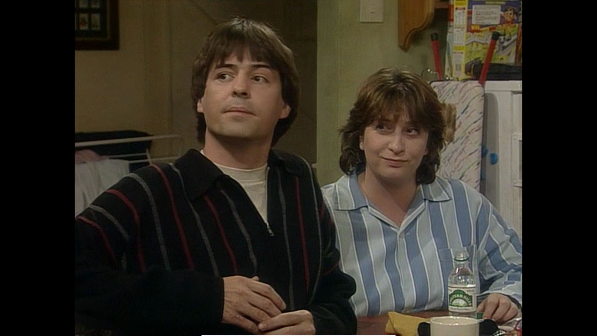

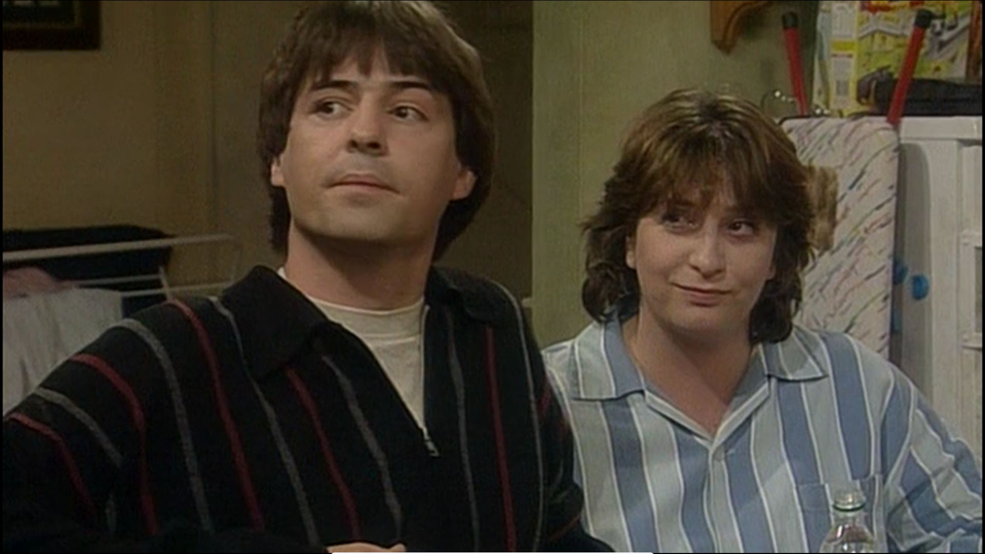

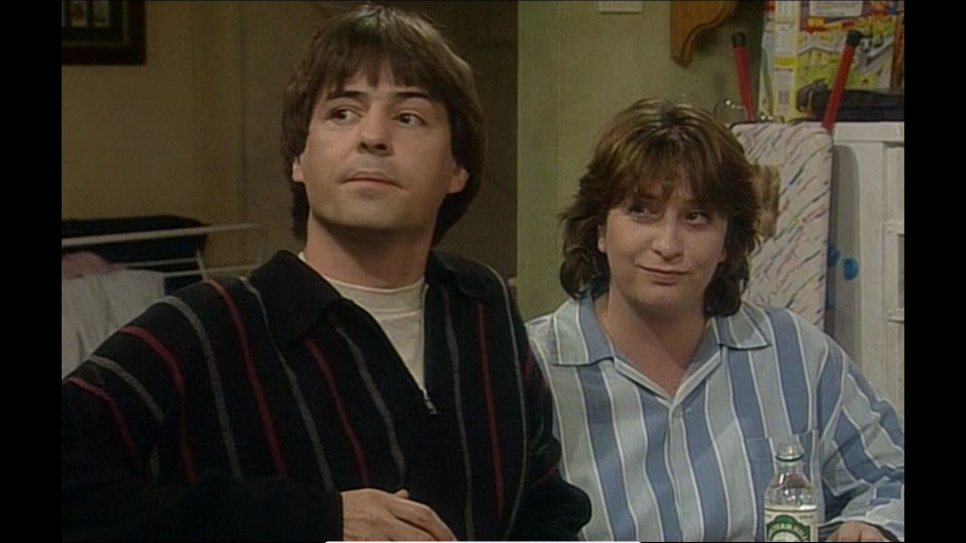

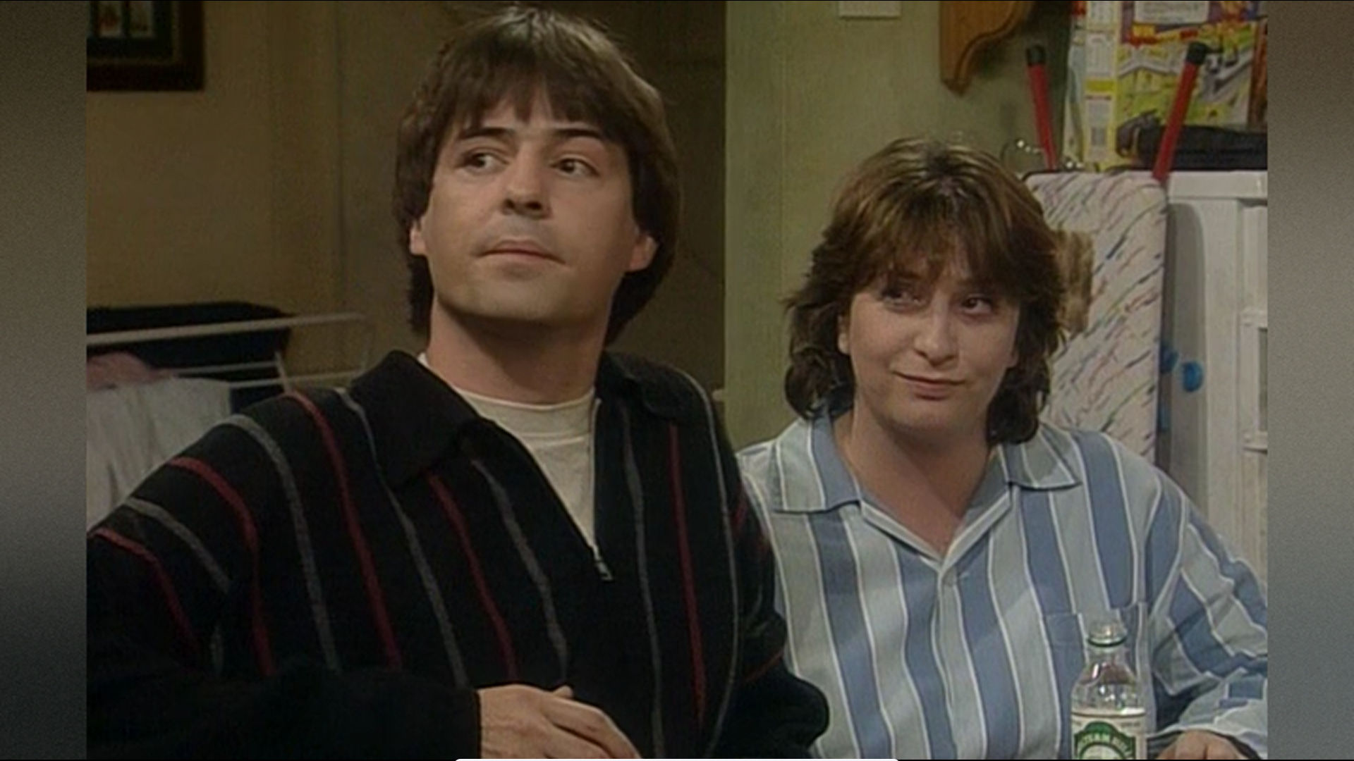

  30. For 4:3 it's usually better not to crop the top and bottom evenly (when zooming in) because the important stuff tends to be centered above the middle of the frame. Doing it manually with MPC-HC I'd generally zoom in with the "9" key until the borders are gone, then tap the "2" key 9 or 10 times while holding down Ctrl to move the picture down.
    There's a script below for ffdshow's Avisynth filter that does much the same thing. It should work in Potplayer's Avisynth filter too, although apparently even Potplayer still only supports 8 bit video for it's Avisynth filter. Instead of using the FrostyBorders function to do the work it uses CropResize, but both scripts can add plain black borders instead of frosty ones.
    The stuff that has to be added to ffdshow's Avisynth filter lets you set a range between which no borders are added and the function simply crops to 16:9 (the default range is 1.75 to 1.79) and you can also set a minimum and maximum aspect ratio according to the size of the borders you can tolerate before the script starts cropping picture. The defaults are 1.55:1 to 2:1. If the script has to crop picture from the height, one third of whatever it crops is cropped from the top and two thirds from the bottom. The sides are always cropped equally.
    The defaults for a 4:3 video on a 16:9 display look like this (ignore the few grey lines bottom/centre, it's just VirtualBox's toolbar not hiding completely).
    Original 4:3 (full screen)
    [Attachment 71505 - Click to enlarge]
    Minimum DAR 1.55
    [Attachment 71506 - Click to enlarge]
    Minimum DAR 1.55 with default FrostyBorders
    [Attachment 71507 - Click to enlarge]
    Increasing the minimum DAR to 1.77
    [Attachment 71508 - Click to enlarge]
    The function for ffdshow is below (it has to be in the plugins folder along with CropResize). The stuff that needs to be copied and pasted into ffdshow's Avisynth filter is at the top of the script. Post #2 in the FrostyBorders thread has instruction for installing just the ffdshow raw video filter and adding it to MPC-HC, if you prefer that to a full ffdshow install.
