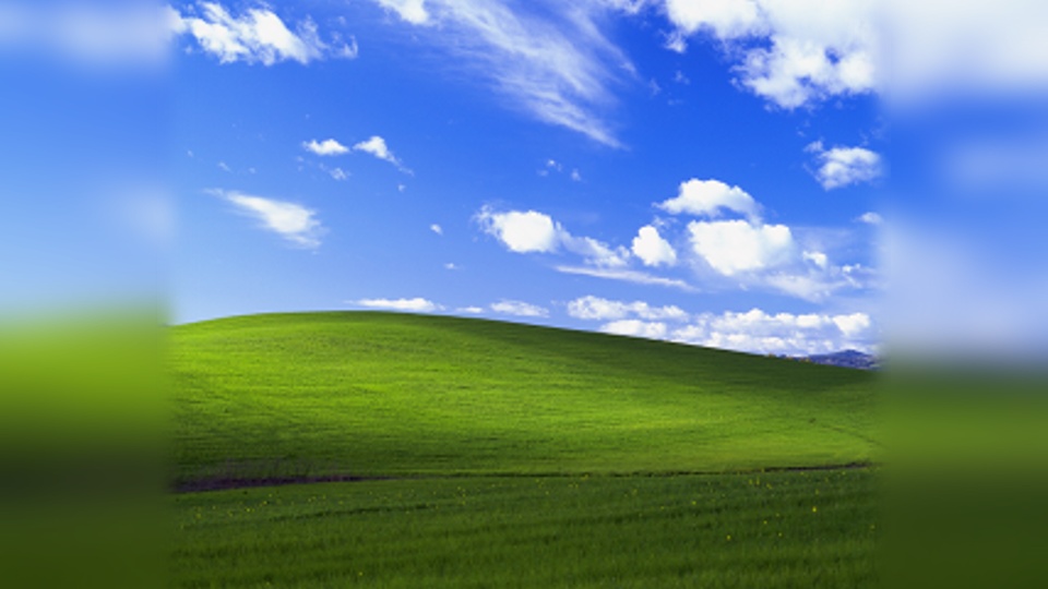

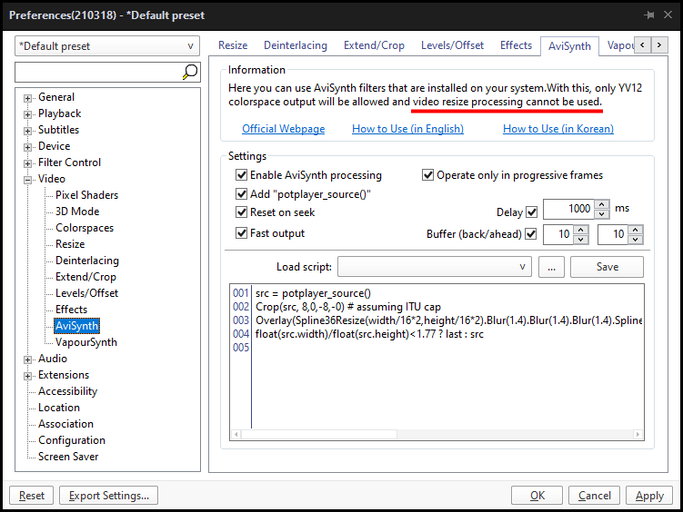

  1. Originally Posted by jagabo View Post
    PotPlayer won't let an AviSynth script change the frame size internally. If the script enlarges the frame horizontally you will only see the left portion of the frame.
    Bummer.
    So why do your earlier screenshots look okay, with borders each side as expected?

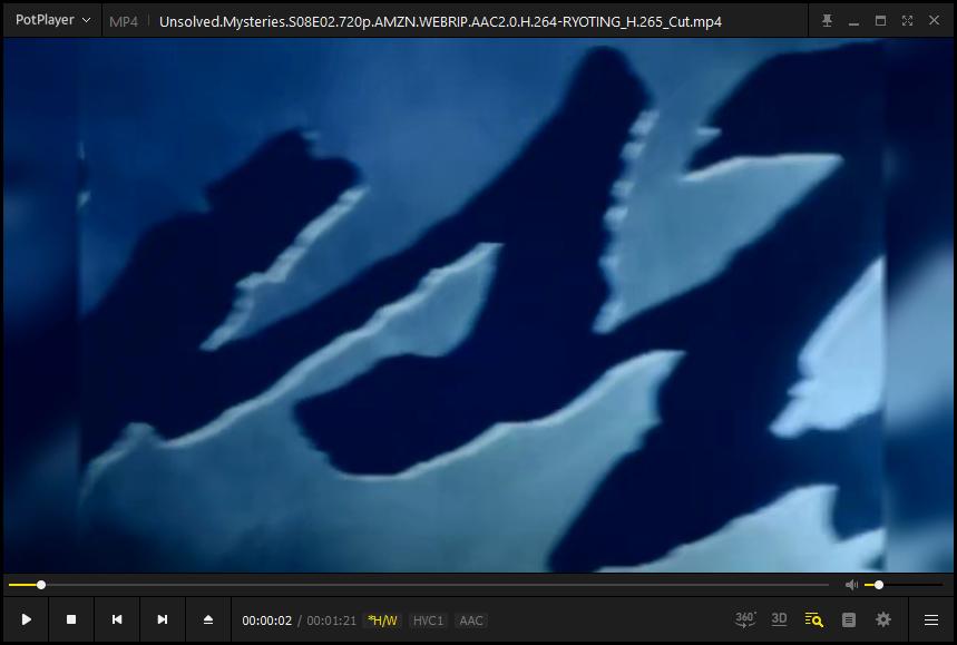

  2. It says so right on the dialog:
    [Attachment 58542 - Click to enlarge]

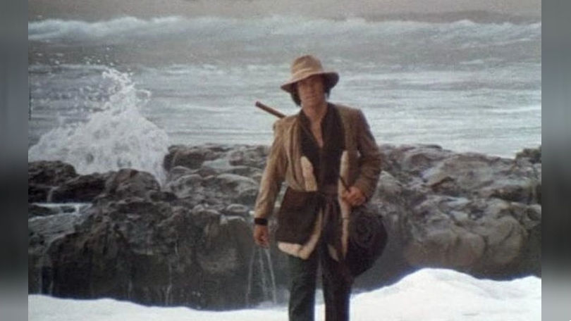

  4. Originally Posted by jagabo View Post
    I still like your script the best! With that being said, is it possible to have your script zoom into the video? Like hello_hello suggested below?
    ImageSource("D:\script.jpg")
    ConvertToYV12()
    CropResize(704,468, 0,0,0,-32)
    CropResize(832,468, NoResize=true, Borders=true, Frosty=true)
    Or does that fall into the same limitation you described that potplayer has?
    I have saved a custom frame size preset in potplayer, but it would be nice if I could have it changed automatically. My desired outcome would be something like pictured below.

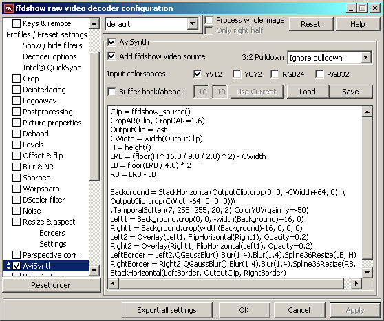

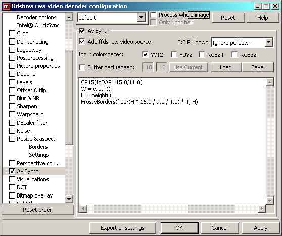

  5. Here's how to make FrostyBorders work with Potplayer.
    - Install the ffdshow raw video decoder. You can install all the ffdshow goodies, but the raw video decoder is all that's needed.
    - Add it to Potplayer as an external filter. Set it to "prefer".
    - Double click on the filter to open it's configuration.
    - Now it works.

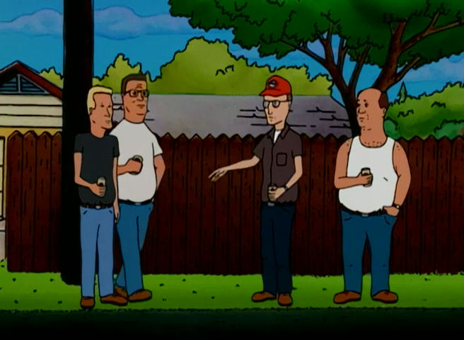

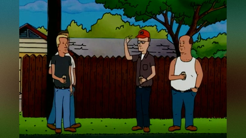

    [Attachment 58547 - Click to enlarge]
    [Attachment 58548 - Click to enlarge]
    Original
    [Attachment 58549 - Click to enlarge]
  7. I tried using what you just posted, but I get this error.
    I saved
    function CR15(clip Source, \
    int "OutWidth", int "OutHeight", \
    int "CL", int "CT", int "CR", int "CB", val "CropDAR", int "CSplit", bool "CAlign", \
    bool "AutoC", int "CThresh", int "CStart", int "CSample", \
    int "CPreview", int "CLine", \
    val "InDAR", val "InSAR", val "OutDAR", val "OutSAR", bool "AutoAspect", \
    int "Mod", int "HMod", \
    bool "NoResize", bool "ResizeWO", \
    bool "Borders", bool "CleanBorders", val "BColor", bool "Frosty", \
    int "ColorCorrect", string "ColorMode", string "Resizer", int "GMode", bool "RMode", \
    int "PicDim", bool "Position", bool "Info")   {
    Source_Width = width(Source)
    F_Source_Width = float(Source_Width)
    Source_Height = height(Source)
    F_Source_Height = float(Source_Height)
    CL = default(CL, 0)
    CT = default(CT, 0)
    CR = default(CR, 0)
    CB = default(CB, 0)
    CR = (CR == 0) ? 0 : (CR < 0) ? CR : CR - Source_Width + CL
    CB = (CB == 0) ? 0 : (CB < 0) ? CB : CB - Source_Height + CT
    CropDAR = default(CropDAR, 1.5)
    InDAR = default(InDAR, 0.0)
    InSAR = default(InSAR, 0.0)
    Mod = default(Mod, 4)
    HMod = default(HMod, 4)
    Borders = default(Borders, false)
    F_Cropped_Source_Width = F_Source_Width - CL + CR
    F_Cropped_Source_Height = F_Source_Height - CT + CB
    Cropped_Source_StorageAR = F_Cropped_Source_Width / F_Cropped_Source_Height
    Cropped_Source_DAR = (InDAR > 0) ? \
    F_Cropped_Source_Width * F_Source_Height * InDAR / F_Cropped_Source_Height / F_Source_Width : \
    (InSAR > 0) ? F_Cropped_Source_Width * InSAR / F_Cropped_Source_Height : Cropped_Source_StorageAR
    CB = (Cropped_Source_DAR >= 1.5) ? CB : CB - (floor(F_Cropped_Source_Height * 0.02) * 2)
    CropResize(Source, OutWidth, OutHeight, CL, CT, CR, CB, CropDAR, CSplit, CAlign, AutoC, CThresh, CStart, \
    CSample, CPreview, CLine, InDAR, InSAR, OutDAR, OutSAR, AutoAspect, Mod, HMod, NoResize, ResizeWO, \
    Borders, CleanBorders, BColor, Frosty, ColorCorrect, ColorMode, Resizer, GMode, RMode, PicDim, Position, Info)   }
    to a .avsi and placed it in C:\Program Files (x86)\AviSynth+\plugins
    and I put
    CR15(InDAR=15.0/11.0)
    W = width()
    H = height()
    FrostyBorders(floor(H * 16.0 / 9.0 / 4.0) * 4, H)
    in FFDSHOW raw video decoder.

  12. Here's another border idea for you.
    function QGaussBlur(clip v)   {
    return v\
    .BilinearResize(max(16, floor(float(width(v)) / 100.0 / 2.0) *2), max(16, floor(float(height(v)) / 100.0 / 2.0) * 2))\
    .GaussResize(v.width, v.height, p=19)   }
    Clip = ffdshow_source()
    CropAR(Clip, CropDAR=1.6)
    OutputClip = last
    CWidth = width(OutputClip)
    H = height()
    LRB = (floor(H * 16.0 / 9.0 / 2.0) * 2) - CWidth
    LB = floor(LRB / 4.0) * 2
    RB = LRB - LB
    Background = StackHorizontal(OutputClip.crop(0, 0, -CWidth+64, 0), \
    OutputClip.crop(CWidth-64, 0, 0, 0))\
    .TemporalSoften(7, 255, 255, 20, 2).ColorYUV(gain_y=-50)
    Left1 = Background.crop(0, 0, -width(Background)+16, 0)
    Right1 = Background.crop(width(Background)-16, 0, 0, 0)
    Left2 = Overlay(Left1, FlipHorizontal(Right1), Opacity=0.2)
    Right2 = Overlay(Right1, FlipHorizontal(Left1), Opacity=0.2)
    LeftBorder = Left2.QGaussBlur().Blur(1.4).Blur(1.4).Spline36Resize(LB, H)
    RightBorder = Right2.QGaussBlur().Blur(1.4).Blur(1.4).Spline36Resize(RB, H)
    StackHorizontal(LeftBorder, OutputClip, RightBorder)
    [Attachment 58566 - Click to enlarge]
    [Attachment 58567 - Click to enlarge]
  13. Here's my script modified to accept a zoom value:
    uncropped = potplayer_source()
    src = uncropped.Crop(8,0,-8,-0)
    ZOOM = 1.167
    Spline36Resize(src, int(uncropped.width*ZOOM)/2*2, int(uncropped.height*ZOOM)/2*2)
    Crop(0, (height-src.height)/4*2, -0, src.height)
    bg = Spline36Resize(width/16*2,height/16*2).Blur(1.4).Blur(1.4).Blur(1.4).Spline36Resize(uncropped.height*16/18*2,uncropped.height).ColorYUV(gain_y=-50)
    Overlay(bg, last, x=(bg.width-width)/4*2, y=0)
    Spline36Resize(uncropped.width, uncropped.height)
    float(uncropped.width)/float(uncropped.height) < 1.77 ? last : uncropped
    You can change the zoom value. For non-anamorphic 4:3 videos a zoom value of 1.0 is equivalent to my original script. 1.333 is fully zoomed (and cropped, no borders). 1.167 is about half way in between. As with the original script, you must force PotPlayer to a 16:9 aspect ratio.

    Since you seem to be so familiar with AVIsynth would you be able to tell me if feathering the borders of the video is possible?
    I've attached two pictures. The first picture is how your script acts now. The second one is what I'm referring to in my question.
Name:	current script.jpg

    Been using your updated script for 2 weeks, and love it. Although, I came across some videos that the script does not seem to work with. The video is under the frame size constraint you gave it float(uncropped.width)/float(uncropped.height) < 1.77 ? last : uncropped and it is 4:3 but I do not understand why the script is bypassing the video.
    I have posted the actual video along with the media info. I hope someone could help me with this.

  22. It's working here.
    [Attachment 58831 - Click to enlarge]
    In case my version has changed, cut and past from PotPlayer:
    ZOOM = 1.167
    alpha = Overlay(BlankClip(last, color=$000000), BlankClip(last, color=$ffffff).Crop(16,0,-16,-0), x=16, y=0).ColorYUV(cont_y=50).PointResize(width/16*2, width).BilinearResize(width,height)
    Overlay(bg, last, x=(bg.width-width)/4*2, y=0, mask=alpha)

    I'm assuming it's not possible to have your script recognize 4x3 videos in 16x9 resolutions(like the sample provided), and have it applied to them. Perhaps you already addressed not being able to in your earlier posts. I did see your post and the screenshot that showed the message in potplayer
    "Here you can use avisynth filters that are installed on your system. With this, only YV12 colorspace output will be allowed and video resize processing cannot be used."
    If that is the case, can you remove the framesize restriction and have your script apply even to widescreen videos? I will just have to switch between Scripts when I come across a video like I mentioned above.
    I am not familiar with scripting in general, and I try my best to understand, and update your script without having to bother you...
    This is my current script, which uses yours and some ideas from hello_hello

    I originally wrote the script assuming a pillarboxed 4:3 video in a 16:9 frame (without auto-detection). But realized later that the OP wanted it to work with 4:3 sources and changed the script. Given I hate the entire concept I'm not inclined to recreate it.
    No, the frame size cannot be changed. Actually, the script can resize the frame but PotPlayer will not display it properly. If the frame is enlarged PotPlayer will only show the top left corner of that larger size. If the frame is shrunken Potplayer will show the smaller frame in the top left corner.
    which value is responsible for being able to Increase the feather effect? I wish to have the feathered area increase.
    In the "alpha =" line change "PointResize(width/16*2, width)". Instead of 16 use a bigger number, to get a wider feather, and use BilinearResize instead of PointResize.
    alpha = Overlay(BlankClip(last, color=$000000), BlankClip(last, color=$ffffff).Crop(16,0,-16,-0), x=16, y=0).ColorYUV(cont_y=50).BilinearResize(width/24*2, width).BilinearResize(width,height)
  30. I'm trying to get butterw's fill_bb.avs script to work on PotPlayer but i can't get it to work. I tried replacing the src with potplayer_source() but all i get is a very zoomed in picture with a blur and grain. Can somebody help me with this? Thanks!
