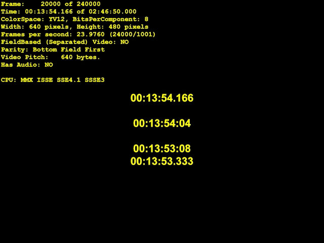

Avisynth says.....
frame 20000 at 24000/1001 fps.
Top: Human time (milliseconds)
Middle: SMPTE drop-frame timecode
Bottom: SMPTE non drop frame
BlankClip().killaudio().Loop(1000)
AssumeFPS(24000,1001)
Info()
ShowTime(y=200)
ShowSMPTE(y=250)
AssumeFPS(24)
ShowSMPTE(y=300)
[Attachment 55900 - Click to enlarge]Avisynth functions Resize8 Mod - Audio Speed/Meter/Wave - FixBlend.zip - Position.zip
Avisynth/VapourSynth functions CropResize - FrostyBorders - CPreview (Cropping Preview) -
Thanks hello_hello for running the numbers.
Glad to see the "Human time" confirmed. However, 00:13:54:04 coming out as "drop-frame" timecode adds to my confusion, TBH.
Is the "drop-frame" timecode the same as "Human time" then (other than the last frames are written in frames in stead of milliseconds)? -

Getting back to basics: your material does have an actual number of frames. In order to do the timecode > frame number calculation properly you need to determine the time base of the specific material you are working with. Using milliseconds (what you are calling human time) is interesting but is only a distraction from the math problem at hand.
It's 13 minutes, 54 seconds, plus four more frames.
A colon means frame numbers at the end. ie 13:54:04
A dot means milliseconds. ie 13:54.166
At the 20,000 frame mark, SMPTE would be about 0.2ms off..... I think.....
From memory....
NTSC doesn't display a whole number of frames each second, so you can't count the frame numbers after "seconds" and have them "line up" for want of a better description. Back when the frame rate was 30fps there was, naturally, a whole number of frames every second, but after the change to 29.97fps, the solution was to ignore the frame rate difference and keep counting at 30fps (or 24fps as the case may be). To keep it accurate in relation to human-time, SMPTE drop frame timecode counts frames at 30/24fps most of the time, but every now and then it only counts 29 or 23 frames in a second. I can't remember how often. It's not frames being dropped though, it's their timecodes.
If it helps..... and I'm already confusing myself thinking about this..... I've added another time to the pic. It's the bottom one. It's people-time, but counting at the same incorrect rate as the non drop frame timecode immediately above it (24fps).
[Attachment 55905 - Click to enlarge]
Non drop frame SMPTE timecode counts all the frames and slowly goes out of sync with people-time because it's counting them at a slightly incorrect rate (assuming it's 23.976 or 29.97fps).
I just navigated to a specific frame (frame number 20,000) and told Avisynth to display the timecodes (at 23.976fps).
The calculator only displays SMPTE time, so you can either navigate to a specific frame number, or to a specific SMPTE timecode, but it does appear to be getting the calculation wrong. That's what Ennio was wanting to do. Enter a frame number and find the corresponding timecode. Personally, I'd rather work in human-time, but that's just me.Last edited by hello_hello; 18th Nov 2020 at 18:54.

Here's what Avisynth says for frame number 20,000:
I assume the TcCalc equivalents are these (minus 29.97 NDF)Code:30 00:11:06:20 29.97 NDF 00:11:06:20 29.97 DF 00:11:07:10 25 00:13:20:00 24 00:13:53:08 23.976 NDF 00:13:53:08 23.976 DF 00:13:54:04
So if I've got that correct it's still the "23 TT" calculation I don't understand. At frame number 2,000 it's only 1 frame behind what Avisynth reports, but by frame 20,000 it's behind by 4.Code:NDF 30 00:11:06:20 DF 29.97 00:11:07:10 25 00:13:20:00 24 00:13:53:08 23.8 00:13:53:08 23 TT 00:13:54:00

Don't mix 32 bit and 64 bit. You want to install the 32 bit version of Avisynth, open scripts with 32 bit VirtualDub, and use grunt.dll from the x86 folder in the zip file etc. Or use 64 bit versions of everything.
If you put the files in the same folder that should work as- is, otherwise you'll probably need to specify full paths.
Import("D:\Some Folder\Another Folder\TimeCodes.avs")
Anyway, put the avs files and grunt.dll in the same folder, copy the above into Notepad and save it with an avs extension to the same location (t doesn't matter what you name it), then try opening it with Virtualdub or something......
That should get you started without too much trouble. The timecodes are displayed over a blank clip, but you can add the function to a script decoding video the same way. Sorry if I've been stating the obvious at you, but I'm not sure if you're an Avisynth user.
Edit: To be clear.... install Avisynth+, not classic Avisynth. The latter has been abandoned.
https://www.videohelp.com/software/AviSynth-PlusLast edited by hello_hello; 22nd Nov 2020 at 16:38.
