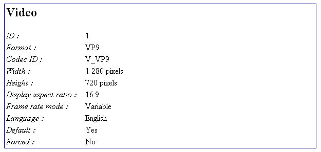

    Originally Posted by Ennio View Post
    @ hello_hello: how did you know the video was vfr? MediaInfo doesn't state such?
    It does for me. I'm using HTML view, but I think any view other than Basic should show it.
    The original MKV:
    [Attachment 55733 - Click to enlarge]

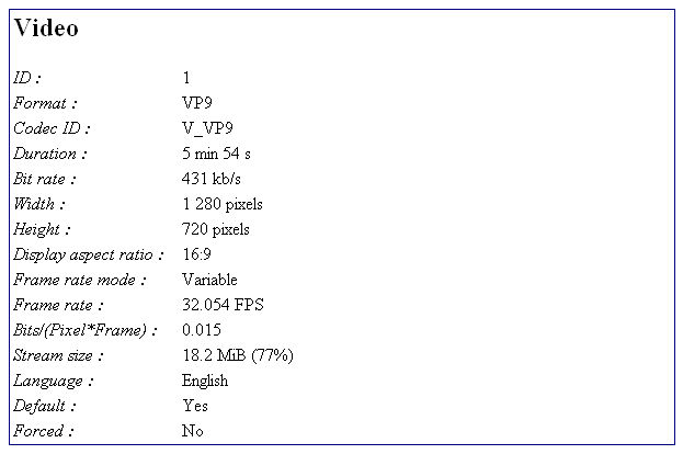

    After remuxing with track statistic tags enabled (I normally disable them, but they're enabled by default). The frame rate shown is the average frame rate, as far as I know.
    [Attachment 55734 - Click to enlarge]
    I double checked by extracting the video timecodes file. They're usually rounded to the nearest millisecond for frame rates where frames don't display for a multiple of whole milliseconds, so a pattern of 33ms and 34ms wouldn't necessarily indicate a VFR.
    I don't know why, but it appears some frames only display for 1ms in the sample MKV.

    It's the only explanation I can think of for the audio going out of sync though. Converting to a constant frame rate, that is....
