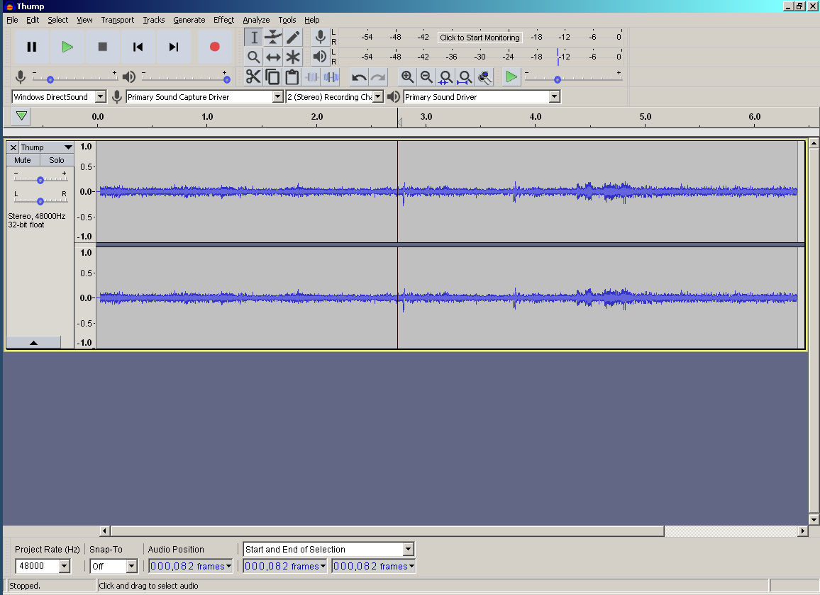

  4. jagabo's high pass filter suggestion is a sane one, however if insane is an option, turning the thumps down manually qualifies.
    Hunt down a thump (just after the selection point here).
    [Attachment 55665 - Click to enlarge]

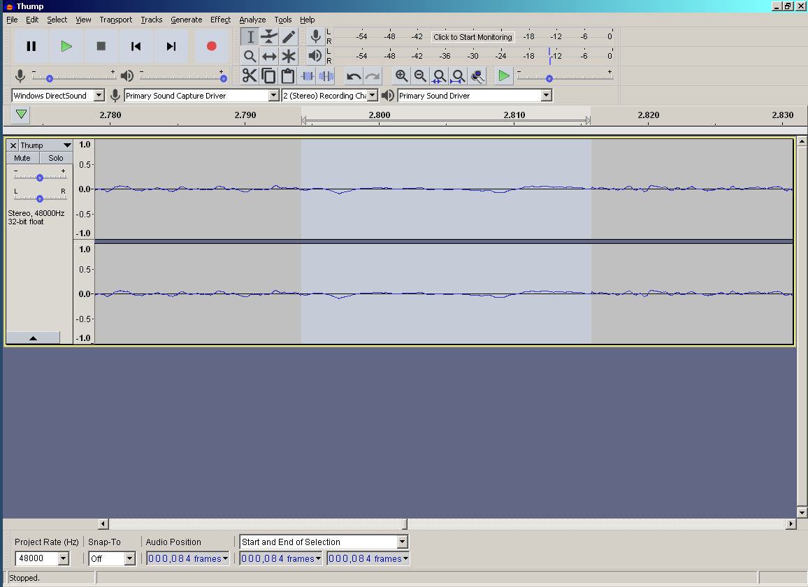

    Select a small area around the thump and zoom in to the selected area.
    [Attachment 55666 - Click to enlarge]

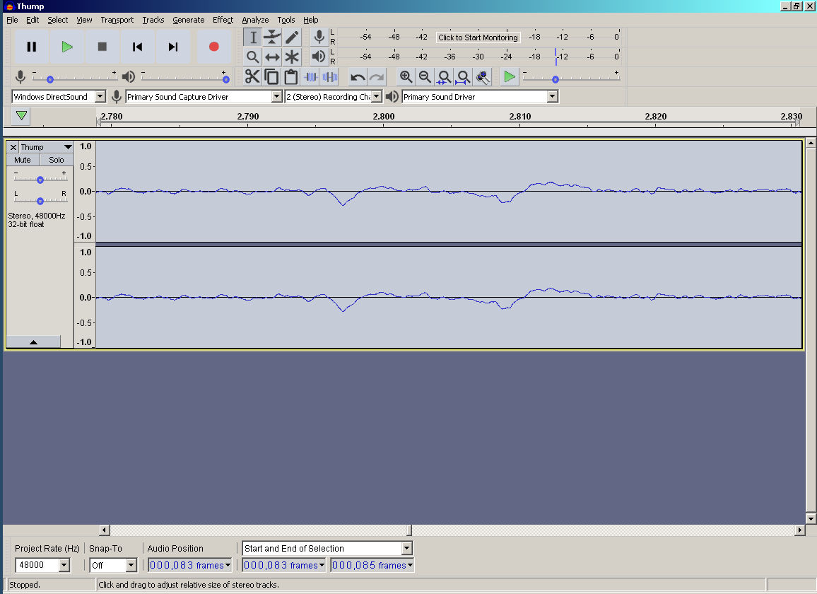

    Highlight just the thump and reduce the volume (Amplify effect). -10dB seems enough.
    [Attachment 55667 - Click to enlarge]

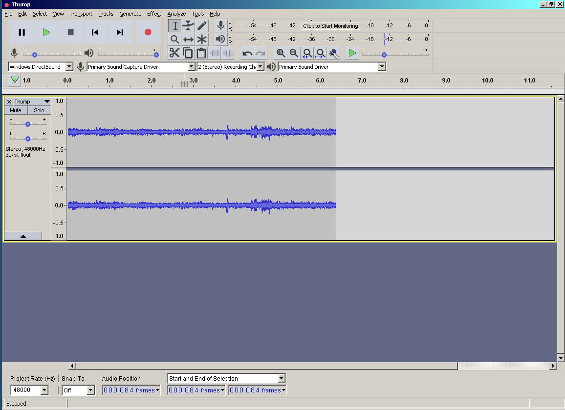

    Zoom out and re-commence thump hunting.
    [Attachment 55668 - Click to enlarge]

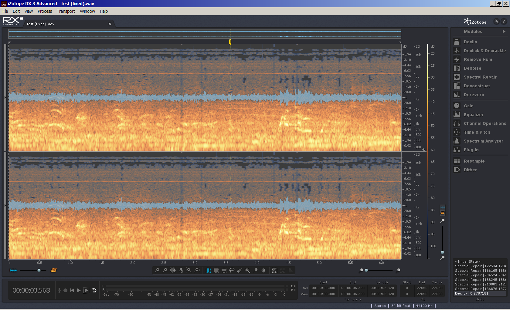

  6. You have two problems. You have a "motorboating" set of thumps at very regular intervals, as shown by the green arrows, and then you have non-periodic, much louder thumps indicated by the red arrows.
    You say that you have hiss which indicates that you might be capturing from the analog linear channel. However, that motorboating is something I have heard quite often on Hi-Fi channels captured on my hi-end Panasonic deck which, unfortunately, has a misaligned Hi-Fi problem.
    Exactly what is the nature of this tape? Roughly what year was it created? Are you capturing the linear (analog) channel or the Hi-Fi channel? What tape speed is used (2-hour, 4-hour, 6-hour)? If this is Hi-Fi and is caused by your deck being misaligned, using a different deck can eliminate the problem. As an alternative, if you are capturing Hi-Fi you can instead capture the linear channel. This will degrade the audio somewhat (it will degrade a LOT if it is a 6-hour tape), but the thumps will almost certainly be gone.
    As you can see from the second picture, I fixed it by repairing the big thumps using "Spectral Repair" in iZotope RX. I was very sloppy with the settings which is why you see some of the high frequency material eliminated. If I'd spent an extra couple of minutes to set it up correctly, the repair would have been 100% perfect. For the motorboating, I used the Declick tool, which is normally used to remove clicks and pops from records, but has a setting that lets you widen the click removal and another setting that only looks for low-frequency "clicks" (i.e., "thumps"). As you can see, it removed that completely. I have attached a file that lets you hear the results.
Name:	test fixed.png
