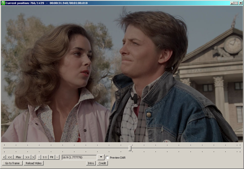

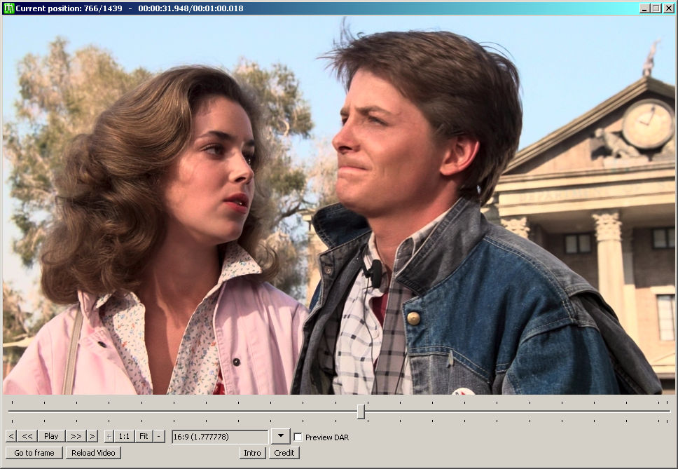

  8. My first HDR to SDR conversion, probably not done correctly, but it's as close as I could get before the desire to kill myself became too hard to resist. It was unbelievably slow to do on my old PC. Conversion with HDRTools.
    Rec.2020 to Rec.709
    CropResize(960,540)
    ConvertBits(16)
    ConvertToYUV444()
    ConvertYUVtoXYZ(Color=1)
    ConvertXYZtoYUV(Color=2, PColor=1)
    ConvertBits(8)

    Rec.2020/21 to Rec.709, crossing my fingers and including HDR to SDR conversion
    CropResize(960,540)
    ConvertBits(16)
    ConvertToYUV444()
    ConvertYUVtoXYZ(Color=0, HDRMode=0)
    ConverXYZ_BT2446_C_HDRtoSDR(PQMode=true)
    ConvertXYZtoYUV(Color=2, PColor=0)
    ConvertBits(8)
    [Attachment 55689 - Click to enlarge]
    [Attachment 55690 - Click to enlarge]
    Does the way it displays on your TV look like either of the above?
  9. On my TV... it looks like the 2nd image except mine has more reddish blotchiness in the skin which is what I'm trying to tone down.

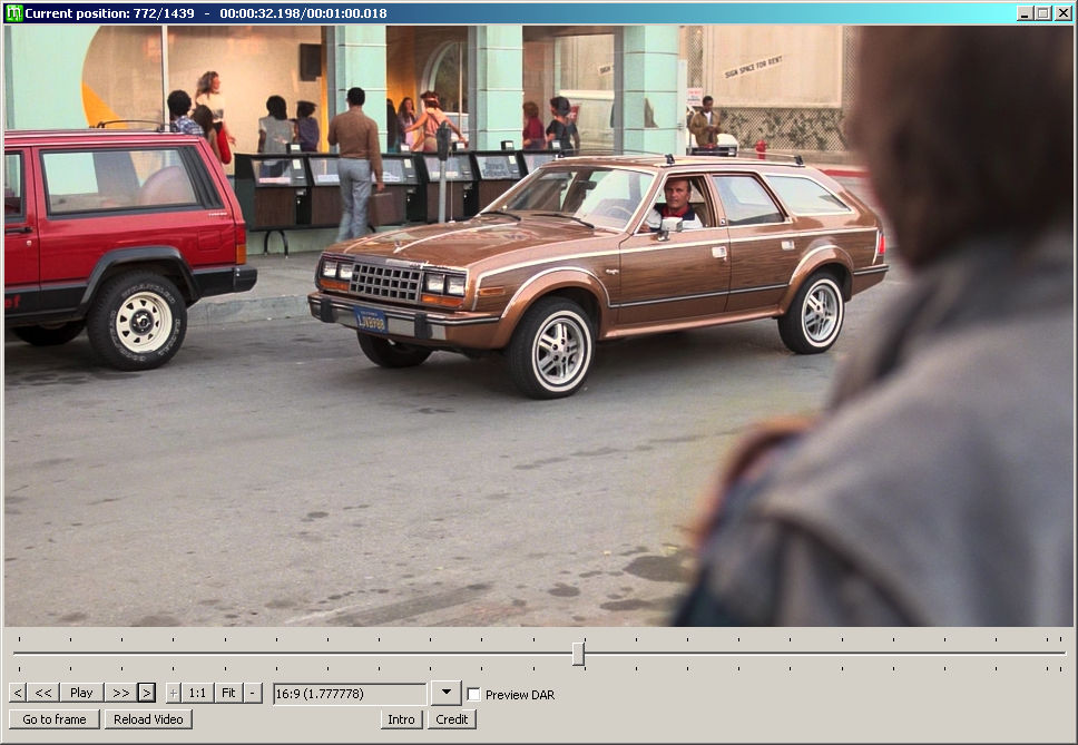

    Here's the quick re-encode, rec 709 conversion, using DGReinhard
