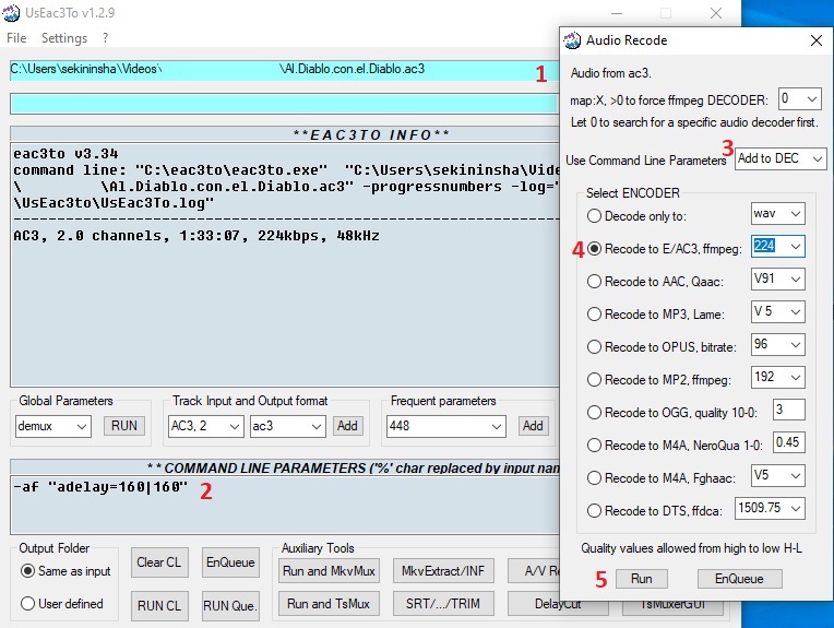

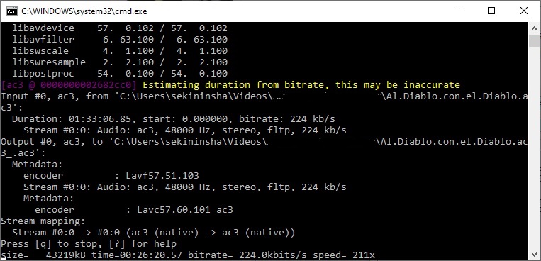

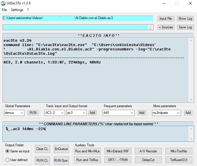

I use 'eac3to' in your GUI UsEac3to ... or also 'ffmpeg' in 'a/v recode' button
eac3to:
[Attachment 55524 - Click to enlarge]
ffmpeg: add -af "adelay=160|160"
[Attachment 55525 - Click to enlarge]
[Attachment 55526 - Click to enlarge]Last edited by sekininsha; 15th Oct 2020 at 18:03.

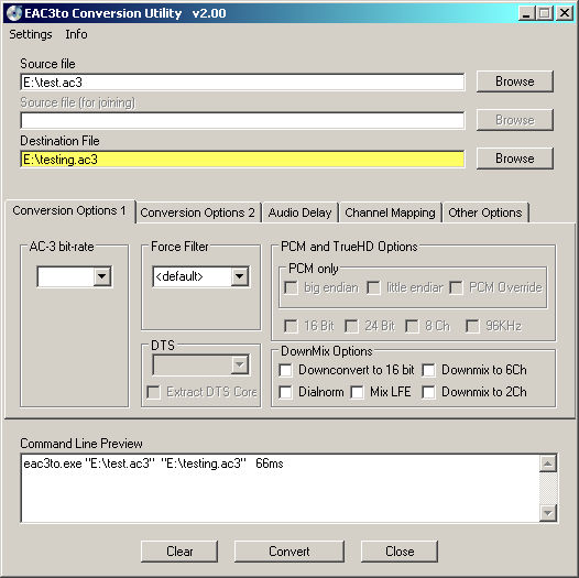

I case you're not aware, and I don't know if all formats are supported this way, but for ac3 sources at least, if you don't specify a bitrate and the output is ac3, eac3to won't re-encode. It'll still add a delay by adding silent audio, but it doesn't re-encode the rest. The main difference is, without re-encoding, the delay can only be applied in increments the size of an audio frame, but it's close enough.
Edit: After posting I realised the bitrate specified in your screenshot was the same as the source bitrate, in which case eac3to shouldn't re-encode (unless you specify other options that force it to).
Without re-encoding:
Code:eac3to v3.34 command line: "C:\MeGUI\tools\eac3to\eac3to.exe" "E:\test.ac3" "E:\testing.ac3" 66ms ------------------------------------------------------------------------------ AC3, 5.1 channels, 0:21:35, 384kbps, 48kHz, dialnorm: -27dB Removing AC3 dialog normalization... Applying (E-)AC3 delay... A remaining delay of +2ms could not be fixed. Creating file "E:\testing.ac3"... eac3to processing took 2 seconds. Done.
[Attachment 55527 - Click to enlarge]
The same sort of thing applies when extracting audio from a container such as MKV.

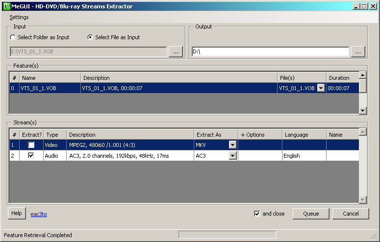

I tend to use MeGUI's HD Streams Extractor for that. Eac3to will detect any container audio delay and remove it by adding silence as it extracts. It'll also fix any gaps in the audio stream by adding silence, should there be any.
[Attachment 55528 - Click to enlarge]Last edited by hello_hello; 15th Oct 2020 at 19:31.
