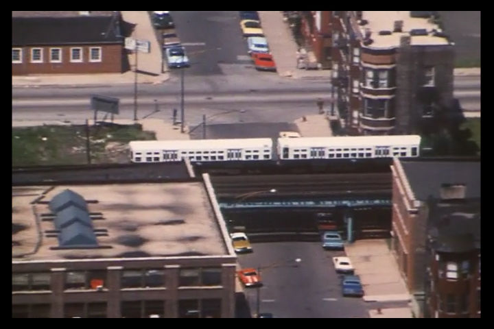

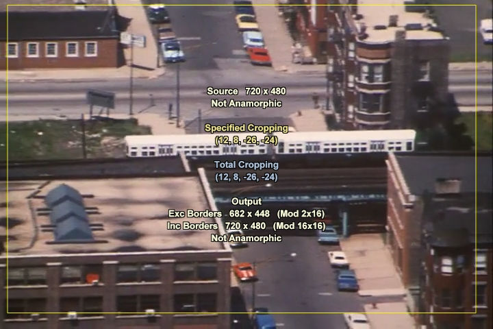

  18. Okiba,
    The CropResize function in my signature has the ability to clean borders, and it also has a cropping preview if that helps, so you could do something like this to preview the cropping for each segment.
    There's three types of cropping preview (CPreview = 1, 2 or 3). The picture below barely needs cropping, but to demonstrate....
    The first two numbers are normally used for resizing, hence being zero, and the next four numbers are the usual cropping.
    # GCropResize specifies global arguments for each CropResize instance
    GCropResize(CleanBorders=true, CPreview=1)
    A = Trim(0,999).CropResize(0,0, 12,4,-8,-2)
    B = Trim(2000,2999).CropResize(0,0, 12,8,-26,-24)
    C = Trim(5000,0).CropResize(0,0, 16,4,-8,-12)
    A ++ B ++ C
    If you open the script in VirtualDub, you can use F2 to reload it after you adjust the cropping.
    [Attachment 55258 - Click to enlarge]
    Once you're happy, remove the CPreview argument and CropResize will add borders for the original resolution while placing the picture in the centre.
    GCropResize(CleanBorders=true)
    A ++ B ++ C
    [Attachment 55259 - Click to enlarge]
