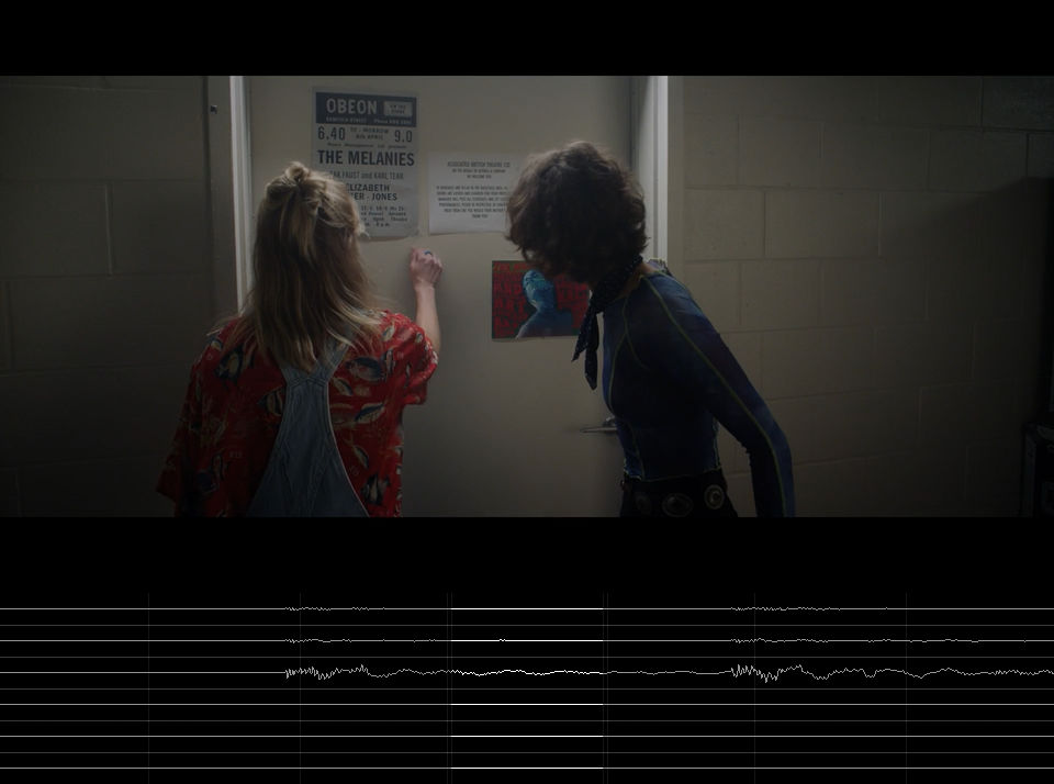

    I had a music video sitting on my hard drive, so I had a look. I encoded it myself and I'm pretty sure I wouldn't have, or at least shouldn't have, introduced any additional (encoding) delay when I re-encoded the Bluray. I'd never have noticed while watching the video, but it does seem the audio is at least one frame behind.
    I tried a movie for fun, and the first place I found where I could be fairly sure, the audio was at least one frame ahead.
    I'm not sure I'd fuss over a single frame difference. A frame lasts for around 40ms, and often it's hard to tell when the noise was made, looking at individual frames. That is, when the frame is first displayed, when it finishes displaying, or somewhere in between.
