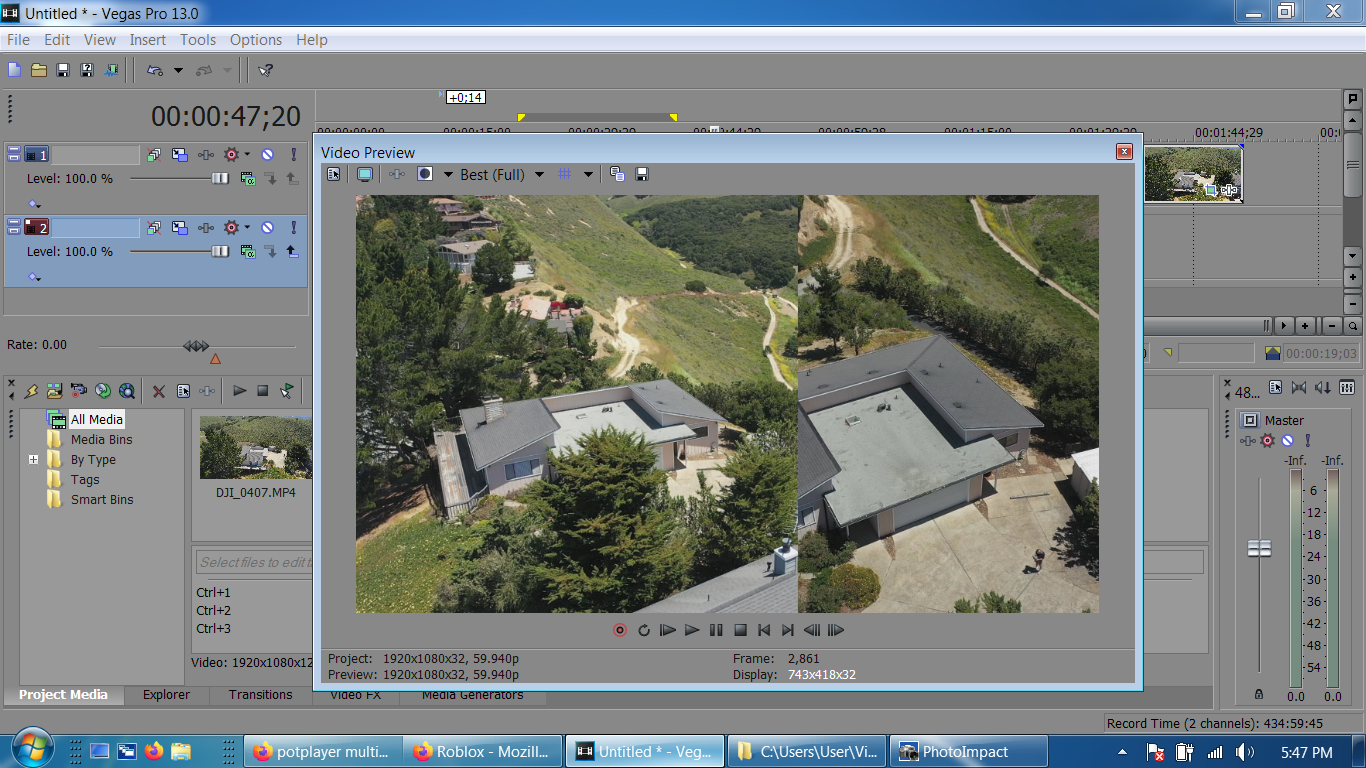

  9. P.S. Here are two similar videos, set up to play side-by-side in Vegas:
    https://forum.videohelp.com/attachment.php?attachmentid=54005&stc=1&d=1593478184

  10. Originally Posted by johnmeyer View Post
    in your attached screenshot. that "video preview" window, can it go full screen?
    also I see its comparing two videos side by side but seems the two video are somewhat cropped on the horizontal length, meaning you can compare two videos but only see a portion of the two videos.
    most of my 2 videos most narrow will still be 640 x 480 so 4:3 and two of them side by side will become 4 by 6, i dont wish to have them each cropped and become a regular widescreen and lose some outer part of the videos.
  11. Originally Posted by wtfiwinomgs View Post
    I spent 30 seconds doing this. A little more time and I could get closer to what you want.
    What exactly are you trying to do? If the goal is to see the differences, which is what you said in your initial post, this will work just fine, even if the video cannot be precisely full screen. You can easily get it to 90% of full screen, and you can get the videos to play side-by-side.
    However, there is no way you can play two HD videos side-by-side on a normal screen without cropping. This is a "square peg in round hole" problem, because any normal computer or TV display is designed to fit one HD video and when you put two side-by-side, basic geometry dictates that you will have to have black bars at top and bottom.
    If you absolutely insist on full screen, Vegas can easily squish the videos so they will conform to a 16:9 space, but they'll look like garbage and I think you'll have a tough time seeing the differences.
