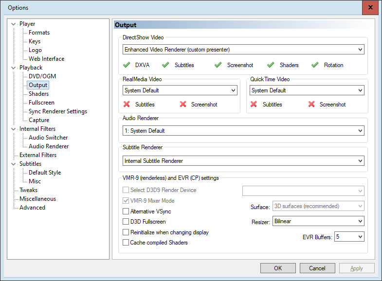

Here's my settings. I tried all the other decoders but this DXVA native seems to be fastest.

What output device are you using? View -> Options -> Playback -> Output:
[Attachment 53654 - Click to enlarge] -
