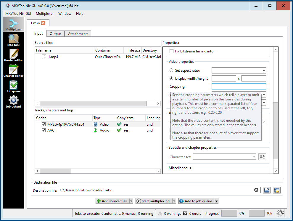

  7. Clean black letterbox bars don't consume much bitrate. You can only decrease the quality of the video by reencoding it.
    MKV does have cropping parameters. You could try remuxing (no loss of quality) using those to have the player crop at playback.
    [Attachment 53002 - Click to enlarge]
    Don't count on all players obeying those parameters.
    Mh this is an interesting feature I didn't know about, thanks
