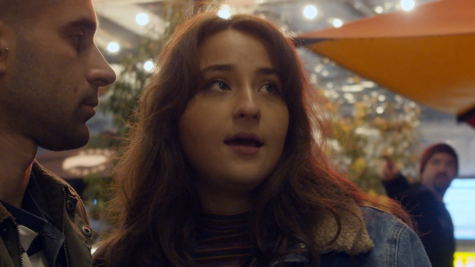

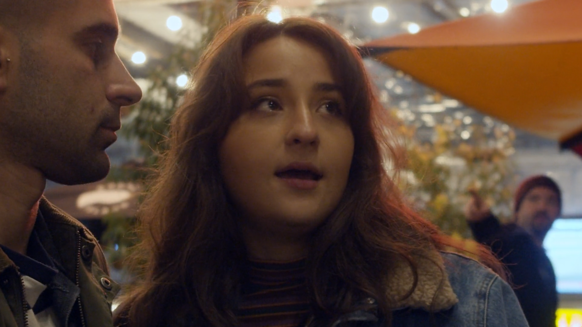

  4. I told myself I was not going to be drawn into this, the OP's question was clearly a trolling attempt, flame bait designed to start a discussion such as this one, and I fell for it like a dumb ass.
    But, once you're in the dance, you may as well boogie down, so, I accept PDR's challenge.
    I decided to do a couple of test encodes with sources that are usually not used, in this case Black Magic's ProRes samples that can be found here:
    https://www.blackmagicdesign.com/products/blackmagicpocketcinemacamera/workflow
    On thing to note, because I'm working on Ubuntu and ProRes, and Intel's QS, is a bitch to work with on Linux, I had to use a rather convoluted workflow for this test.
    Notes:
    The test sequence I used was Food Blogger Mov, which is 3840x2160 ProRes that needs to be cropped to 3840x1600. I wanted to use AviDemux for a variety of reason but this software does not play nice with ProRes, it "pretends" to open it but when you try and produce a usable file, you get a file that appears to be the right size but has no video data in it.
    ShotCut will open these MOV files and you can scrub through the timeline and apply filters, but it will not crop them properly, it's difficult to get the DAR to be correctly encoded and ShotCut on Linux absolutely refuses to adhere to bit rate limits with regards to QS.
    I could have used ffmpeg, but while compiling ffmpeg support with vaapi is relatively easy, it is a big pain in the ass to get qsv working and if you are going to compile ffmpeg from source you may well build it with qsv, because qsv exposes settings that substantially improve quality, such as trellis, mbbrc or extbrc, which significantly improves quality that I can notice under nearly all circumstances.
    In the end, I wanted to make this as fairly easy as possible, so I settled on this somewhat hacky methodology --. load source into Handbrake, let is crop and export as a lossless (CRF 0) x264+ultrafast. I then loaded that into AviDemux and did a bunch of encodes, all of them set for 10 mb/s. The x264 encode used the fast preset which has all the psycho-visual BS enabled but I only used a 1 pass constant bitrate setting. Why? Because Intel's encoder does not support a 2 pass and AviDemux does not expose a 1 pass vbr for x264 nor does it expose a CRF+max bitrate setting. This may cripple the x264 encoder in some faithful's eyes, but Intel is also crippled because AviDemux uses vaapi, which only allows for a limited subset of settings to be used, AviDemux doesn't expose any quality settings at all for Intel and QSV is capable of offering higher quality than VAAPI. I figured any supposed disadvantage bestowed on x264 was more than offset by the limitations imposed in Intel.
    One more thing, I did so many encodes and I walk away from my encoding PC, consequently I kind of forgot the settings I used for the Intel encodes. I know some of them used the default GOP=100 and 2 b frames, but I also know I did 1 with GOP=250 and 3 b frames (like x264), 1 each with GOP=24 and no b frame, and 1 each with GOP=12 and 0 b frames. I also know the last Intel AVC encode I did I added a denoise and sharpening filter.

  6. Originally Posted by sophisticles View Post
    Useless test. 1 pass CBR fast ?
    Don't use avidemux if it cripples everything
    Use settings that people would typically use, or design the test that shows how the encoder is supposed to work. Not some artificial limitations
  7. Originally Posted by sophisticles View Post
    I have a 2010 release Mainconcept Reference on an XP install. For lower bitrates (I chose 2400 kbps for 1280x720),
    it was clearly worse than today's X264, with noticeable difficulties in flat parts.
    However, I also downloaded a new demo of MC Totalcode and this is much improved. Which one is better now is not so obvious.
    The source is 1080p, movie preview, Bluray source. Resized in the encoders (MCTC 5.0 and Vidcoder X264 latest beta) to 720p.
    Thank you for this, if truth be told I am unable to see a difference between any of them in the environment I am now, sitting in my well lit office in front of an AIO with overhead lights on and plenty of sunshine, all three look very similar to me.
    Did you get a chance to have a better look or are you hoping to ignore the result and nobody will notice? It's quite clear x264 retained more detail wherever there's movement.
    I decided to do a couple of test encodes with sources that are usually not used, in this case Black Magic's ProRes samples that can be found here.
    I'm baffled as to what the samples you posted are supposed to show. That you can encode video at a decent bitrate and achieve a decent quality?
    Once again you chose to use settings for x264 that few people in the real world would ever use. At least not here. I only looked at the first two samples as they don't have much to do with the discussion. The second one looked very marginally better, but all you've done is prove any encoder can produce a decent quality encode at a high enough bitrate, even after you crippled x264. You could've used 2 pass VBR encoding for x264 as you know it uses the same encoding method as CRF, and it'd more relevant and closer to reality than the CBR encode you offered. Even ABR probably would've been better, although at least x264 still seemed to put the keyframes in sensible places. ie the first frame of a new scene.
    How about some samples at low bitrates so we can see where the different encoders start to fall over, quality-wise?
    How about something that's not 4k? We're all not obsessed with it, the majority of people here probably don't have 4k monitors yet (I don't), and we know h265 is designed with 4k in mind, not h264.
    @hello_hello: You consider 10 mb/s for 3840x1600 4k to be too much bit rate? This is where the x264 faithful and I differ. The Blu-Ray spec allows for up to 54 mb/s for video which can be a maximum of 1920x1080p60, UHD BD allows for up to 144 mb/s which can be a maximum of 3840x1600p60, yet using greater than 5 times less bit rate than BD for a resolution that is 4 times bigger than BD is somehow considered "a decent amount".
    Wow, you certainly confabulated a lot from my statement that encoders should produce a decent encode at a decent bitrate.
    You didn't include the source, so I just assumed the quality was pretty high each time. BTW, your source is one third the frame rate of the maximum frame rates you quoted.
    People complain about the quality of Blu-Ray and UHD BD all the time and you guys want to use less than 10 mb/s for 4k?
    The complaints don't necessarily have anything to do with the quality of the encoder. Do you have an example of a complaint about encoding quality?
    So in the interest of fairness i did Intel AVC and Intel HEVC encode at that bit rate. You will notice that the Intel encoder used less bit rate than x264 and still managed to match the quality of the vastly over-rated x264.
    Go ahead and tell me how x264 is vastly superior to all other encoders
    Vastly superior?? Who said that?
    I'm not actually sure what we're supposed to be comparing any more, as your comparisons are never between apples and apples, but it's obvious the "BMPCC_Food_Blogger x264 cheat settings" encode from your last post has slightly more "fine" detail than the "BMPCC_Food_Blogger Intel AVC VA-API 1" encode from your previous post, and I'm viewing them both scaled down to 1080p on a 1080p monitor.
    For the encodes with twice the bitrate, I can see the x264 encode has been encoded differently compared to the "cheat" encode", but I can't say that's because of the extra bitrate or simply because you can't even manage to use the same encoder settings twice, but doubling the bitrate didn't help the new "BMPCC_Food_Blogger Intel AVC" encode retain as much fine detail as either of the x264 encodes. All screenshots are only part of the frame so as not to resize when viewing them on my monitor. Hover over the thumbnails for the tooltip and the names of the screenshots as they're not labelled, although the file sizes might also give you a hint. I can even see the difference on my CRT.
    If the Intel AVC encoder is broken on Linux but looks very similar to the Intel HEVC encoder, what does it say about the latter?
Name:	BMPCC_Food_Blogger x264 cheat settings.png
Name:	BMPCC_Food_Blogger x264 CRF.png
Name:	BMPCC_Food_Blogger Intel AVC VA-API 1.png
Name:	BMPCC_Food_Blogger Intel AVC.png

  27. Originally Posted by hello_hello View Post
    You guys, the x264 faithful, nearly all he time. PDR is like a x264 cheerleader, he goes on and one how "x264 has won every test every time" and with some supposedly huge margin.
    Do you know what the sad thing is? The x264 "cheat" encode was done with 2 pass vbr, preset slow, profile high while the Intel AVC VA-API 1 is using 1 pass, because Intel's encoders do not support a 2 pass mode. So, the highly vaunted x264 encoder, with the settings cranked up managed to have slightly more fine detail than an encoder that's hobbled in the implementation in AviDemux and which I truly believe is fundamentally broken On Linux.
    The "cheat" encode was done as a way of satisfying the people complaining about my using a 1 pass CBR for the first x264 encode, I "cheated" by using a 2 pass vbr + preset slow + profile high, which are setting that should completely blow Intel's AVC encoder out of the water, The said thing is, by your own admission, it doesn't, it simply retains slightly more fine detail. Those are your words correct?
    I based my broken comments on tests that I have done using the Net Flix sources found on Xiph, specifically the drone clip with Handbrake, no matter what I do the Intel AVC encoder falls apart, it macroblocks badly, no matter how much bit rate I throw at it, and I have seen similar behavior with other clips.
    It could be this particular source is very friendly to this encoder, which happens time to time.
