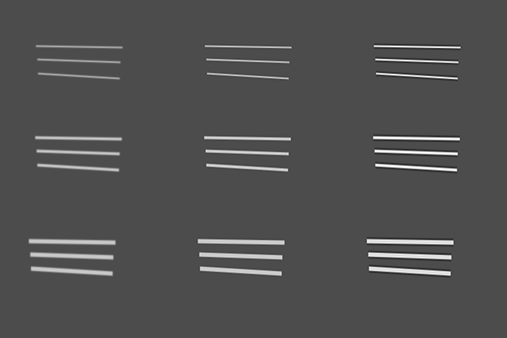

  6. SeparateFields().WhateverSharpen().Weave() isn't a great way of sharpening interlaced video. This is because scan lines that are not adjacent to each other (there's a missing scan line between them) are treated as if they are. Artifacts are spread across two lines instead of one. Since I never have need to keep interlaced video interlaced any more, I use QTGMC() to make the video progressive, then sharpen from there.
    original fuzzy lines, Sharpen(1.0), SeparateFields().Sharpen(1.0).Weave():
    [Attachment 52623 - Click to enlarge]
