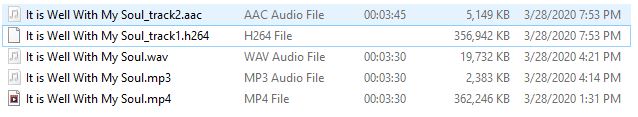

I demuxed the original MP4 that I recorded into an AAC audio file and an Advanced H264 video track. Here's what that produced. Interesting that the .aac file 2 is 3:45 now when in the container it was 3:30
[Attachment 52506 - Click to enlarge]
Then I remuxed the H264 video track with the .wav file (that was originally extracted from the same file I got the video from, then sweetened and converted to mono). , the resulting muxed file had only video, no audio and is only 2:44 in length.
So, then I took the video file and muxed it with an mp3 of the same audio file. The original MP4, the extracted audio mp3, and the extracted audio wav are all 3:30.
The muxed files with the mp3 has 3:30 of audio, so the audio is right, but it only has 2:44, of video, and the video freezes at that point while the audio plays on till 3:30.
So if I could figure out how to get the length of the video to be 3:30 and fine tune it to get it in sync this would fix my problem.
