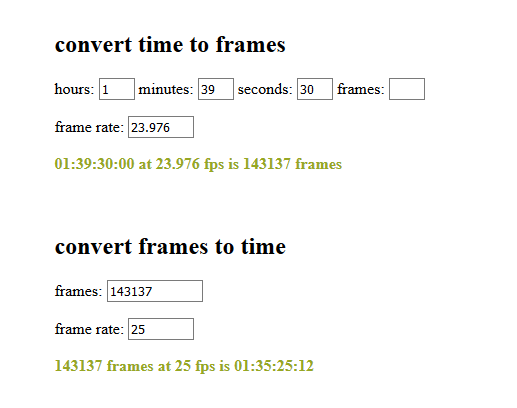

    So, I want to combine two different files in a way that I will use the video from one file and the audio from the other. My problem is that one of them is 1:39:30 @24000/1001 FPS while the other is 1:35:24 @25 FPS
    Using the framecalc in this page, indeed converting the FPS of one of them to the FPS of the other, will make the durations equal...
    [Attachment 52459 - Click to enlarge]
    However, I used Handbrake and also ffmpeg (with the help of this thread on StackExchange) and while the FPS indeed change in the produced video, the duration remains the same.
    As I said, I'm in no way a video expert, but it makes sense that "squeezing" more frames per second, going from 23.976 FPS to 25 FPS (of course keeping the frames number the same), should produce a shorter video file. But in my case, going from 23.976 to 25 FPS doesn't shorten the duration. Likewise, doing the opposite action with the other file, the produced video wasn't longer either.
    What am I doing wrong?

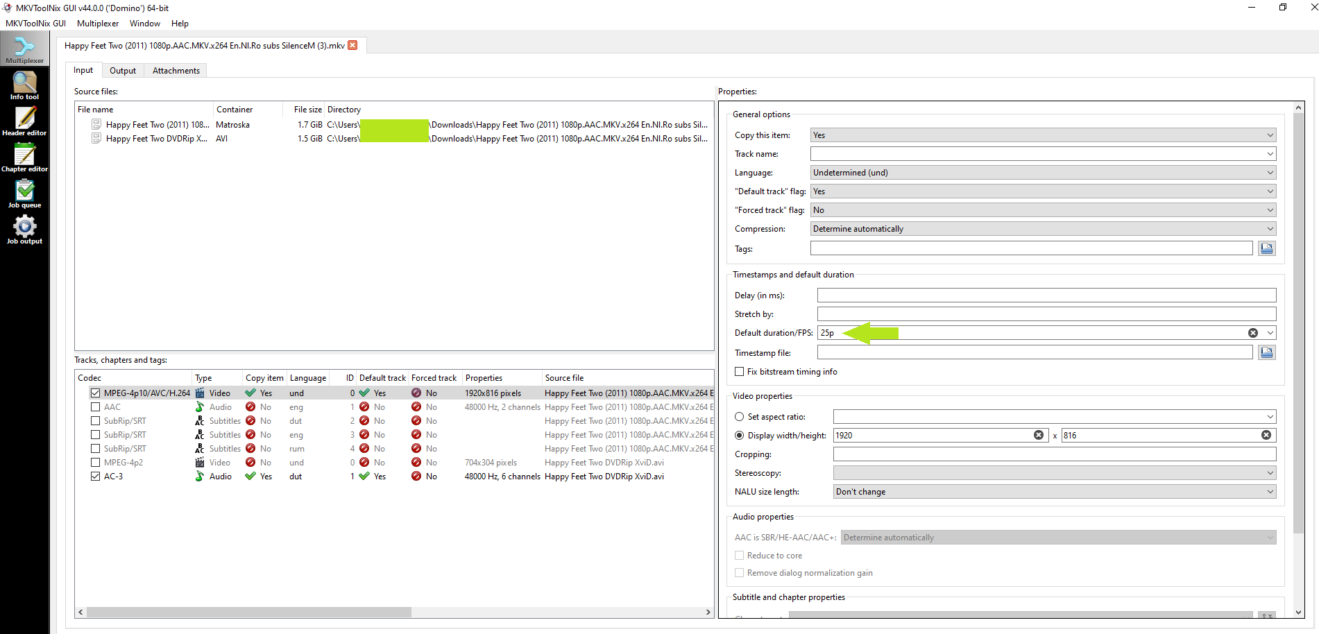

  2. I think I solved it. A bit indirectly and not in the most proper way I assume, but I'm happy at least it worked, as I was struggling the whole day to make it happen.
    So I used MKVToolNix, and added both files, then unchecked the contents I didn't want to use in the final .mkv file. The trick was to manually set the option Default duration / FPS of the video file to 25 FPS (originally the video was 23.976 FPS). The produced file had the correct duration (the one of the audio - 1:35:24) and of course everything was in sync.
    [Attachment 52462 - Click to enlarge]
    As I said this worked like a charm, but I'm still curious to learn the proper way of re-encoding the video file to the desired 25 FPS, if anyone cares to help! TIA.

  4. Originally Posted by PrinceOfAbyss View Post
    Some encoder GUIs can change the frame rate. If you don't need to re-encode then you did it correctly, but as manono said, I'd re-encode the audio and leave the frame rate as it was.. Many encoder GUIs (or many Avisinth-based encoder GUIs) have options for applying PAL speedup or slowdown when re-encoding audio. It's a fairly standard thing. If the GUI has options for changing the audio rate with and without pitch correction, you probably don't want to apply pitch correction in this case.
