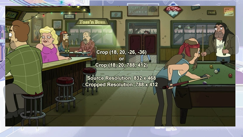

Obviously this image doesn't really need cropping, but to demonstrate...

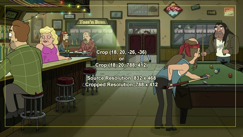

pCrop shows the cropping preview as yellow lines.
pCrop(18,20,-26,-36)
ppCrop shows the cropping preview as yellow transparent borders.
ppCrop(18,20,-26,-36)
And pppCrop shows the cropping preview as the inverse of the picture, much like AvsPmod's preview.
pppCrop(18,20,-26,-36)

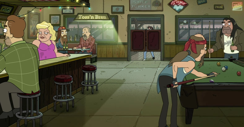

Naturally when you're happy, you just remove the "p"s to crop.
Crop(18,20,-26,-36)

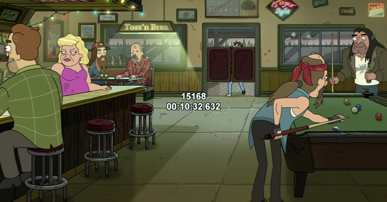

Because sometimes it's handy, there's also wrapper functions for displaying the current frame number and/or time over the video. The help file has details, but they work by appending letters to the other side of the function name, and can be used with or without a cropping preview enabled.
CropP(18,20,-26,-36)
