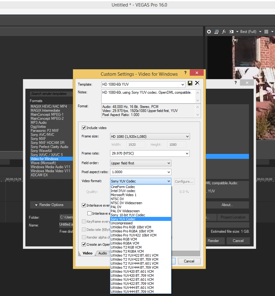

    so you're a newb vegas user. render as/video for windows. choose an output then configure to what you want.
    [Attachment 51614 - Click to enlarge]
  9. Originally Posted by aedipuss View Post
    Thanks!
    Completely forgot about AVI and MOV after Quicktime for Windows was terminated years ago and PCs were fast enough to edit MP4 etc natively without proxies.
    Guess yuv and uncompressed avi are among the few accessible lossless codecs now that quicktime is gone (thus no support for other codecs it used to support).

    lol quicktime was killed off by apple for all windows computers what 10 years ago? vegas will support most lossless codecs you install. they will show up in video for windows. but if you're editing in vegas, sony yuv is good...
  11. Guess yuv and uncompressed avi are among the few accessible lossless codecs now that quicktime is gone (thus no support for other codecs it used to support).
    it is not a problem at all, after installation of some lossless to system, the are available in that Video For Windows selections.
    Also for op, YUV Sony that was uncompressed I think, not lossless as the term "lossless" might be understood like "compressed without loss".
    Also that Prorez export 422 (under Magix intermediate) , so called almost lossless is not bad also , to use to keep size of video in sane numbers.
