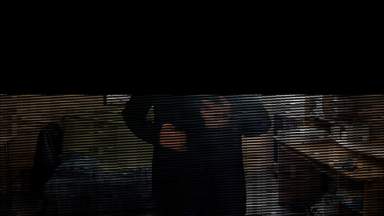

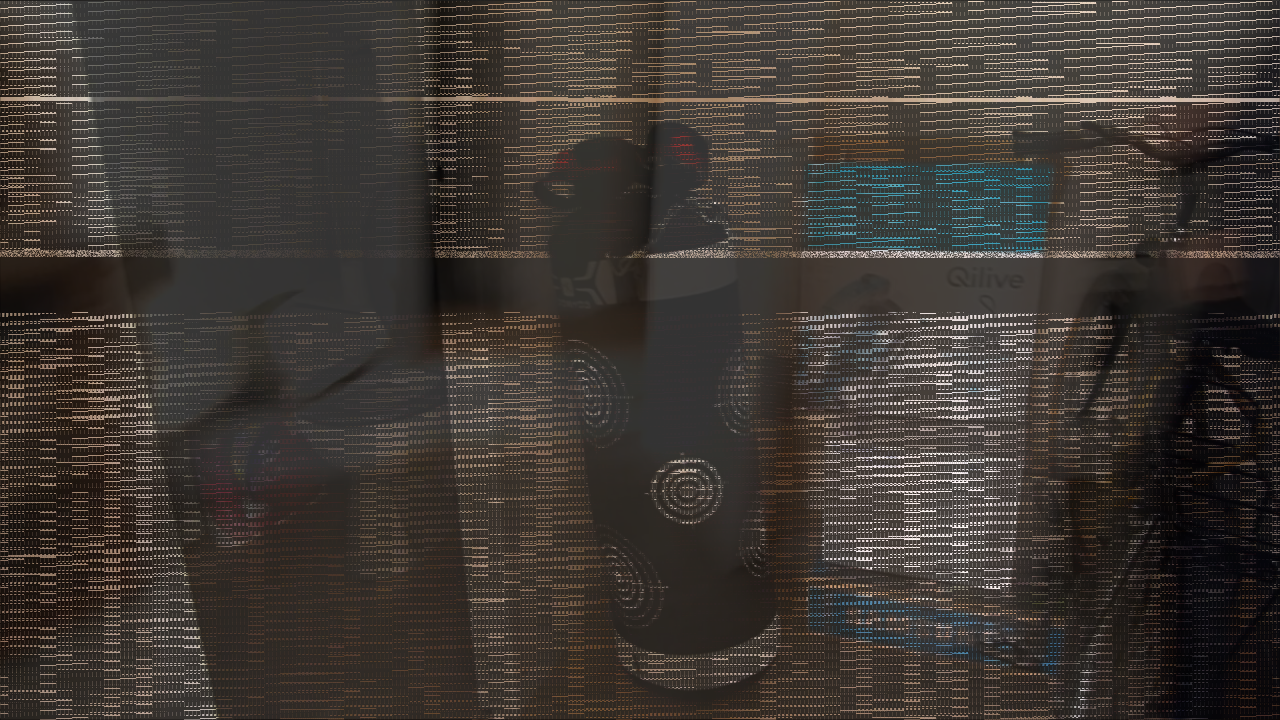

  1. So I have my Avisynth-processed Lagarith-encoded intermediate files loaded into the NLE, redid the edits, effects and whatnot...

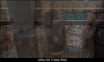

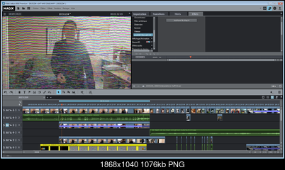

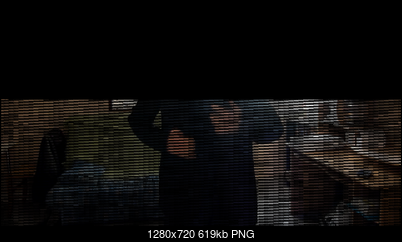

    Tried exporting the first part, about 11 minutes (good thing I didn't try exporting the whole thing !), and then... the Horror... the Horror...
Name:	20151224-1 [Lagarith 1T].avi - 00_09_32 -2018-12-26-05h20m13s426.png
    I did many tests, screaming in the middle of the night (well, more like the end of the night), and found out that :
    – When Lagarith is enabled in LAV filters, I get a seemingly random playback, with mixed frames from different parts of the same video showing completely out of order.
    – when Lagarith is disabled in LAV filters, I get this sh*t when exporting a video segment containing a Lagarith source file, especially if there's a fade-in or cross-fade ; I usually don't see this scrambled aspect in preview, except when I move the transparency cursor, or sometimes on a random frame, but if I scroll again around that frame it appears normal again ; before attempting to actually export something I thought that it was only a glitch.
    – It seems to export normally if I activate Intel QuickSync in LAV Video settings.
    MagicYUV seems to behave about the same way, although I haven't tested as thoroughly.
    Is it normal ? Why ? If not what is the likely cause ? Is it a known issue on systems based on Intel graphics from Skylake CPU ? Is activating Intel QuickSync indeed known to remedy that kind of issue ? Why does it seem to affect lossless codecs specifically ? Why is the world so mean to me ?
    Taknhs ni vnadeca (sorry, I disabled LAV filters again).

  3. I stopped using lagarith due similar issues very quickly and to be honest nowadays using only oldie but goldie huffyuv or if speed is not important (archive) ffv1 - they work always in Windows and ffmpeg, for long term archivization i would consider also h.264 in lossless mode if source demands lossless.
  4. HuffYUV looks better indeed :

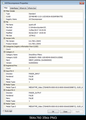

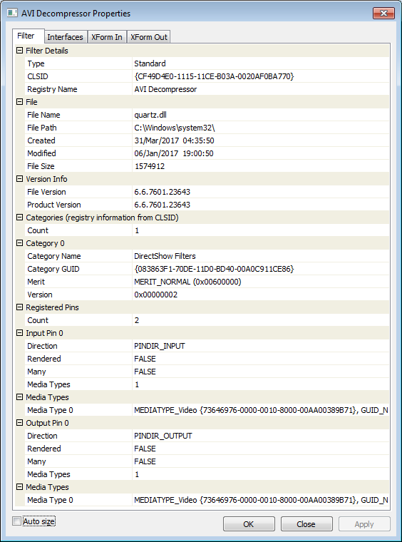

  5. I don't know how or why, but reinstalling Lagarith (using the .exe installer) seems to have solved the issue... Yet I had verified before attempting this that the .dll was present in both System32 and SysWOW64, and both files were strictly identical to the ones in the Lagarith 1.3.27 zip archive. Perhaps it changed the “merits” or something ?
    But if I open a Lagarith file in GraphStudioNext x64 it still shows “quartz.dll” as “AVI decompressor” :
Name:	GraphStudioNext x64 propriétés AVI Decompressor pour fichier Lagarith.png
    I still don't know how to use this thing...
  6. It only matters what your NLE is using. It's unlikely directshow, so unlikely graphstudio will be of any help. But stranger things have been known to happen...
    See if you can find out what it's actually using. There might be options when you click a file to import through the editor, or in the advanced options. Or uninstall a codec completely (including lav, or ffdshow or anything that has a connection to that codec) and see if it can still decode that one . If no, then you're reasonably sure it's not using an internal one. So then install one, test, repeat. Process of elimination.
    Were huffyuv, magicyuv "fixed" as well ? It's unlikely that reinstalling lagarith should have any affect on them
    So it has to be something else, maybe a simple reboot fixed things, or windows being windows

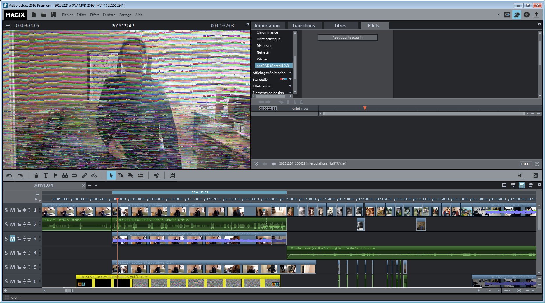

    Doing further testing, as (un)expected, I got that wonkiness with RGB24 Lagarith too. Now, I consistently get what someone on the german Magix forum described as a “frame Salat” (unfortunately the poor dude only got frustrating replies like “convert the files with XMediaRecode”, and was harshly put down when he protested about this defeating the purpose – generally speaking on that forum it seems like they tend to question the purpose rather than attempt to solve the actual issue, for instance I was asked why I was using Lagarith files in the first place, and had to explain twice), I don't know exactly what's been changed since I can no longer get at least a normal playback for Lagarith files within MVD.
    But MagicYUV files play fine now – hier is kein warum. I made further tests with a MagicYUV file :
    – In a new project, I imported just the MagicYUV file, applied Magix stabilizer with the same parameters as before, a fade-in and a fade-out, then exported as Lagarith : no thin black borders, as flawless as can be (actually not quite true : see below).
    – Then I copied that movie object (with stabilization and fade effects) into the current project, put it where it should be, to be displayed briefly over a longer sequence from an untouched M2TS file, and exported a few seconds, starting just before the fade-in and ending just after the fade-out : the thin flickering black borders are there.
    – Then I copied all the relevant objects (including the stabilized MagicYUV sequence and the untouched M2TS) from the current project to yet another new project (or more accurately, in this case, an empty new movie within the already opened project), and exported approximately the same sequence : the thin flickering black borders are there but only at the fade-in and fade-out, the rest is fine.
    I did those three tests again, after closing and re-opening the editor, with the same result. Actually, on further scrutinizing, those thin borders are already there at the fade-in and fade-out when exporting only the stabilized sequence in an otherwise empty project (same in the first test), it's just that it's less visible over a black background.
    Weird... ‘O_O

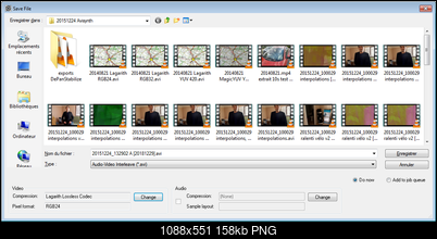

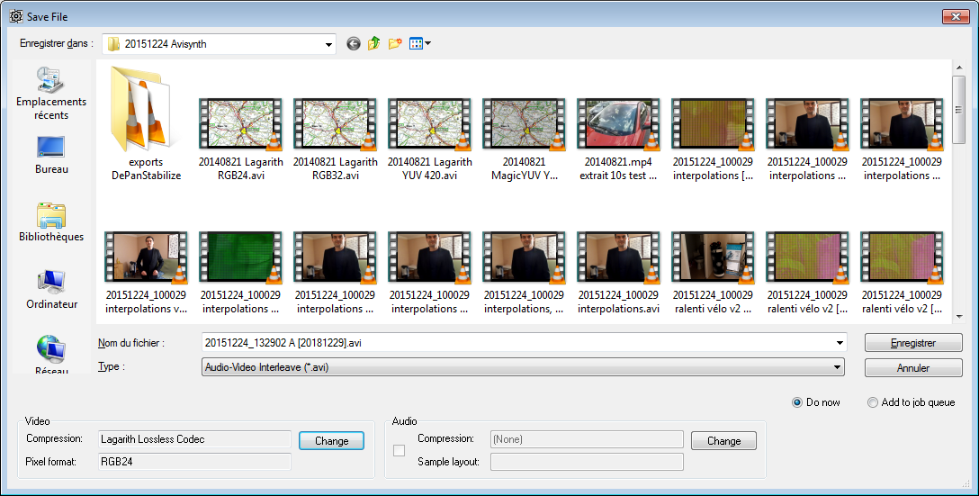

  14. If that's any relevant, I've noticed that the previews for lossless files were strange in Windows 7 explorer, with a sort of colored grid over the picture, orange-ish for Lagarith and MagicYUV (although for some reason the preview appears “normal” for some of them), and green for FFV1 (which I couldn't import correctly into MVD) :
Name:	VD2 save file -- aperçu des fichiers “lossless”.png
    Is this typical or not ?
