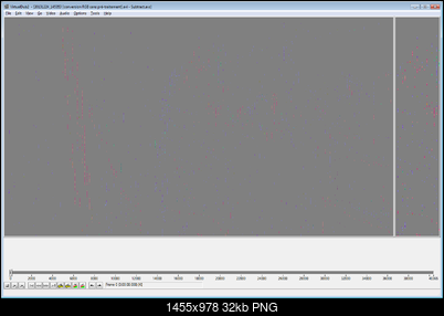

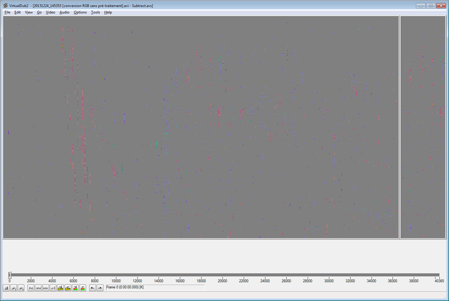

    Subtract(VID1, VID2).Levels(127, 1, 129, 0, 255)

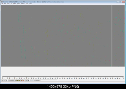

    ...and observed this, for every frame (here frame 0) :
Name:	20131224_145353 [conversion RGB sans pré-traitement].avi - Subtract - F0.png
    Small red, blue and green dots moving across the picture. So it would seem to imply that the colorspace conversion was not quite the same the second time around. How can this be explained ?
    In the mean time the only thing that has changed that would be relevant that I can think of is that I updated Avisynth. But such a basic thing as a RGB conversion with a specific conversion matrix shouldn't change over time and updates, right ? Is there something I'm missing here ?

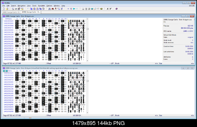

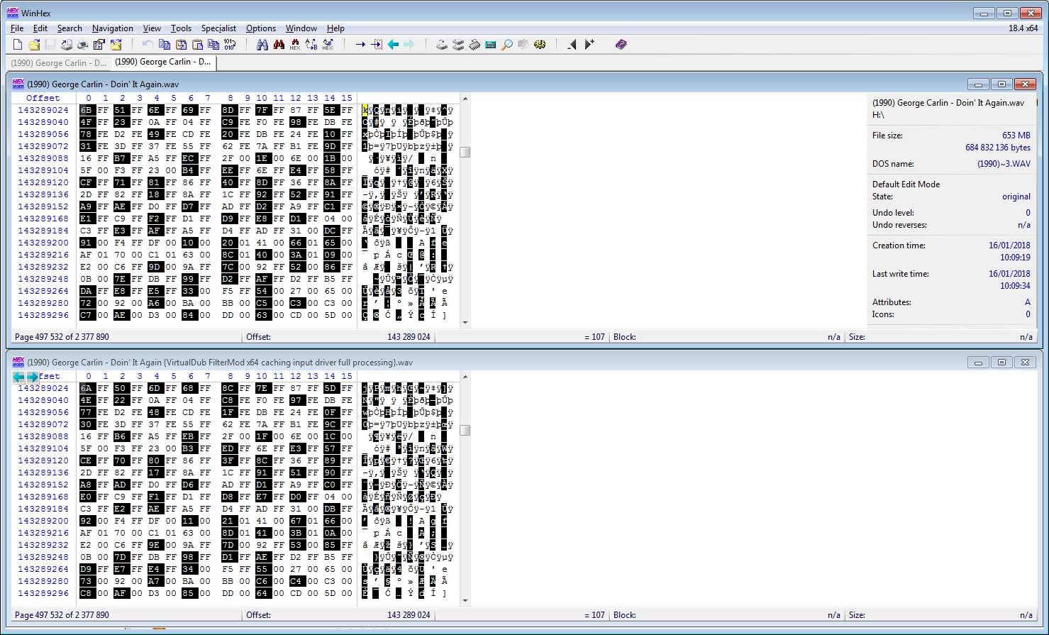

    Conversely, when I noticed that two WAV files extracted from the same AVI file could be different (as mentioned above as a side note), I used the method proposed by “jagabo” in the aforementioned thread (Audacity : Load two tracks, invert one, merge two tracks into one, amplify. If they're identical the result will be silence.”) — and contrary to what I observe here there was no difference (the result was complete silence), so in this case, even though the binary content is vastly different, the actual audio samples are identical.
Name:	GCarlin Doin' it again - WAV re-created 20181207 totally different, yet equal audio content.png
    (Here the values that are different are all different by a +1 hexadecimal increment, I don't know what that means.)

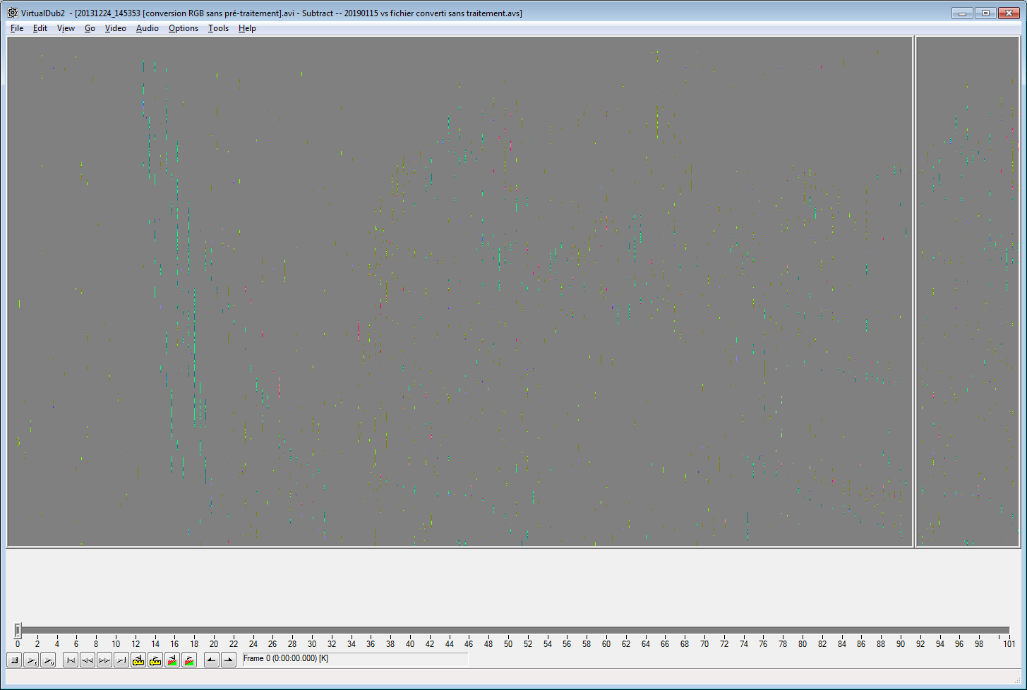

  8. As a test, I removed the ConvertToRGB command, exported a small 100 frames sample (thus in YUV colorspace), then re-made the Subtract analysis with each RGB conversion against that file (the YUV Lagarith sample) converted with the same ConvertToRGB command within the test script.
    VID1 = AVISource("[direct Lagarith conversion 100 frames sample].avi").ConvertToRGB(matrix="Rec709")
    VID2 = AVISource("[2019-01-15 Lagarith RGB conversion].avi").Trim(0,100)

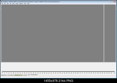

Name:	20131224_145353 [conversion RGB sans pré-traitement].avi -- 20190115 vs fichier converti sans tr.png
    VID2 = AVISource("[2020-01-20 Lagarith RGB conversion].avi").Trim(0,100)
Name:	20131224_145353 [conversion RGB sans pré-traitement].avi -- 20200120 vs fichier converti sans tr.png
    So, apparently the new conversion is lossless, the former one was not. Is there a reasonable explanation ? Another test I can make ?

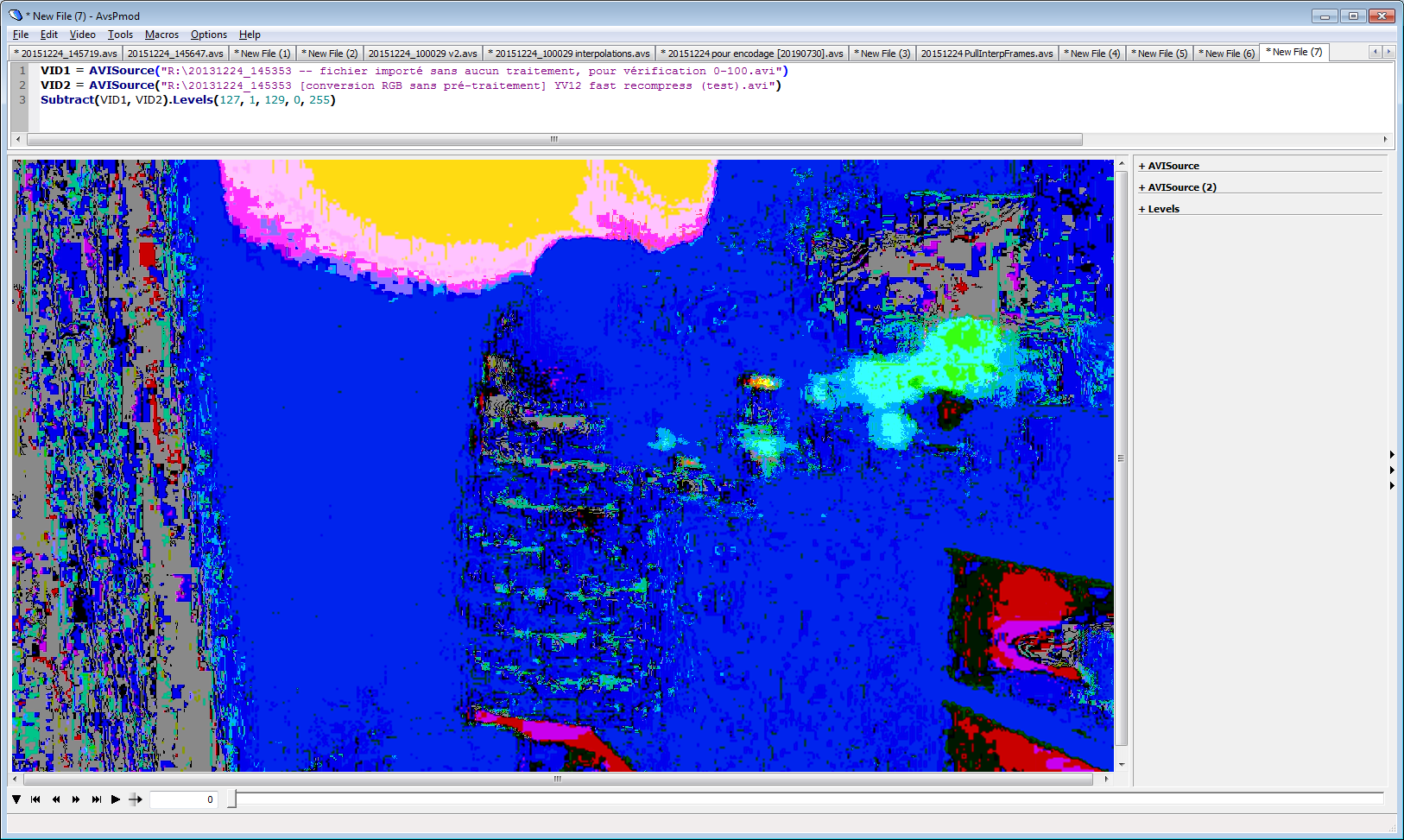

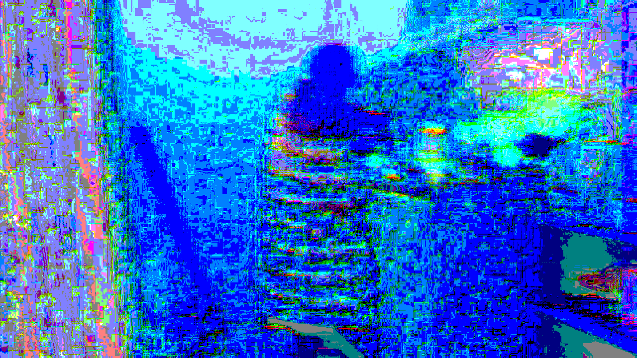

  11. lagarith has options that might not have been selected the same way for the separate encodes a year apart that would have induced small changes. try using it twice with the same things checked and then test.

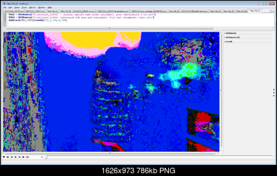

    I tried exporting the original script in “Fast recompress” mode in Lagarith's “RGBA” and “RGB” mode, then in “Full processing” mode again in Lagarith's “RGBA” and “RGB” mode, and did again the Subtract test against the test file mentioned above (created with no colorspace conversion and then converted to RGB within the test script), for all 4 tests the result was : all frames are grey, meaning, no “visual” difference at all, meaning, perfectly lossless (even though the files are almost completely different with regards to their binary content, which is — also — quite puzzling).
    As you can see, the differences are limited to small areas of the frames, does this give a clue as to what happened ?
    Also tried Lagarith's YV12 mode (the resulting file has a size reduced by about 50%), the result is quite funky :
Name:	20131224_145353 -- test Lagarith YV12 vs fichier converti sans traitement.png

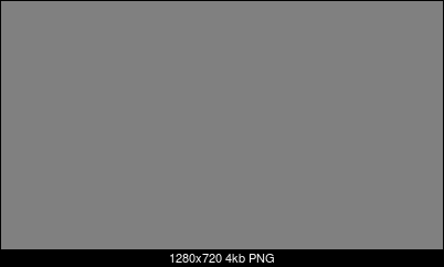

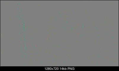

  18. Here's the result, with the same test as before :
    – VID1 generated with Avisynth+ 3.4.0.0, VID2 generated with Avisynth 2.6.0.6
Name:	Subtract Avisynth+ 3.4 ~ Avisynth 2.6.png
    => no difference
    – VID1 generated with Avisynth+ 3.4.0.0, VID2 generated with Avisynth+ r1576
Name:	Subtract Avisynth+ 3.4 ~ Avisynth+ r1576.png
    => same weirdness as above
    Also the Avisynth+ 3.4 and Avisynth 2.6 files have the same size (62223220 bytes for 100 frames) although their binary content is different in places (but identical in other places) ; while the Avisynth+ r1576 file is slightly smaller (62208464 bytes for 100 frames).
    And so indeed there was an issue, or at least a discrepancy (?), in the YUV to RGB conversion in Avisynth+ r1576, which based on those results was the version installed when I exported that file a year ago, and in all likelyhood all the others which were actually used for the editing of this movie. Does that mean that all those files are wrong ? To be honest, when watching screenshots from the same frame from the Avisynth+ 3.4 conversion and the Avisynth+ r1576 conversion back and forth, I can't see any difference...
    Last edited by abolibibelot; 24th Jan 2020 at 23:34. Reason: the screenshots were in reversed order
  19. That difference using subtract and levels massively amplifies the differences. Just plain difference is probably difficult to see. And just single frames very difficult too. It's probably negligible for most scenarios
    Not sure which specific change since r1576 , but you can look at the changelog and commits to track the difference
    There are dozens of variations just within avisynth on how to do the YUV to RGB conversion. If you look at just the scaling algorithm part of the conversion, there slightly different implementations of say "bicubic" or "bilinear" or "whatever" algorithms. That's part of what you're doing when going from YUV 4:2:0 to RGB, you're resizing the chroma or U,V Planes
    But you could argue internal (default) avisynth resizers are technically "incorrect", or different than convention. Avisynth internal resizers assume "MPEG1" 4:2:0 chroma placement , which is sited in the center. By convention, most video formats use "MPEG2" 4:2:0, which is "left" placement. (There are exceptions like DV, UHD placement, etc..If you look at the dither tools docs, there are illustrations about the different placements) .

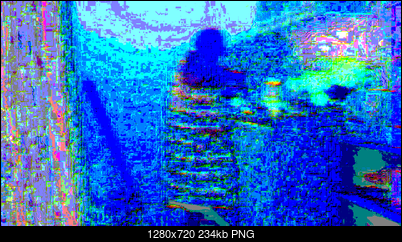

    I did another test : imported the source video into the NLE (Magix Video Deluxe 2016), and exported the first 4s in Lagarith straight away with no processing. Then used the same Subtract command on this file against the one generated by Avisynth+ 3.4 and ConvertToRGB(matrix="Rec709"). Result — the differences are much more pronounced :

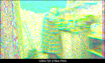

Name:	Subtract Avisynth+ 3.4 ~ export MVD.png

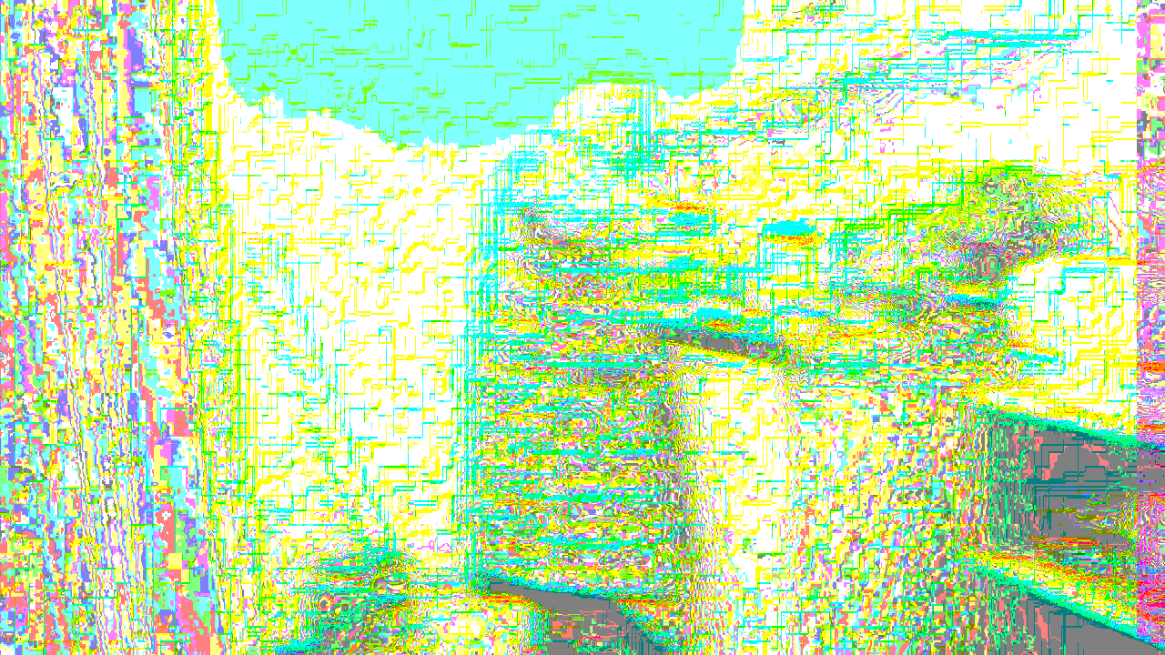

    Same test with ConvertToRGB(matrix="Rec601") :
Name:	Subtract Avisynth+ 3.4 (Rec601) ~ export MVD.png
    (If re-importing the exported file into the NLE the colors are correct, and the file generated with Avisynth and ConvertToRGB(matrix="Rec601") has different shades of reds and green, as it should be, so at least the correct conversion matrix is used when exporting from the NLE.)
    A stranger thing yet is that darker strip on the right edge of both screenshots ; I verified, it appears on all frames. What could possibly explain this ?
    (See sample videos. That was grandma holding a bottle of milk six years ago. How spooky is that.)

  21. Originally Posted by abolibibelot View Post
    Those may be edge effect of the chroma resizing algorithm.
    What does this Subtract command do, in plain terms ? (The “Levels” part in particular, I don't quite understand what the 127 and 129 values mean here.)
    The luma values between 127 and 129 are stretched to 0 to 255. So a single bit less than 128 becomes 0, a single bit more than 128 becomes 255. Basically this is a very extreme contrast stretch.
    Is there any justification for this (chroma upsampling) behaviour to be different in Avisynth from what it is in “other programs” ? What common video processing utilities are known to perform resizing operations based on the conventional “MPEG2” 4:2:0 chroma placement ? Perhaps VirtualDub for instance ?
    All programs have to perform chroma upsampling when converting YUV 4:2:0 to RGB, and chroma downsampling between RGB and YUV 4:2:0. Remember, SD ITU YUV 4:2:0 has a 720x480 luma channel and two 360x240 chroma channels, RGB has 720x480 R, G, and B channels. On conversion from YUV to RGB the chroma channels have to be upscaled from 360x240 to 720x480 to provide U and V values for each Y -- then each YUV value is converted to an RGB value. On conversion from RGB to YUV 4:2:0 you have to do the opposite, downscale the U and V channels. Different programs may use different scaling algorithms and assume different chroma placement.
