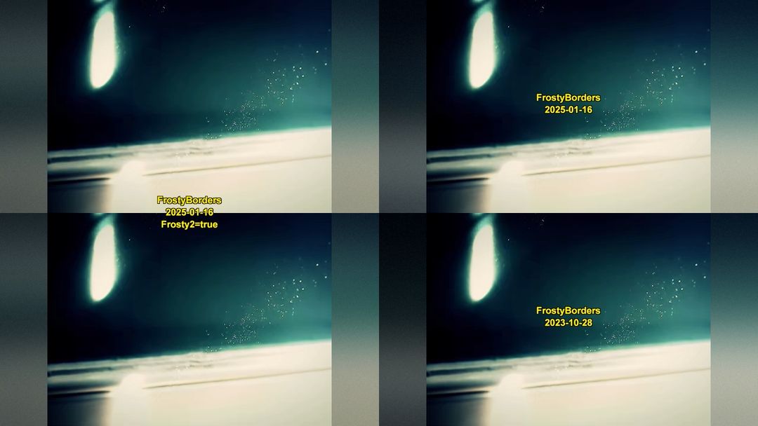

  11. Pab_,
    If you return soon, there's another test version attached. I changed the default values.... again.....
    Actually, I changed them back to their old values. So....
    FrostyBorders(1280,720) will create the borders you prefer. They're not 100% identical because the function is cropping picture for the borders a little differently, but they should be about 95% the same.
    FrostyBorders(1280,720, Frosty2=true) will blur more picture into the borders. They're the borders you don't like as much, although I've tweaked the contrast and saturation a bit this time.
    I'm now 99.99% sure FastBlur only produces the flashes of blocky color when the size of the video it's blurring is quite small. I've been running multiple FrostyBorders instances in order to compare their borders today, and only one instance has produced flashes of blocky color.
    Both pictures on the left side have the borders with more blurring. FrostyBorders(704,396, CropDAR=4.0/3.0, Frosty2=true)
    The top right picture is using the old blurring values (the ones you prefer). FrostyBorders(704,396, CropDAR=4.0/3.0)
    The bottom right picture was created with an older version of FrostyBorders, and those borders are the only ones where I've seen any flashing colors.
    Sometime soon I'll update the BoxBlur version, although with any luck it won't be needed much longer.
    [Attachment 84838 - Click to enlarge]

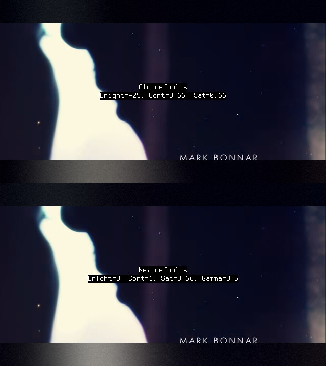

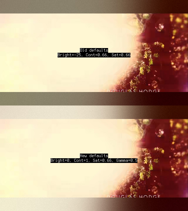

  15. Excellent! I hadn't had a chance to do any real testing of the new FastBlur myself yet.
    I'll be uploading a new version of FrostyBorders sometime soon. The defaults for the default pillarbox borders will still be much the same as they were originally, with the Frosty2=true argument to automatically increase the blurring. I'm still not sure which one I prefer. I think it depends on the content. I'm in the process of adding a gamma adjustment so any of the borders that can be adjusted with Bright, Cont and Sat can also have their gamma adjusted. It's not a game changer, but if you prefer to keep the borders darker, as I do for letterbox borders, reducing the gamma instead of brightness and contrast seems to work a little better as it darkens the borders but stll allows them to get somewhat brighter along with the picture, so they don't look as "flat". I'm still playing around with it but the following seems pretty good.
    [Attachment 85124 - Click to enlarge]
    [Attachment 85125 - Click to enlarge]
