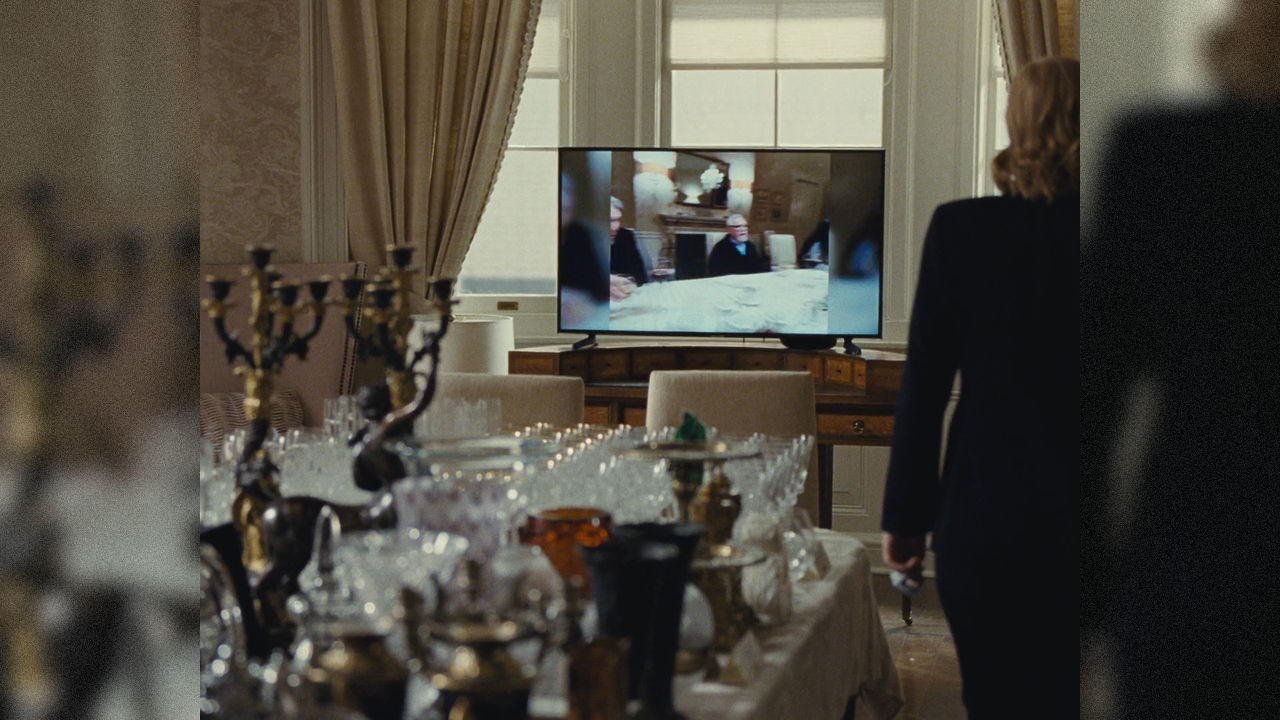

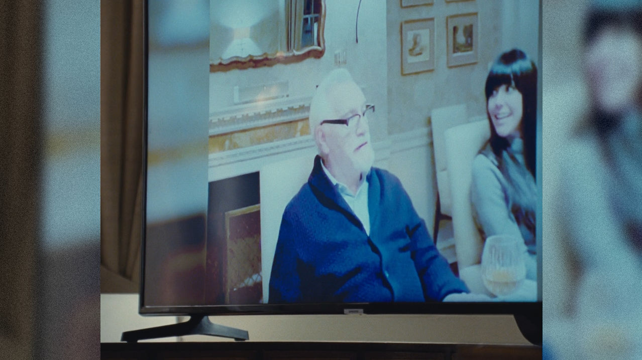

    As a side note, I was watching a video yesterday and there was a scene with a TV in the background showing a picture containing some very FrostyBorder-like borders. No doubt there's several professional programs with similar border functionality built in, but I guess it means the script's doing something right. The borders on the picture on the TV had quite a lot of grain and the picture itself was grainy, so no doubt the borders were added to the sides before grain was added to the whole picture, but it's what inspired me to add the StaticT argument to FrostyBorders. That way when adding borders to a grainy picture there's now an option to make the borders grainy too, instead of always having a static texture.
    Simulating the borders on the picture on the TV in the video
    FrostyBorders(1280,720, 200,0,-200,0, Clone=3, Blur=10, Texture=50, TSoft=1, StaticT=false)
    [Attachment 71434 - Click to enlarge]
    [Attachment 71435 - Click to enlarge]

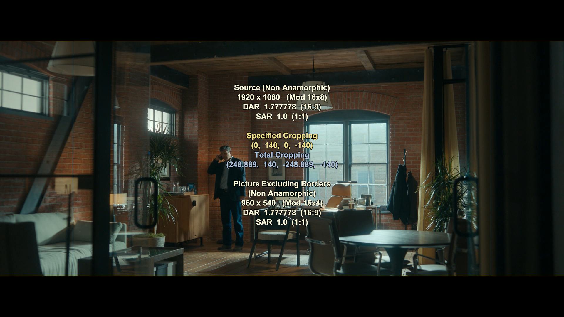

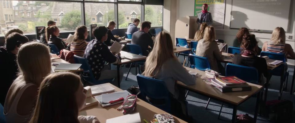

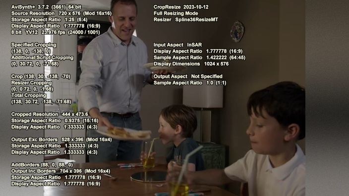

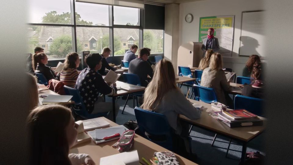

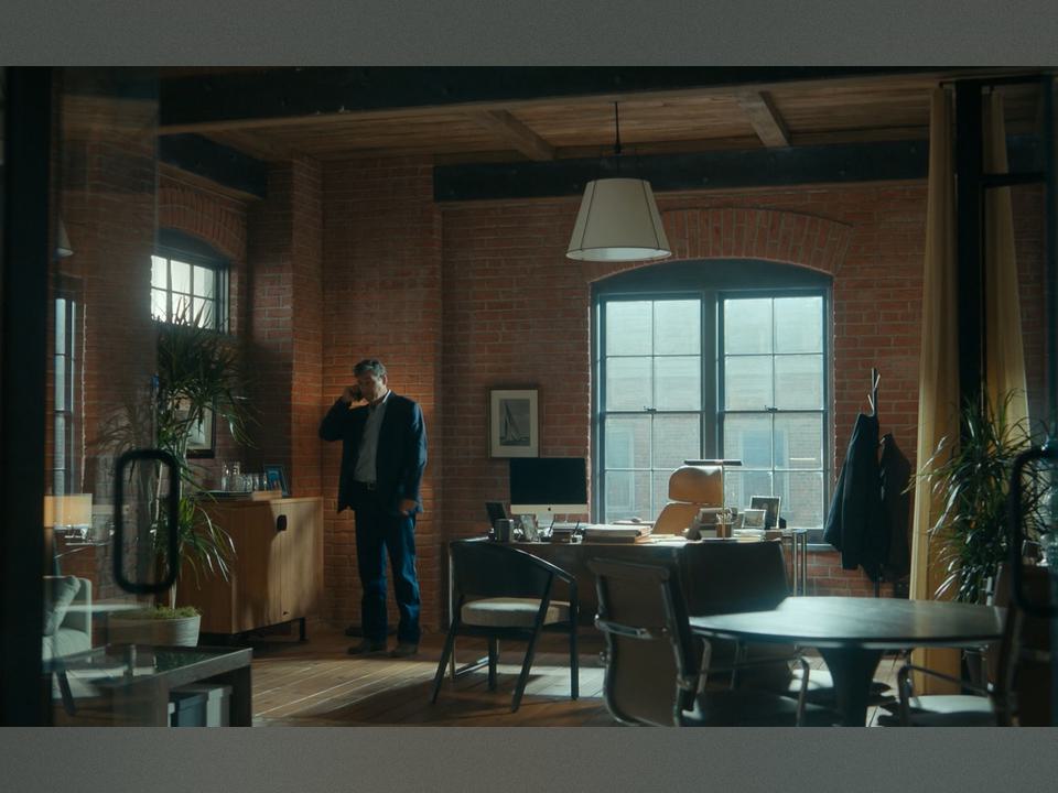

    Assuming this (fake) 2.4:1 image was the source.
    [Attachment 74201 - Click to enlarge]
    The above syntax would crop it to 2:1 before adding borders for 16:9.
    [Attachment 74202 - Click to enlarge]

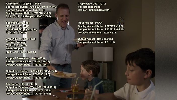

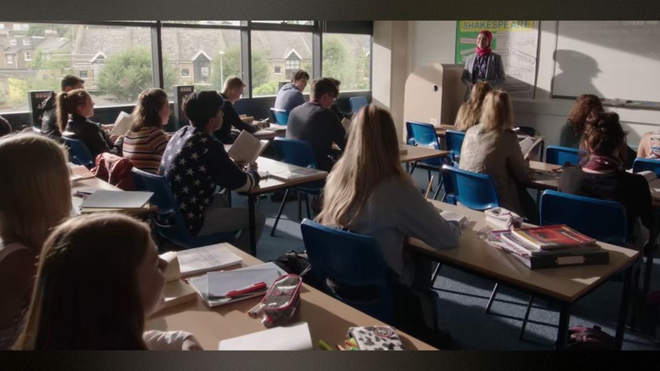

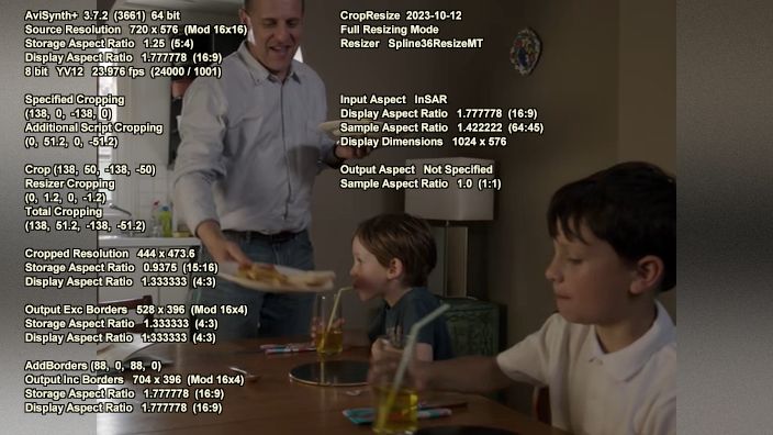

    Assuming this (fake) 4:3 image was the source.
    [Attachment 74203 - Click to enlarge]
    The above syntax would crop it to 1.5 before adding borders for 16:9.
    TCRatio=0.3 means only 30% of the cropping comes from the top.
    [Attachment 74204 - Click to enlarge]
    Without TCRatio, or the default of TCRatio=0.5, the top and bottom cropping would be the same.
    So TCRatio=0.3 effectively moves the picture down a bit when the height is cropped.
    I find it's better to crop less from the top than the bottom, as for 4:3 video the important stuff is generally
    located slightly above the middle of the frame (admittedly this fake 4:3 video isn't a good example of that).

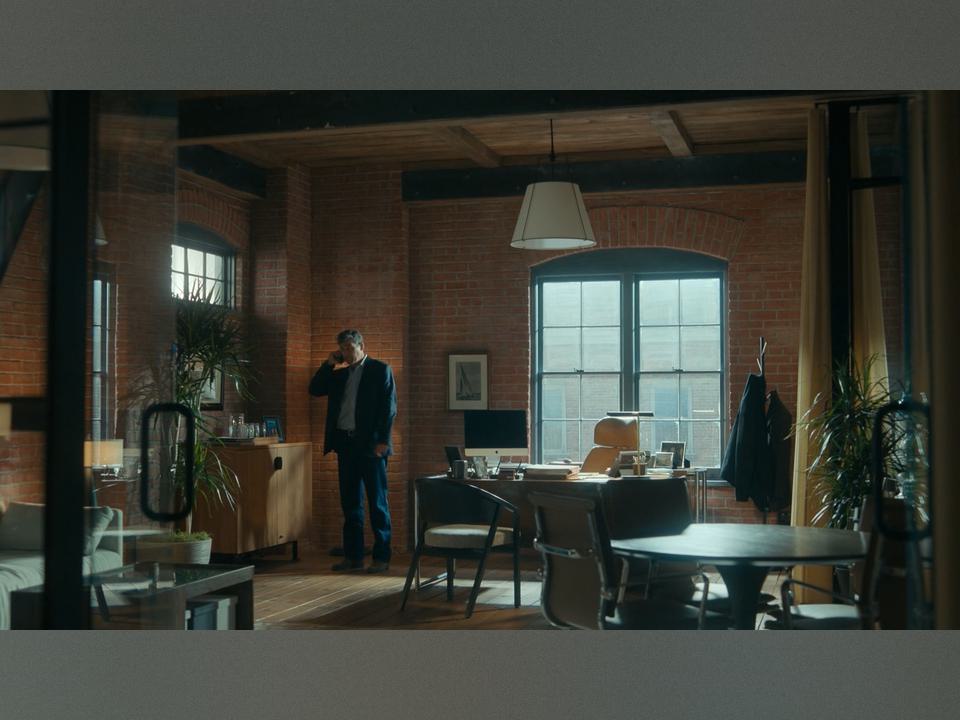

    TCRatio=0.5
    [Attachment 74205 - Click to enlarge]
    Of course you can change the syntax to adjust the way video is cropped and borders added to whatever you prefer.
    You can also use the CropDAR argument to crop the picture to a particular aspect ratio without the function adding borders by specifying zero for either the width or the height.
    FrostyBorders(0,540, 2,0,-2,-0, CropDAR=1.5, TCRatio=0.3)
    [Attachment 74206 - Click to enlarge]
    Edit: re-uploaded the screenshots in the correct order.

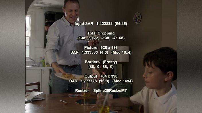

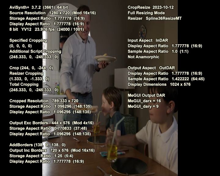

  20. It could be. Using the above syntax CropDAR would crop a picture with a DAR less than 4:3 to 4:3, but the source DAR now takes the cropping into account, so if your specified cropping results in the picture being cropped to 4:3, CropDAR=4.0/3.0 won't crop anything, so TCRatio can't adjust the cropping ratio.
    Here's an example. I've resized the video to 720x576 while cropping the picture to an aspect ratio of 1.1 and adding borders to the sides for an output DAR of 16:9 and a SAR of 64:45. As you can see there's 138 pixels of black each side. It's the source for the example below. This is one of those instances where cropping the black makes a huge difference to the DAR and why I suggested the new syntax, because the VideoDAR calculation takes the specified cropping into account.
    CropResize(720,576, CropDAR=1.1, InDAR=16.0/9.0, OutDAR=16.0/9.0, Info=true)
    [Attachment 74402 - Click to enlarge]
    Applying the syntax using a SAR of 64:45 and 138 pixels of cropping each side (I also increased the resizing to 704x396 to make the text easier to read). I'm using CropResize at the end instead of FrostyBorders.
    clip = last
    W = width(clip)
    H = height(clip)
    # If the source is anamorphic the correct pixel/sample aspect ratio must
    # be specified instead of 1.0. For example, 64.0/45.0 for a PAL 16:9 DVD.
    # The SAR must be float (not integer).
    SAR = 64.0/45.0
    # Cropping
    # CR and CB must be negative (or zero)
    CL = 138
    CT = 0
    CR = -138
    CB = 0
    VideoDAR = float(W - CL + CR) / float(H - CT + CB) * SAR
    # 444 / 576 * 64 / 45 = 1.096,
    # as close to CropDAR=1.1 as the mod4 resizing of the original video allowed
    CropDAR = \
    (VideoDAR > 2.0) ? 2.0 : (VideoDAR > 1.4) ? 0 : (VideoDAR > (4.0 / 3.0)) ? 1.4 : 4.0 / 3.0
    return (1.75 <= VideoDAR <= 1.8) && (SAR == 1.0) ? clip : \
    (1.75 <= VideoDAR <= 1.8) ? \
    FrostyBorders(0,396, CL,CT,CR,CB, InSAR=SAR, CropDAR=CropDAR, TCRatio=0.3) : \
    CropResize(704,396, CL,CT,CR,CB, InSAR=SAR, CropDAR=CropDAR, TCRatio=0.3, Frosty=true, Info=true)
    The "additional script cropping" shows 30.72 pixels cropped from the top and 71.68 from the bottom (using a TCRatio of 0.3) because a total of 102.4 pixels of height has to be cropped to crop the 1.1 image to 4:3.

    If TCRatio was the default of 0.5:
    CropResize(704,396, CL,CT,CR,CB, InSAR=SAR, CropDAR=CropDAR, TCRatio=0.5, Frosty=true, Info=true)
    [Attachment 74405 - Click to enlarge]
    So yes, if the specified cropping also included 102 pixels of bottom cropping, or even a total height cropping of 102 pixels split between top and bottom, there's no substantial top and bottom "additional script cropping" for TCRatio to work with.
    CL = 138
    CT = 0
    CR = -138
    CB = -102
    [Attachment 74407 - Click to enlarge]
    FrostyBorders was intended as a more "set and forget" function so Info=true isn't as informative, but it should show the same total cropping and borders for an identical source.
    CL = 138
    CT = 0
    CR = -138
    CB = 0
    FrostyBorders(704,396, CL,CT,CR,CB, InSAR=SAR, CropDAR=CropDAR, TCRatio=0.3, Info=true)
    (this should be the same as the first CropResize example with frosty borders above)
    [Attachment 74410 - Click to enlarge]

    Also, temporarily substituting CropResize for FrostyBorders might make it easier to understand what's happening, because you can enable a cropping preview to errrrr...... preview the cropping. Yellow lines in the preview show any specified cropping. Blue lines show any additional cropping applied by the script.
    FrostyB(Bright=50) # Add this line to configure the frosty borders.
    return (VideoDAR == (4.0/3.0)) && (SAR == 1.0) ? clip : \
    CropResize(640,480, CL,CT,CR,CB, InSAR=SAR, CropDAR=CropDAR, TCRatio=0.3, Frosty=true, CPreview=1)
    Here's an example of a preview with a CropDAR being applied after the specified cropping.
    The source is 16:9. The specified cropping crops the letterbox borders for a 2:1 DAR, then CropDAR crops the sides to make it 16:9 again.
    FrostyB(Bright=50)
    CropResize(960,720, 0,140,0,-140, InSAR=1.0, CropDAR=16.0/9.0, TCRatio=0.3, Frosty=true, CPreview=1)
    [Attachment 75553 - Click to enlarge]
    So when the preview is disabled, on a 4:3 display you'd see this:
    FrostyB(Bright=50)
    CropResize(960,720, 0,140,0,-140, InSAR=1.0, CropDAR=16.0/9.0, TCRatio=0.3, Frosty=true)
    [Attachment 75550 - Click to enlarge]
    To change the size of the borders, instead of messing around with the cropping, from there all you need to do is change the CropDAR.
    FrostyB(Bright=50)
    CropResize(960,720, 0,140,0,-140, InSAR=1.0, CropDAR=1.6, TCRatio=0.3, Frosty=true)
    [Attachment 75551 - Click to enlarge]
    Anyway, the new script gives you a bit more control, so hopefully that'll help. You can still use it with a 16:9 display if you chane the last couple of lines so the output is 16:9.
