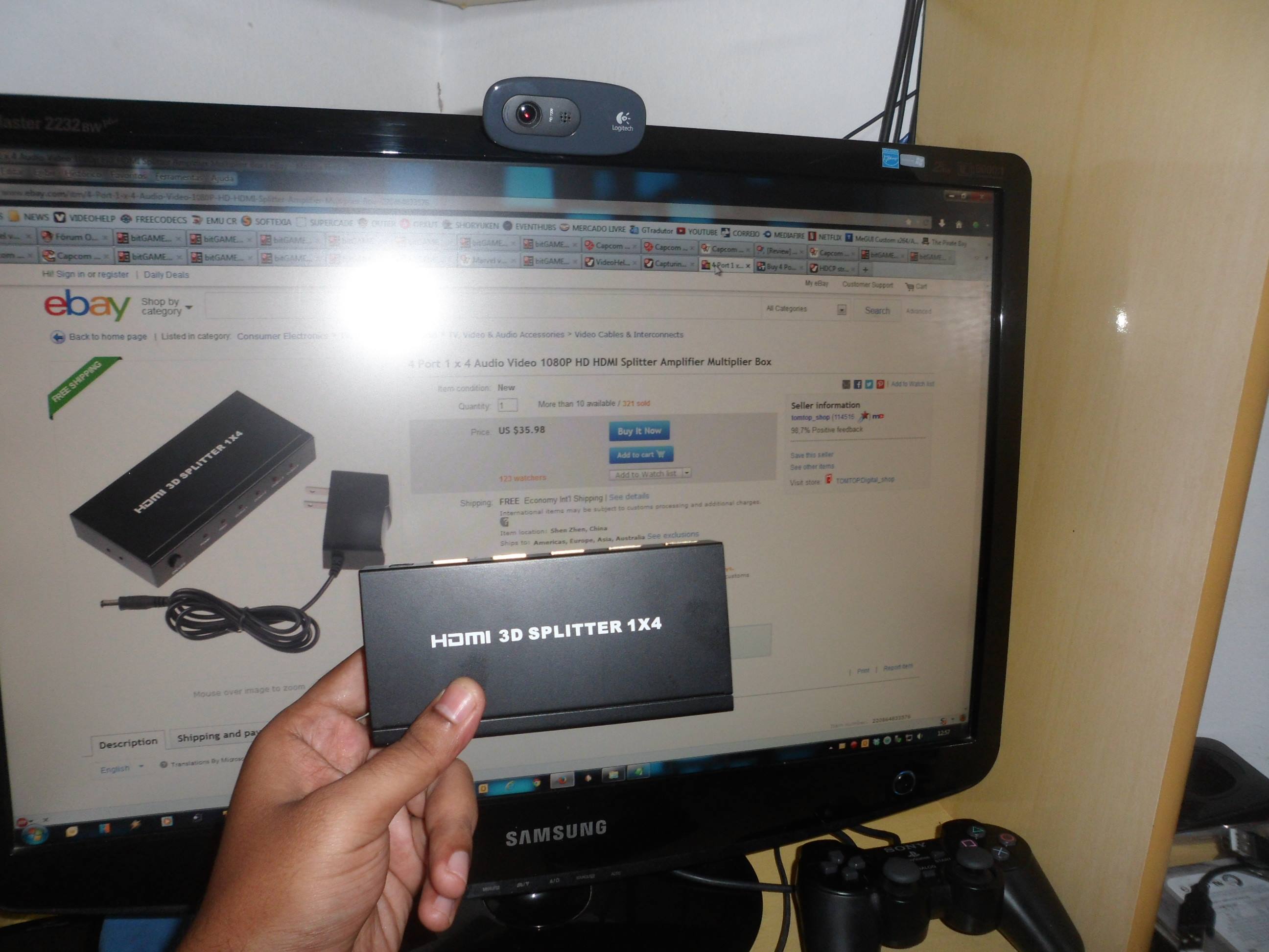

  12. Lone soldier Cauptain's Avatar
    Jan 2006
    Brazil
    YEEEEEEEES!!!
    Claudio
  13. Wonderful!!
