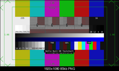

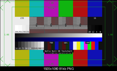

  11. Yet you're willing to trust your data transfers over twisted pair ethernet cable all day long.
    What differences did you think you saw using different HDMI cables? Since the data that is transmitted over the wire is the ones and zeros of uncomrpessed video the only errors you can get are sparkles. You can't get the ills of analog transmission: color shifts, level shifts, ghosting, blurring, halos, etc. Digital errors are when a one turns into a zero or a zero turns into a one. Say you have 8 consecutive zeros:
    0000000
    A single bit error in transmitting that byte can result in:
    00000001
    00000010
    00000100
    00001000
    00010000
    00100000
    01000000
    10000000
    Say that byte was the Y value of a pixel. That means the pixel changed from intensity 0 to intensity 1, 2, 4, 8, 16, 32, 64, or 128. That would be visible on the screen as a bright spot for the duration of a frame. Of course, exactly the opposite could happen, a one in the middle of 11111111 could change to a zero. The result would be a darkening of the pixel, a dark sparkle for the duration of that frame. And in the middle of a U or V byte you would get a color change. In the middle of an R, G, or B byte you would get a color/brigtness change. Any single bit error will result in 1, 2, 4, 8, 16, 32, 64, or 128 being added or subtracted from the original value. You don't get subtle 1 and 2 changes with a slightly bad cable, 1-8 changes with a slightly worse cable, etc. The errors are equally distributed over all 8 possibilities. When an HDMI cable is marginal you get sparkles. Only a little bit worse and you get total failure of the handshake between the source and sink, no picture at all.
    Here's an example. The a 1920x1080 RGB version of the Belle Nuit test partern, without error, and with 1000 single bit errors:
    If you download those images and run a binary file comparison (after decompression) you'll see there are exactly 1000 differences. This represents a horrendous error rate. I doubt many HDMI connections would survive error rates this high.
    Of course, single bit errors aren't the only possible errors. You can get multiple errors in a single byte (or pixel) or long strings of errors. Even so, what you get is severely messed up pixels, not subtle color changes, blurring, ghosting, etc. CNET (I think) had some good example images a few years ago. I can't find them now.
    I found the CNET article: http://news.cnet.com/8301-17938_105-20056502-1/why-all-hdmi-cables-are-the-same/
