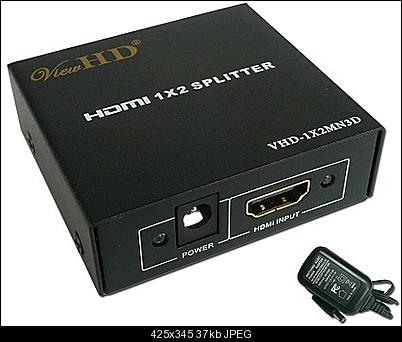

    Can't remember if this one was brought up before. Looks like there is also a 1x2 HDMI splitter that strips HDCP.
    https://forum.speeddemosarchive.com/post/how_to_bypass_hdcp_for_use_with_blackmagic_in...d_here_29.html
    http://www.amazon.com/gp/product/B004F9LVXC/ ($24)
    http://www.amazon.co.uk/ViewHD-Port-Powered-Splitter-1080P/dp/B004F9LVXC (16GBP)
    The initial post there was kinda iffy since he was already using the AVerTV driver trick, but others confirmed it later in the thread.

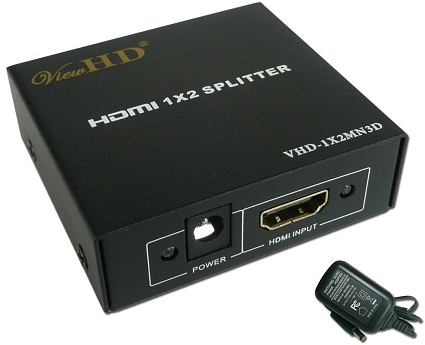

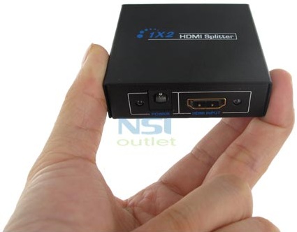

  26. Formerly 'vaporeon800' Brad's Avatar
    Apr 2001
    Vancouver, Canada
    Originally Posted by quaditz View Post
    I bought a similar splitter (its from ligawo, but that's just the German Import Brand), but I didn't know that it rips the HDCP away.
    It probably doesn't. I have one with a casing that looks identical (different silk screening), but I guess the innards differ from the ViewHD 1x2 since mine came out before the 3D thing.
ID:	17008Click image for larger version
