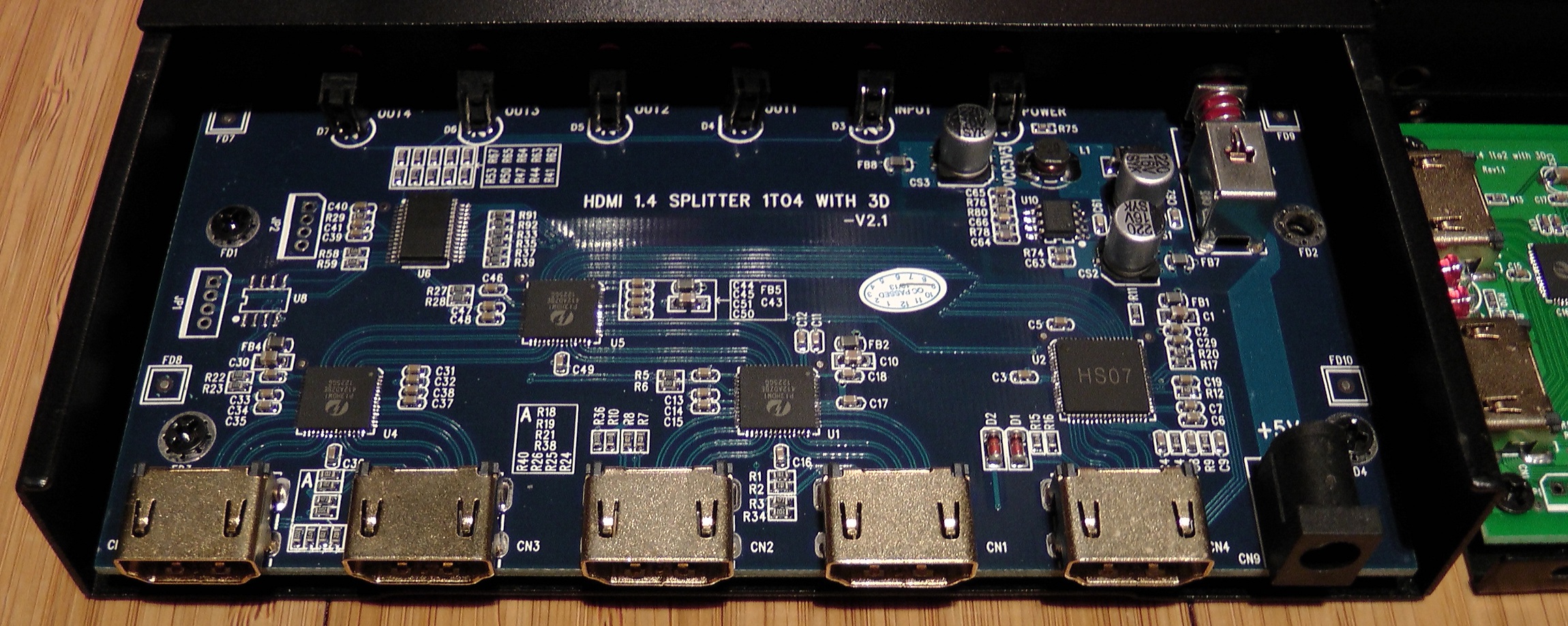

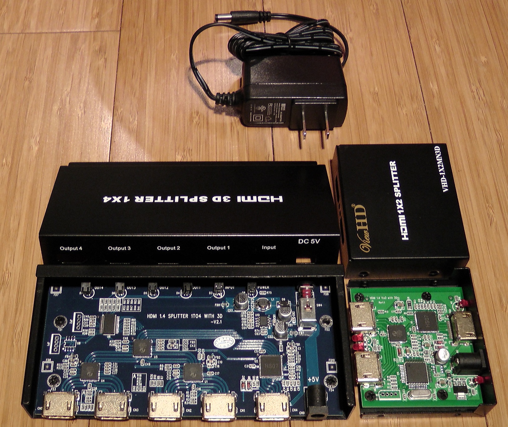

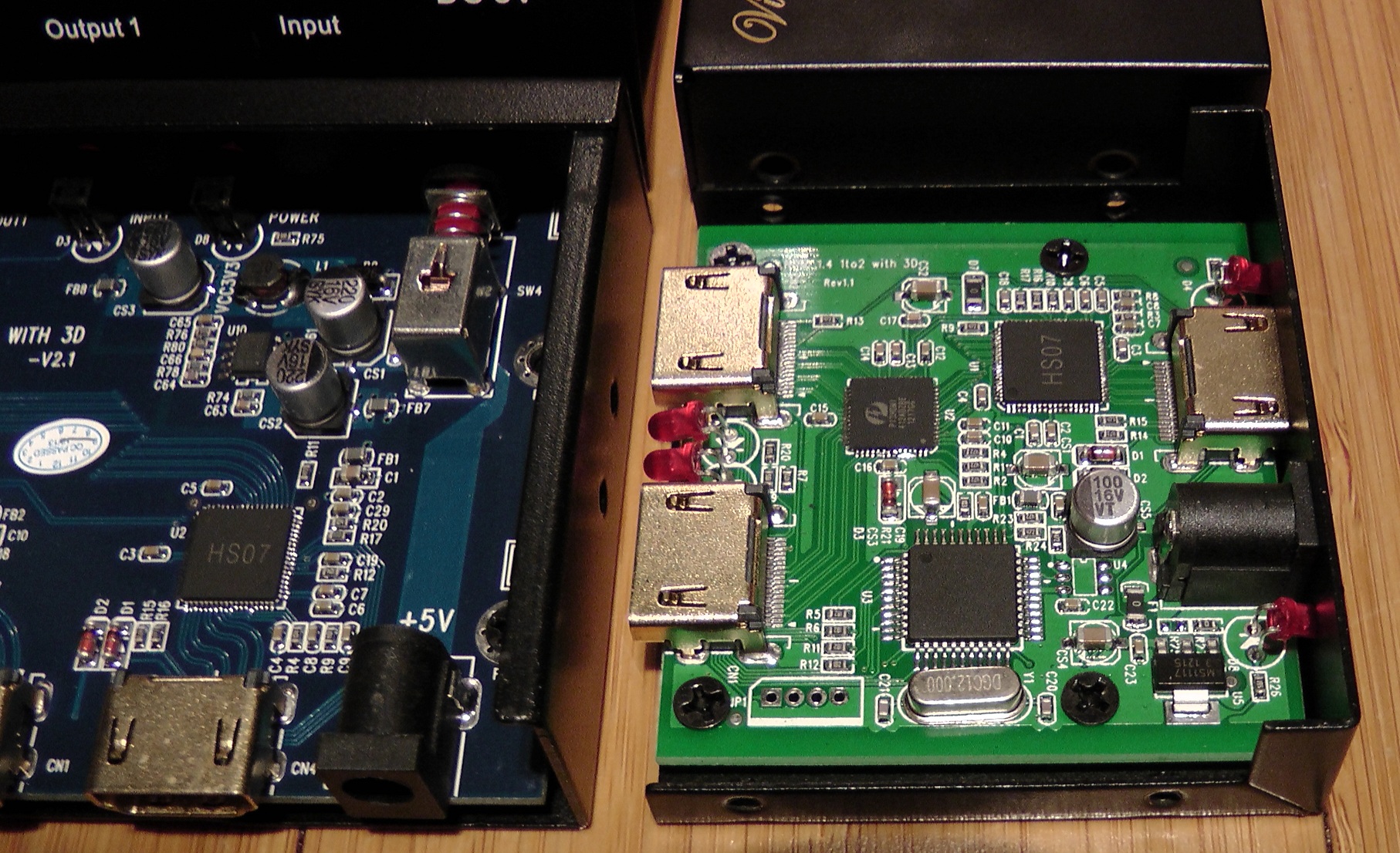

  14. Formerly 'vaporeon800' Brad's Avatar
    Apr 2001
    Vancouver, Canada
    Originally Posted by vaporeon800 View Post
    This one is the holy grail of HDCP strippers for me, since I consider a powered splitter to be a requirement in any HDMI capture setup anyway and I want the smallest one possible.
    Purchased from the above Amazon.com link on 4/16 for $25.90 with shipping to Canada. Shipped from 95763 on 4/17 and it arrived 5/08 (the tracking claims that it took 7 business days to get from LA to customs). It works as expected.
    The photos are accurate (unlike the CVID, they did bother to add their logo onto it). Though the power adapter I happened to get is better than that (horizontally-oriented so it doesn't cover another outlet). The LED colors are all red. While the listing says "HDMI 1.3 + HDCP1.0/1.1/1.2", the circuit board says "HDMI 1.4 1to2 with 3D".
    I no longer have a use for the 1x4 stripping splitter, so if anyone wants to buy it from me, send me a PM.
Name:	HDCP strippers - both.JPG
ID:	17732 Click image for larger version
Name:	HDCP strippers - 1x4.JPG
ID:	17731 Click image for larger version
Name:	HDCP strippers - 1x2.JPG
    The input in both splitters is a chip labelled HS07. The outputs are Pericom Semiconductor P13HDMI-412ADZBE. They both also have one unlabelled chip, with differing physical shape.
