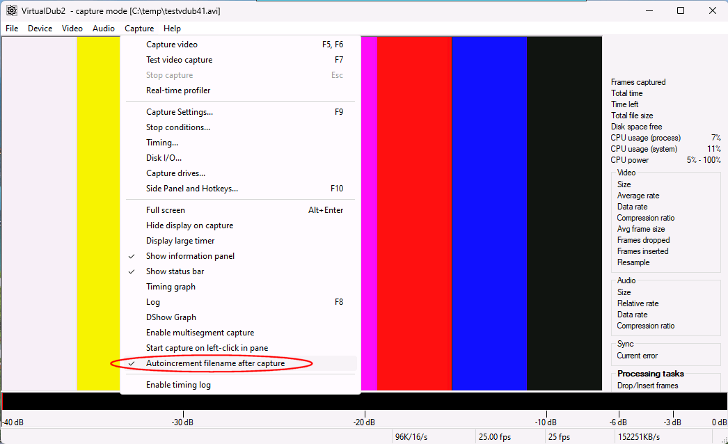

Yes, it is all too easy to lose your previous/precious captured file. I know from experience.
Always enable the "Autoincrement filename" option in VirtualDub to prevent these accidents.
[Attachment 93352 - Click to enlarge] -
