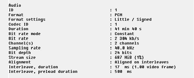

  11. Capturing Memories dellsam34's Avatar
    Jan 2016
    Audio for video is 48KHz, Not sure if Vdub can handle more than that.
    [Attachment 67576 - Click to enlarge]
